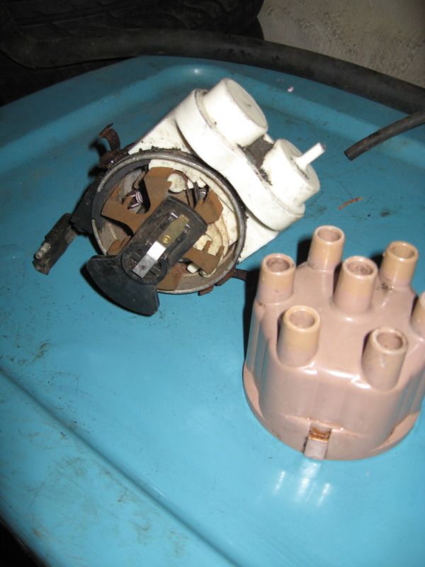

Anyone know what Jeep this distributor is from? Anyone think they might need it? I can let it go cheap + ship. Thanks

That's a Prestolite distributor used between 75-77. It's not much good without the ignition module specific to that distributor, and not much better even if you do have it.
I gotcha, I may have the module, I gotta check again. How much do you think its worth with the module? thx

Not much. Most people who have them want them gone. The aka for Prestolite is Prestocrap.
Haha, yea maybe that's why the guy just gave it to me.
