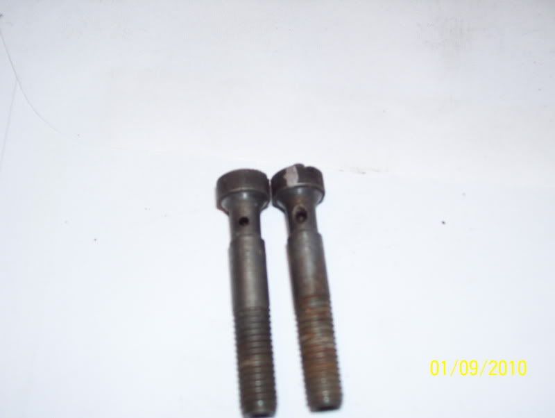

OK, this is interesting...
Started getting back into this mess this morning and noticed that the sides of the screw heads are indeed marked differently - one w a line, one without (of course, me being the genious that I am has already gotten them mixed up, so I dont remember which started where- shouldn't matter, really).
I also noticed that the holes in the sides are not exactly different, but have different 'end conditions'. On one side of the screw the hole is just a regular thru hole. The other side has an oblong 'countersink' or chamfer around the hole.
See pics (I have marked the screws indicating the 'countersunk' end of the hole, in case it turns out it makes a difference.
Now the question is, is that chamfer there to let fuel in easier, or out more dispersed?
And again, I have found no documentation regarding this either.
Thoughts???
