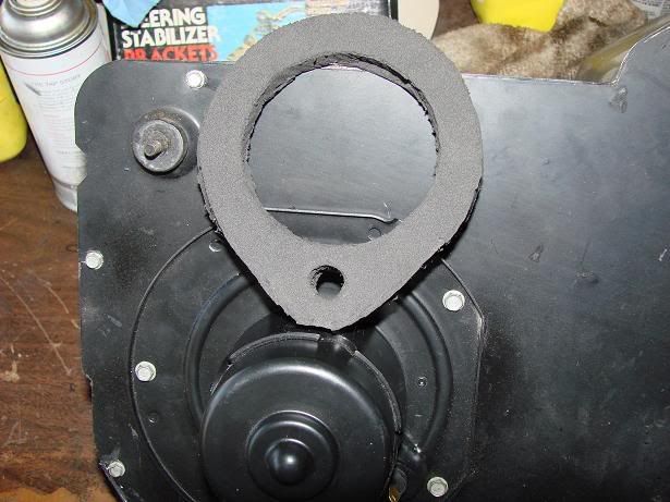

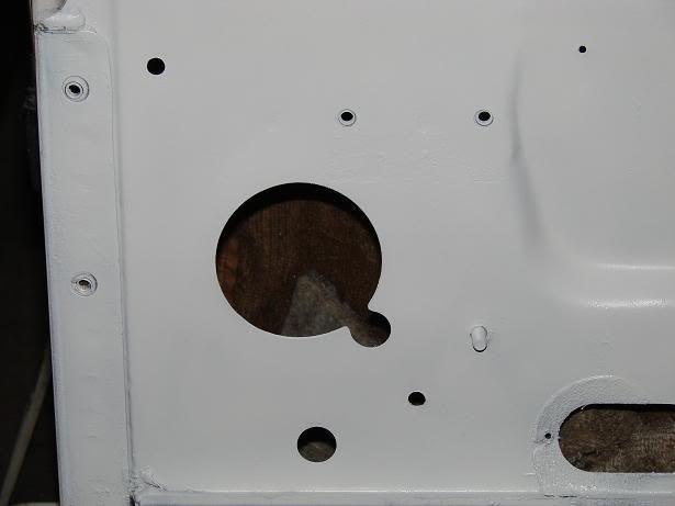

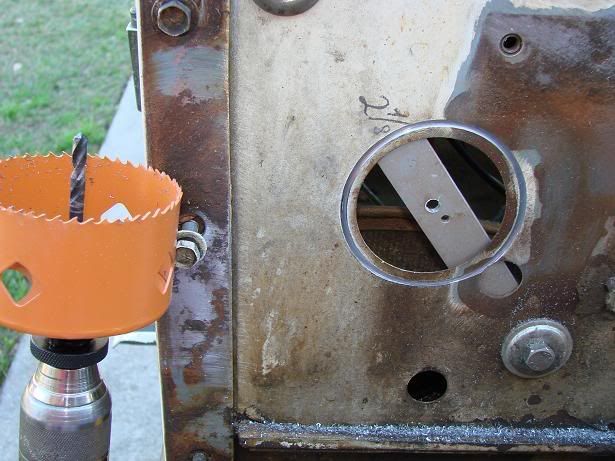

I have the heater box out and replaced a leaking core tight fit getting it out with factory air . While I ahve it out I want to do the chevy updated blower motor. Do I understand that I will need to cut the fire wall prior to reinstalling the heater box? If so what area do I need to expand? Would it be best to trace around the fan as a template then cut that out?
Sorry to beat a dead horse but I looked around on search for the photos (seen them before) and could not find them.

you'll have to make the hole where the stock fan goes through the firewall a little bit bigger

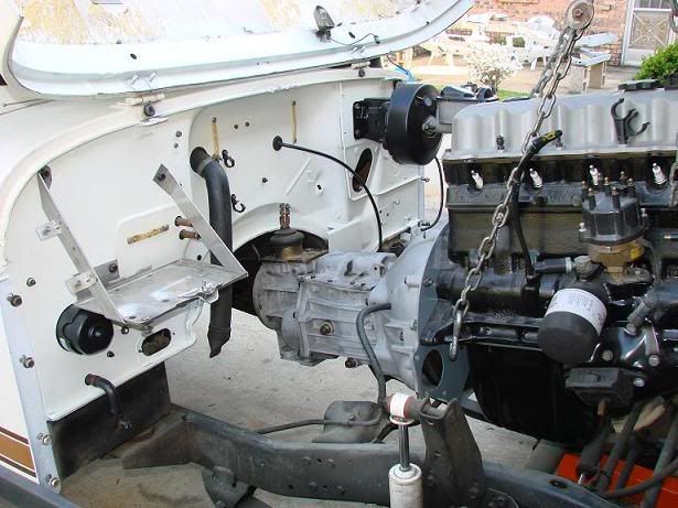

I also have a question. It seems as if the new fan motor will have to intrude into the battery holder base plate. It is a fabbed job but it has a lower mounting strut brace which reaches the same height.

no, its tight, but goes under it (or at least mine did) with about 1/8 inch or so between the motor and the tray bottom.
