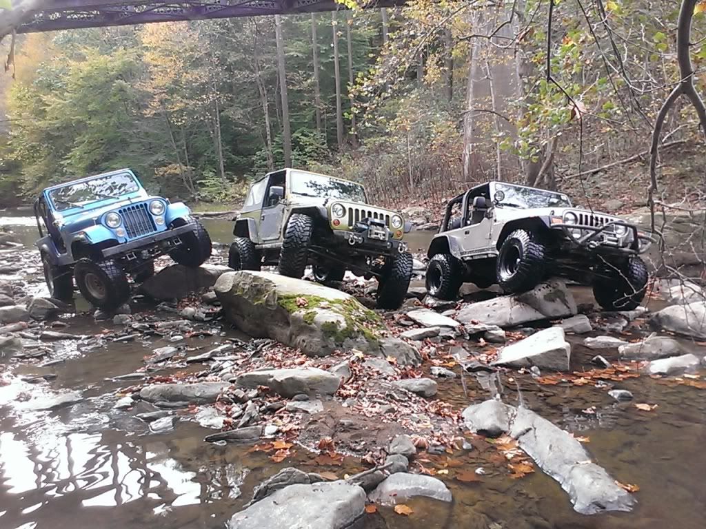

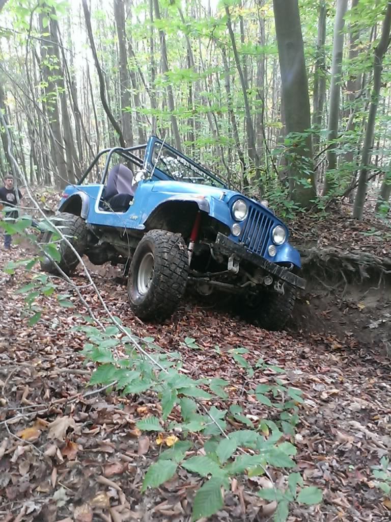

Finally got a chance to wheel it today. I pushed it pretty hard through some things that were the hardest on the quadratrac chain. Glad to report, everything went fine. It's nice to be able to use the skinney pedal once in awhile as needed.
Being able to engage the front at will made a difference having a front locker. It was nice not having to fight the steering all day long. A little pressure on the lever, and a burp of the throttle was all it took to slide it in and out.

Glad it's working good. Our group went wheeling today, I had to work. So it's good to see your pics!
