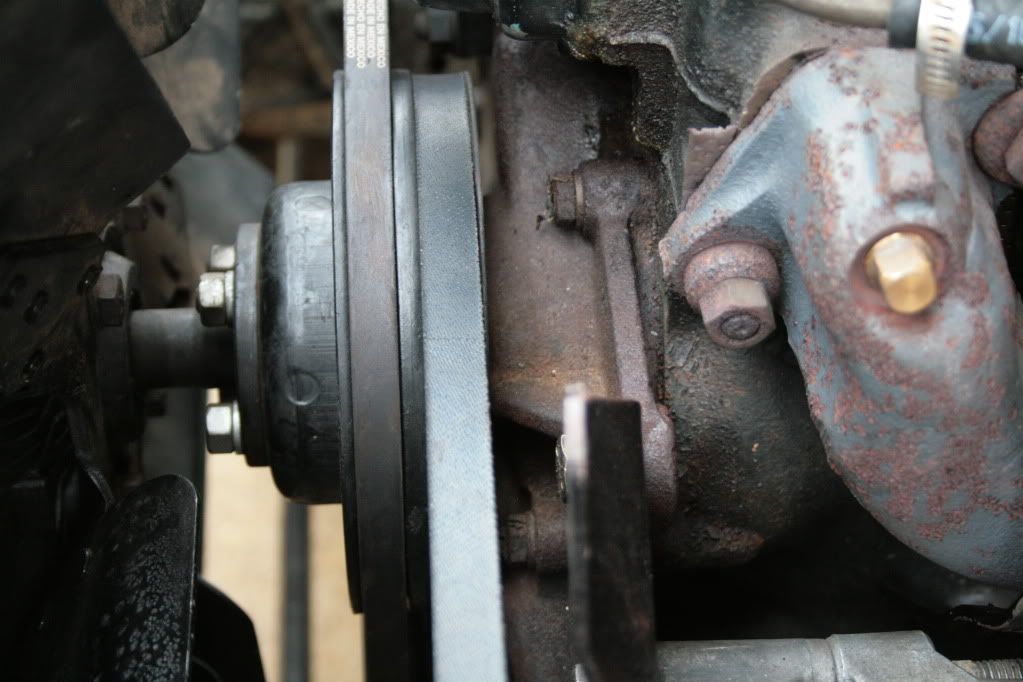

Plugs I used were NTP brass plugs from Lowes or Home Depot, fairly cheap. Buy a few extras incase one works itself loose and blows out. that will scare the h*ll out of you when driving.
[IMG][/IMG]
