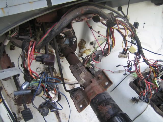

Dash out. No rats went running, but there was evidence of a nest.
All wires were properly labeled and photographed.

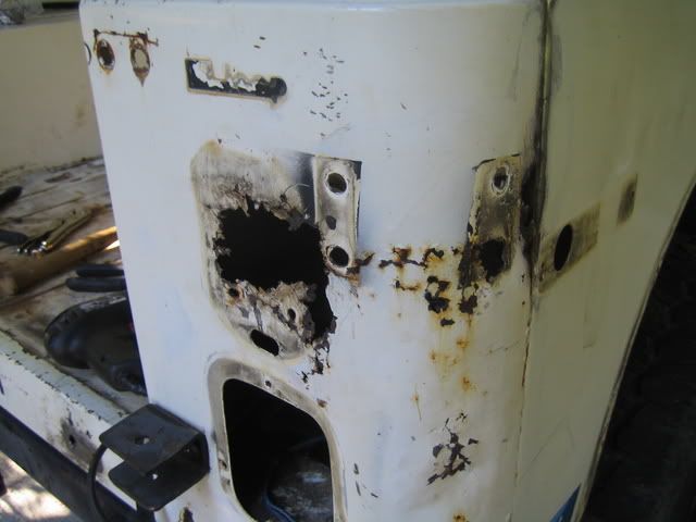

Rear corner not bad at first look. But I later found it to be rusted out under the light.
Hmmm... where to go from here?

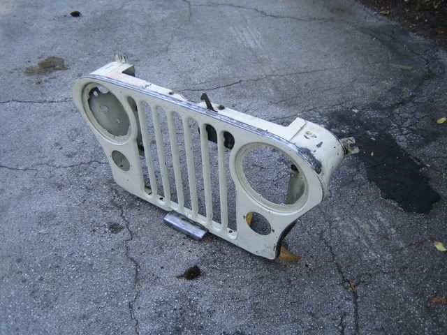

There are a row of bolts on the inside of the fender to the firewall. Then a couple underneath that bolt through to the grill. You can get new fenders online at verious places. Usually made by a company called Omix-Ada. Not same quality as OEM, but come rustless!

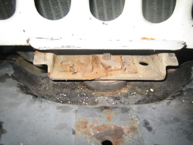

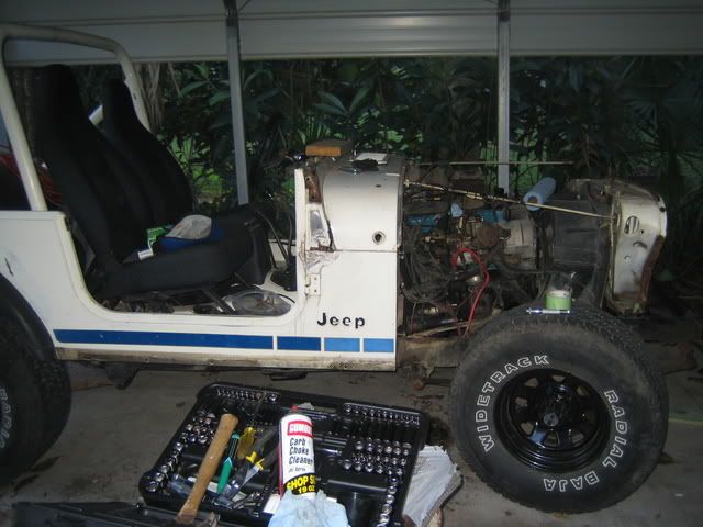

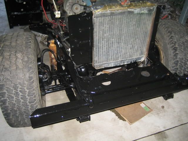

Grill bolt was stripped inside. Just spun around. So I lifted the little plate on top of it and got in there.

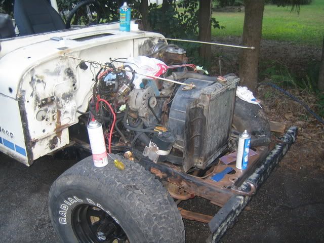

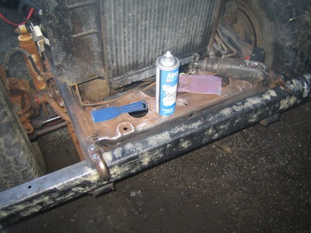

Starting to clean front bumper and parts of frame with metal wheel and paint stripper. At this stage, I had only planned on cleaning up what was seen. Leave the body on, get new fenders and paint her up.

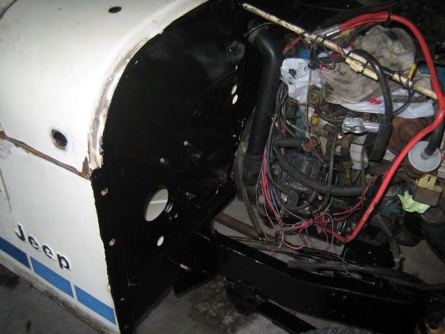

Cleaned and POR15'd. Nice. Better do it all then, If I am going to do it right.
Didnt use rust killer or metal etcher. Just painted th stuff over sanded surface rust. Should I regret this? Will it be OK or should I strip it down?

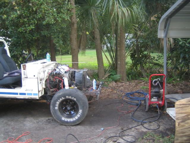

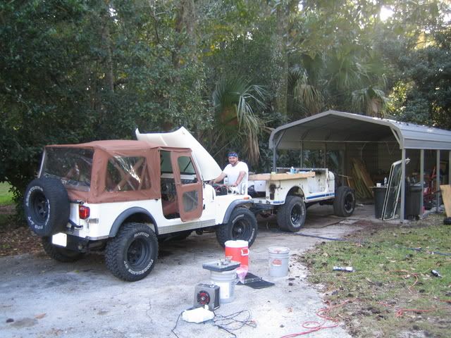

At this point I can still push it in and out of the overhang. Brother dropped off his pressure washer.
POR15'd the Firewall. tough to do with everything attached, like wires and brake pannels. Looks good. But I think I will strip it off and do it satin.

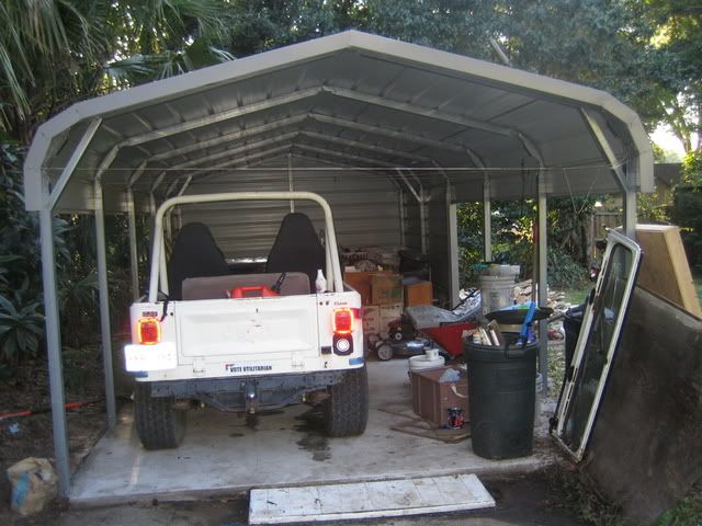

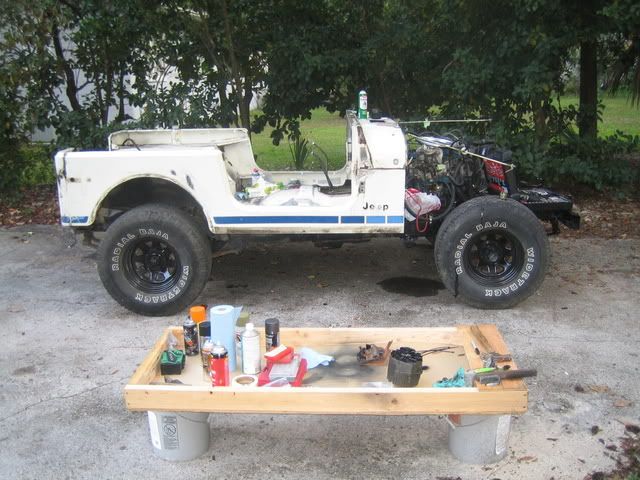

THe work area. I should get a nice shot of the underside of that windshield. It acts as a paint tester at the moment.

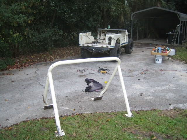

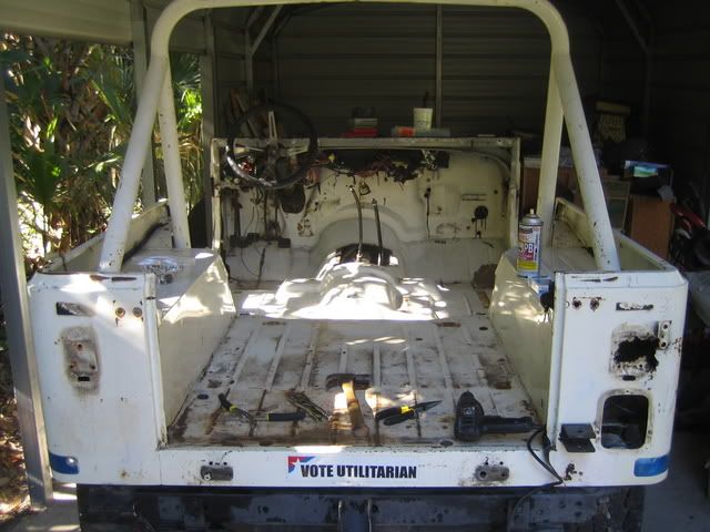

ROLL BAR OUT!!!! Screw torx. Worst idea ever. I wound up using a grinder and grinding down the bolts. Took a few hours. Tried the PB Blaster, the torch, the BFH. Time to grind.

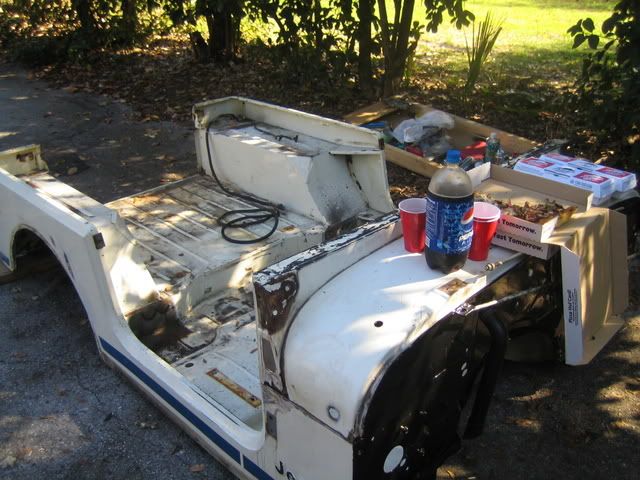

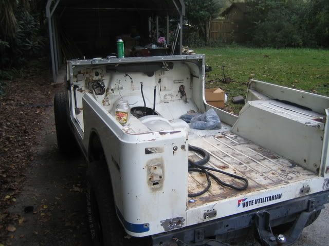

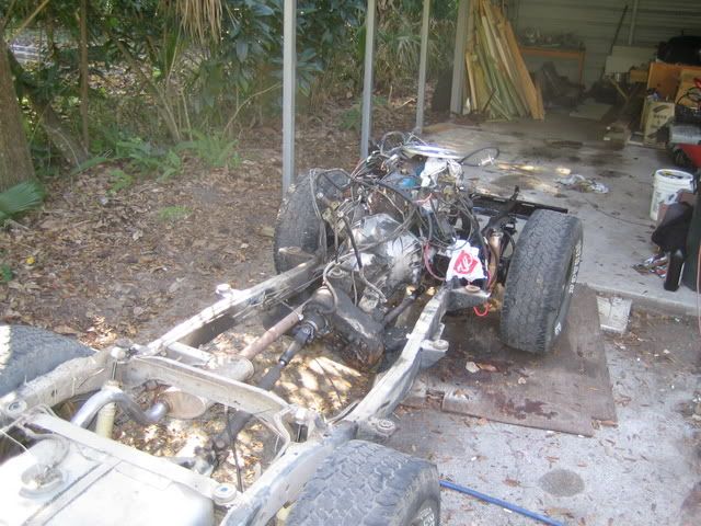

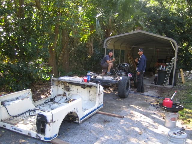

Finally, Tub is off. two helpers cost my 2 pizzas.
If anyone has yet to lift a Tub, it can be done with 3 people, every thing removed from it. Inc. Windshield. Suprisingly light.
Frame shot. Suprised to see a shiny new gas tank from PO. Odd how the gas guage was never working.

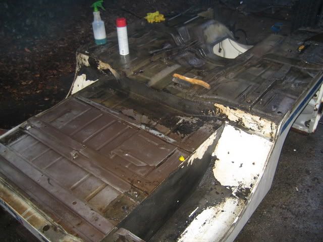

Cleaning bottom of tub.
Here is the thread on what works...
http://www.jeepforum.com/forum/f8/cleaning-bottom-tub-what-did-you-use-493994/
