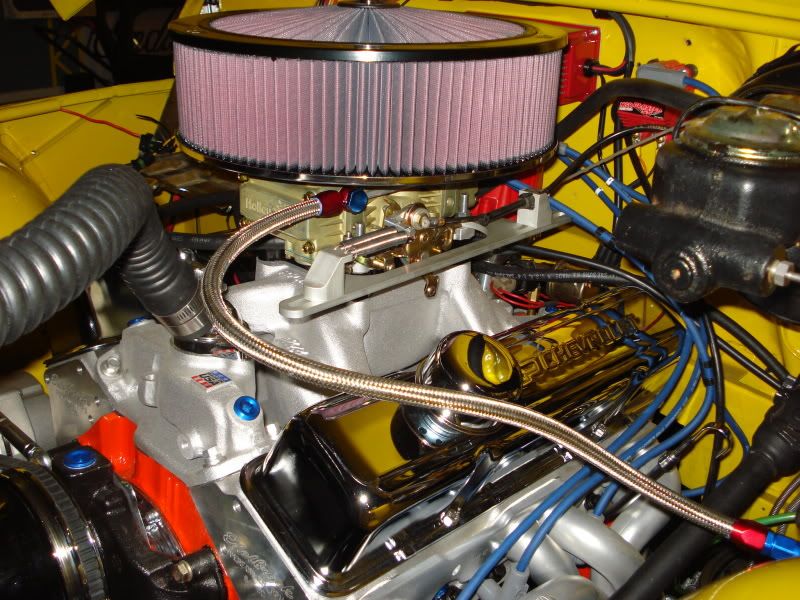

Thanks guys, the Jeep is running great, I have not had much time to drive it and only have 100 miles on it since finishing the 350.
Had to finish up the phase 2 of the cage and get the seats mounted.
Really impressed with the combination on this motor, the Edelbrock heads really bring this thing to life and the torque off this cam is brutal. First gear with the 6.32:1 I can DC this thing and bounce the front tires in the air. Makes me nervous about putting it back into the kids hands.
MSD is sending me a new 6A to replace the one that lasted 20 minutes. Not sure I even want to run it, had no idea the piece of chit was so sensitive. If I can return it to Summit, it's outta here.
Here's the new specs:
69 Vette 0010 cast 4 bolt main SBC 350 .060 over 361ci
Speed Pro Hypereutectic flat top pistons
COMP Cams Xtreme Energy 4x4 Hydraulic flat tappet cam, Grind: CS X4 262H-11, 262/270, Lift .462/.480
Edelbrock 60999 Performer RPM heads, 64cc chambers, angle plugs, 185cc intake runners
Edelbrock 7501 Performer RPM Air Gap dual plane intake
Holley Truck Avenger carburetor, 670 cfm
2 piece balanced steal crankshaft 3.480 stroke
Stock 5.700 connecting rods
Full roller 1.5 rockers
Gear drives
MSD HEI dizzy & MSD Blaster coil
Melling High-Volume Oil Pump
Milodon High-Volume water pump - short
Headman Headers, Elite, Shorties, Thermal Coated
Flowmaster 2.25 mufflers, 40 Series
Magnaflow 2.25 Stainless CATs
Four core copper radiator, w 160* T-stat
Ford Taurus electric cooling fan 4000 CFM
T-18a 6.32:1 / D300 / Scout II D-44 3.73 rear
I'll try and get some pics shot soon, Camera no longer records sound in movie mode, so I'll have to be buying another one soon.
Thanks again for following along.

Remember that a thermostat is only controlling the minimum temperature. From that point on either your cooling system can keep up or it can't. Doesn't matter the engine size or if it is bored over or not.
Most engines are designed to run around the factory spec 180-195 degrees. Fuel atomization, spark advance and oil viscosity are all factors related to a normal operating base engine temp. New cars can adjust for these factors on the fly, obviously yours (ours) doesn't.
I guess my question would be, if the engineers who built it wanted ~195* operating temp what makes running it 30* cooler better?
Granted if you have a vehicle that is prone to running hot then lowering the thermostat will get the coolant flowing through the radiator sooner. It sounds like that will not be a problem for you though. I would run a 180* if I had your set up.
Mike
Coiz is offline
post #75 of 103 Old 06-05-2010, 08:31 AM Thread Starter
Fatman
Fatman's Avatar
2008 CJ7
Location: Raleigh
Posts: 2,444
Lets talk about coolant temps, not motor temps.
Motor temps, like you said are controlled by wear, spk adv, oil, and fuel, design of engine compartment, etc.
The thing to remember is that the T stat has nothing to do with how cool you can keep the motor, is can only have an effect on the coolant temps (effect, not control)
You need to give the coolant that opportunity to run in a range. It starts by allowing the flow of coolant through the radiator, in my case that process starts at 160*. You can't have operating temps of 180 - 185* in a motor if your opening up the T stat at 180 and especially not 195*
You guys that think its OK to run an overbore in the 220- 230* range are asking for trouble. If you're Lucky you'll just blow a H gasket, if not you'll distort the cylinder walls and then be Lucky if you see 10,000 miles on your build.
This isn't my first high HP motor, in the 70's & 80's I was big into Chevy iron and have done my share of 327's & 350 mouse motors, never had a single issue with any. Keys I stick by are proper cam break in and keeping things cool. Back then I didn't have electric fans to stick in the Camaro's and Chevelle's I had so it was a chore to move air.
I like the predictability of a copper radiator and an electronically controlled fan.
This Taurus fan MOVES air.
So, where are we at here ?
My fan kicks on at 160, my T stat opens at 160, and with over 400HP on this over bore, it sees that 160* very quickly.
90* day yesterday and I was in construction crawl traffic for about 20 min - Consistent temps @ 180 - 185*
Running down the highway @ 65 - 70 - Consistent temps @ 180 - 185*
Driving around town, stop and go - temps @ 180 - 185*
This means the system as a whole is working well together.
it also means the cyl walls are close to 198 - 213* this motor will live a long time under those conditions.
