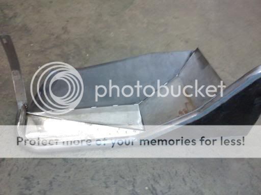

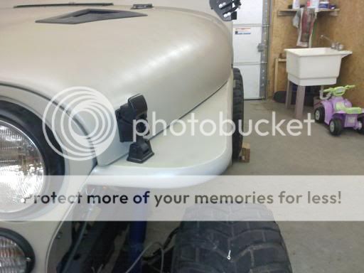

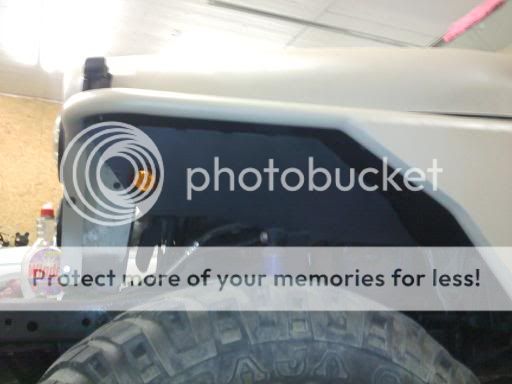

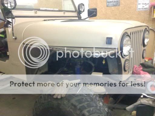

heres some pics of the fenders

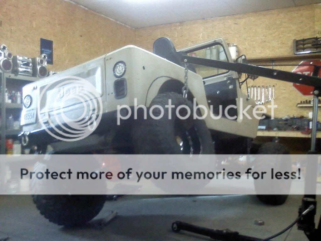

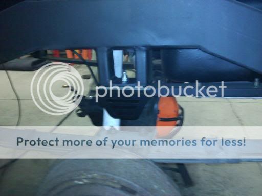

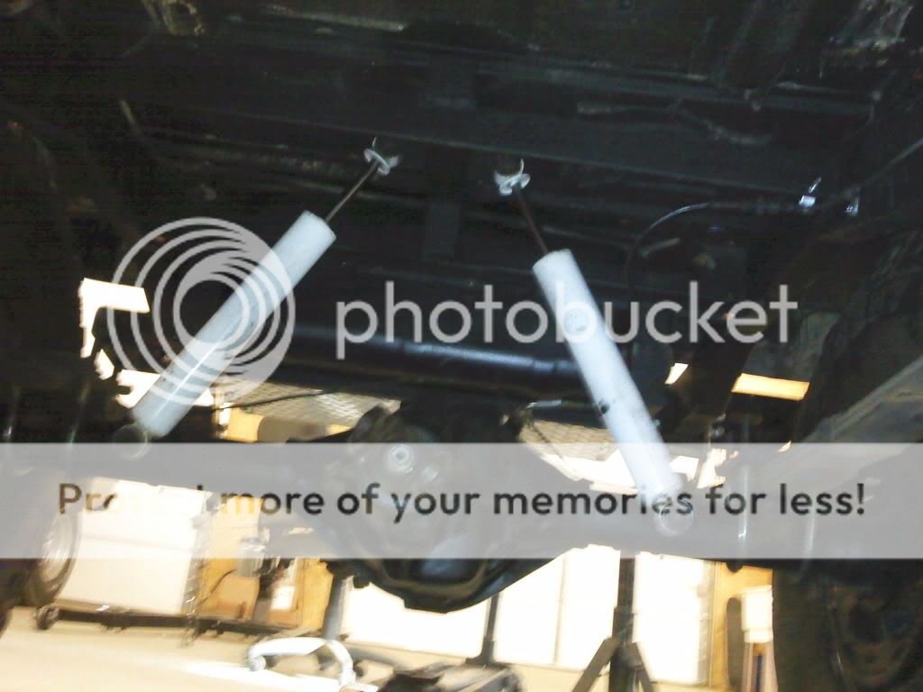

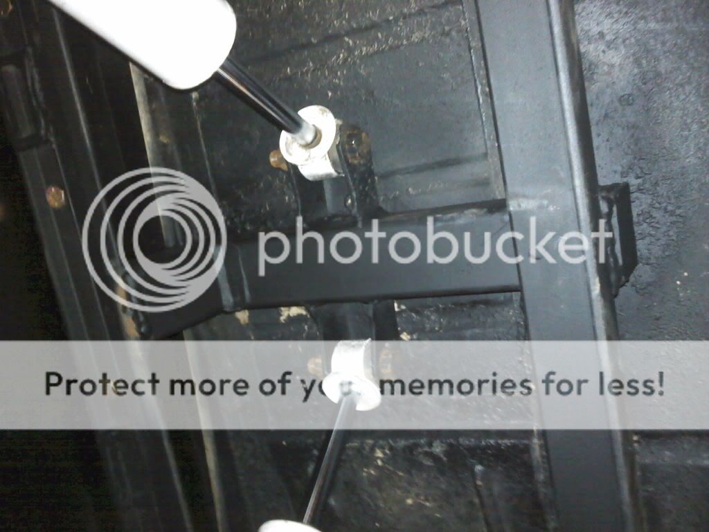

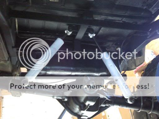

this is the way i found it when i got to my cousin's shop saturday morning
he already had the upper shock mounts welded up and was working on the lowers
here is my free 10in travel shocks (thanks to hendrix for donating them to the project) mounted
and flexed
and also got the rear fenders cut and rolled to match the tire

How do you roll the fenders like that with out wrinkling the sheet metal?
The guy is a half *** good body man. He did some pretty fancy work on those tube fenders also.

Posts: 1,898
cut it about a quarter inch smaller than you want it and then take and work it w/ a pair of pliers slowy going back and forth working it little by little until you finally get it and finish it off w/ a hammer and dolly.

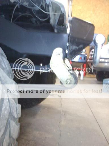

I got the bump stops put on last night
