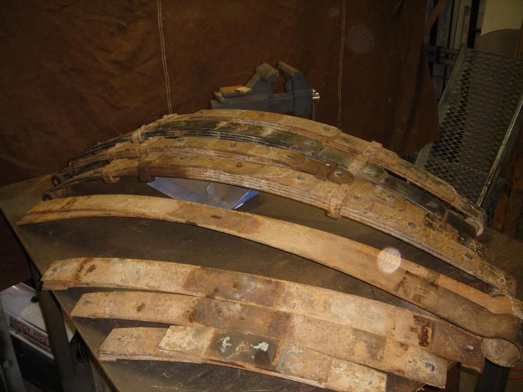

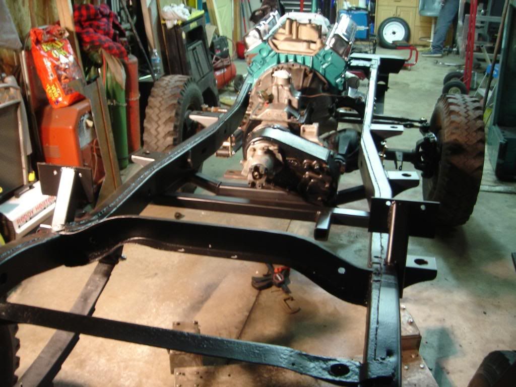

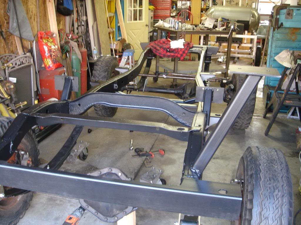

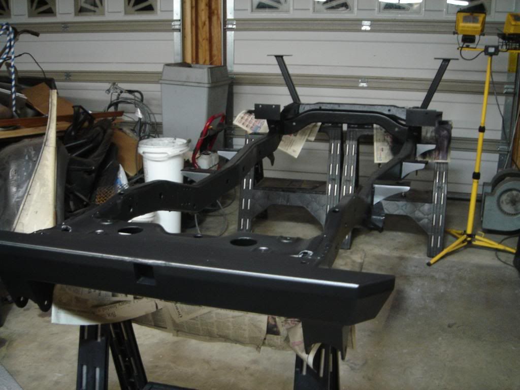

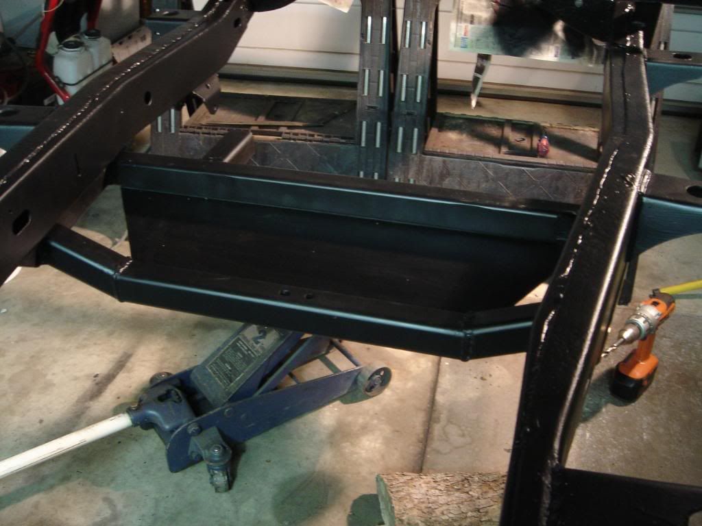

Well I've gotten a few things done since my last post. I got the skid plate put on my crossmember. The frame got topcoated and the crossmember got a coat of primer and paint. I also added a few leaves to the YJ spring packs I had, cleaned and painted them. I probably did a few other things that I can't think of right now. Anyway, here's some pictures...

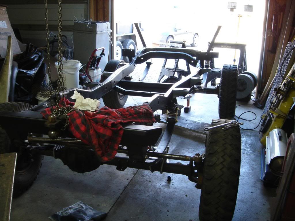

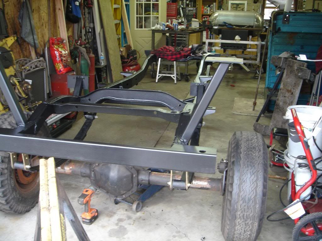

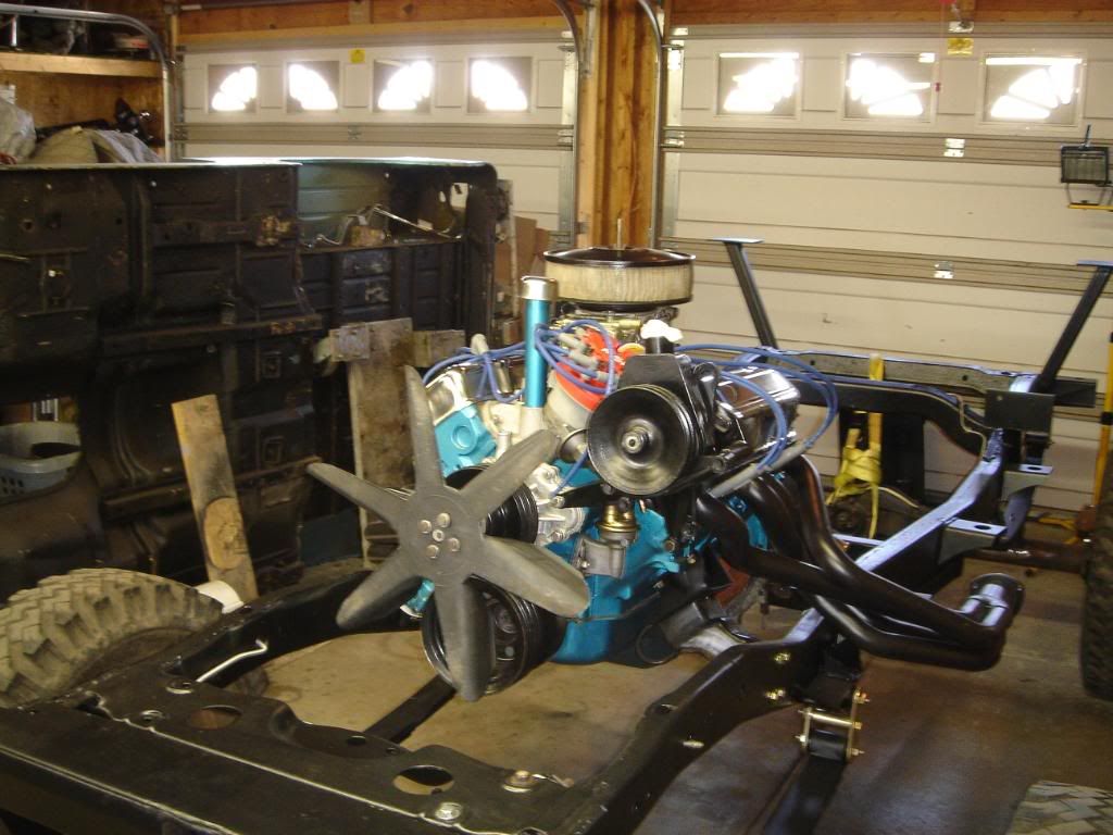

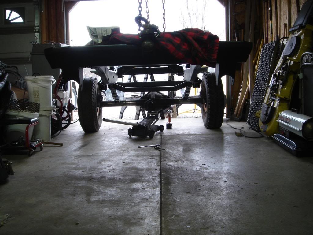

Today I...
-assembled my bastard packs
-replaced some spring bushings
-hung the springs
-put the front and rear axles under the Jeep
-sat the engine/trans/xfer case between the frame rails and bolted it all up
-hung the steering box
and some other small tasks along the way.
Picture time!

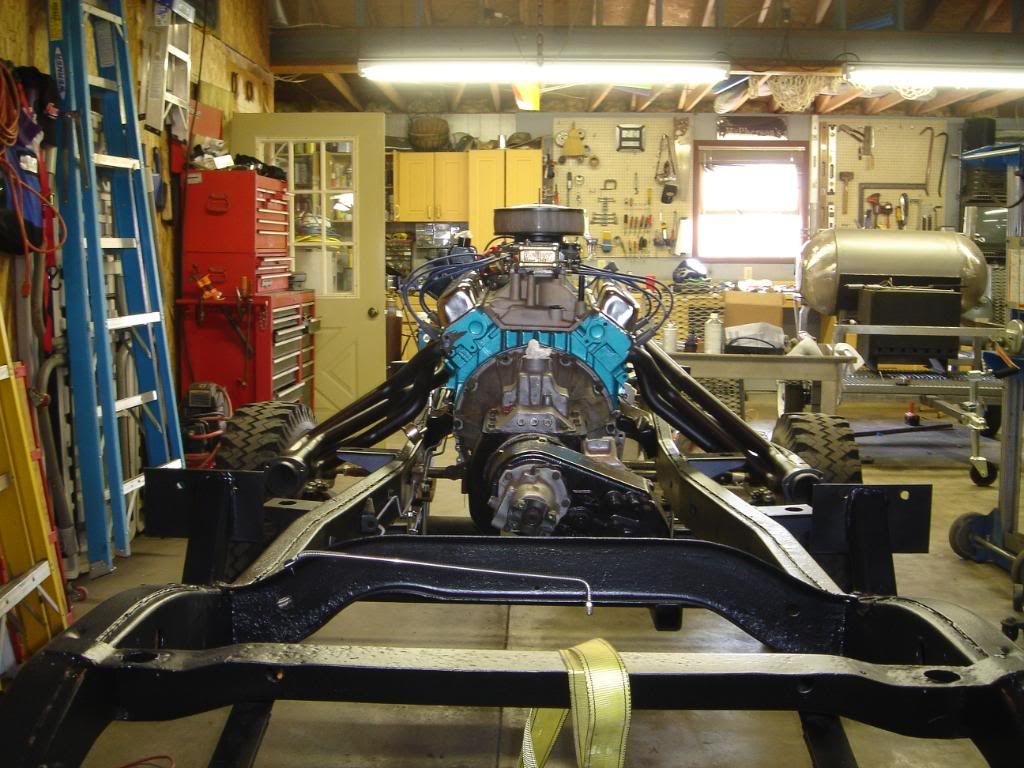

Rear axle in place
The magic floating front end
Front and rear axles underneath
The engine/trans/xfer case in place!

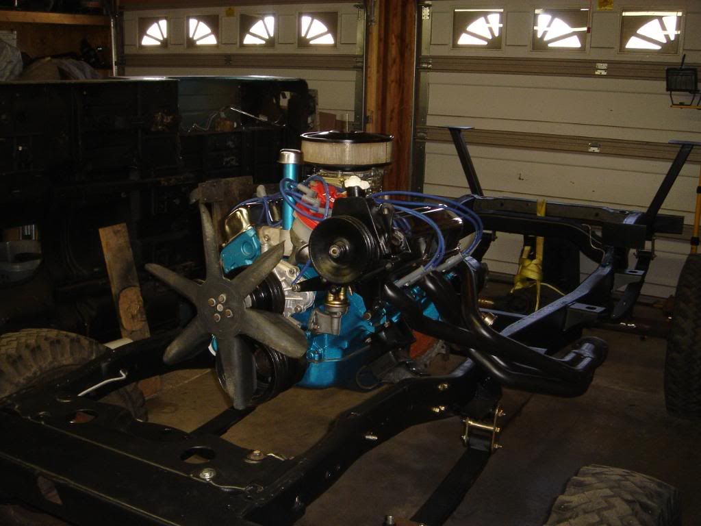

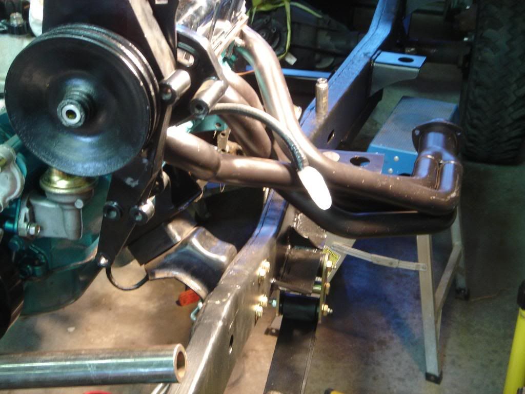

I realized I forgot to update this a couple weeks ago.
I got a lot of the engine stuff buttoned up. I never did get it started b/c I couldn't find my alternator bracket. Never did find it. Spent about 8-10hrs cleaning the garage and looking for it and never did find it. I'm going to the junk yard this Friday in search of one. Here are some pics...
This is my little balloon I made out of a latex glove to help me find the compression stroke for TDC. I was having trouble feeling much of anything with my finger when I was trying to turn the engine over by hand. It was rough work even with a couple feet of cheater bar.
And here are some other shots of junk... sorry some of them are kind of dark
79CJ7/401/NP435/D300/D44/14BFF in progress! Check out my build thread...
tsujeeper is offline
post #53 of 66 Old 04-05-2009, 08:54 PM Thread Starter
tsujeeper
Join Date: Feb 2007
Location: Indy,IN
Posts: 260
It's Alive!
I'm guessing maybe 5% of you will actually read this once you see pictures and video below but oh well, I'll still tell the tale. Went to the junkyard this weekend and scored the alternator bracket that the garage gremlins stole from me. Got the exhaust put on and all the other crap I needed to get done before starting it. Got all the 'temporary' (read booty fab) wiring done to start it and it wouldn't run. I finally traced it down to an MSD 6AL box that would work randomly and about 10% of the time. No biggie I got it for free b/c the guy didn't know if it worked. Obviously it didn't.
This morning I went to O'Reilly's and got a Street Fire CDI box for about 2/3 the price of a new 6AL. It's an MSD product and from what I've read it's the same thing without being the 'red box' that everyone knows. Got it all hooked up and had some problems getting it to run right. I fooled with the timing and got it running long enough to get a light on it to get the timing where it needed to be. After that it purred like a kitten, a very mean kitten. Only one slight problem... that god awful knocking noise. It wasn't a lifter, didn't sound like a rod, felt the bottom of the oil pan and could feel it thumping. Put 2 and 2 together and decided that the crank was hitting the dent in my old crappy oil pan. So I dropped the oil pan and hammered it, put new Rotella T in it and was ready to go. I ran it for about 25 minutes at 2000rpm to break-in the cam and now I'm as happy as a clam! Here's the pics and a video if it works...
The high temp exhaust paint didn't do so hot. haha Looks like I'll be pulling them and trying paint again! Oh well, I've got a bit of a header leak anyway.
