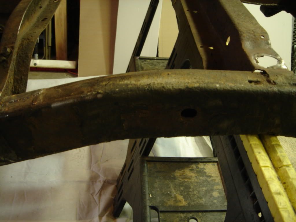

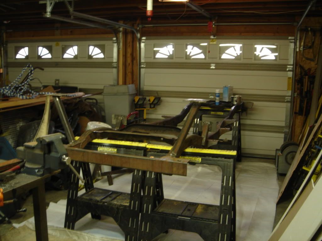

I got some time to work on it this weekend. I've stripped it back down to the frame. I'm getting ready to turn the corner from dirty rusty crap to clean painted parts!
I put the frame on some sawhorses and went to with aircraft stripper, wire brush, scrapper, and the angle grinder with a knob brush attached. I forgot to take 'after' pics but just imagine the same frame with a little less rust and all the paint gone and laying on the drop cloth. haha Next time I work on it I'll be applying Eastwood Rust Encapsulator to the frame! See my post about this in the forum if you don't mind.

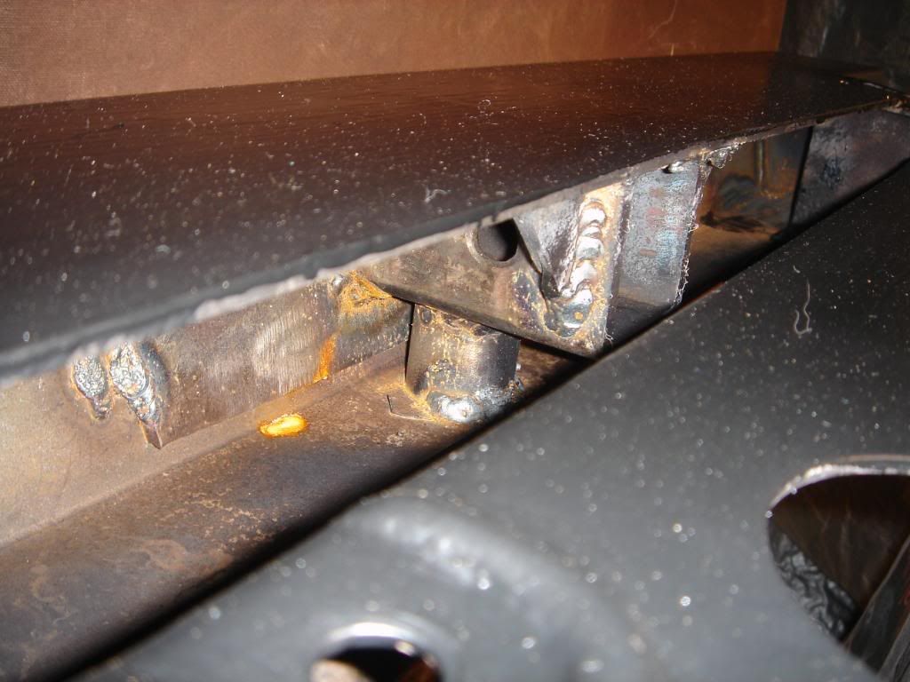

Anywhere here is my frame. The 'bat wings' are for the cage frame tie-ins.
A close-up of the 'paint' I later removed.
Next time I upload pictures I'll hopefully have a painted and pretty frame! I CANNOT wait to turn that corner!

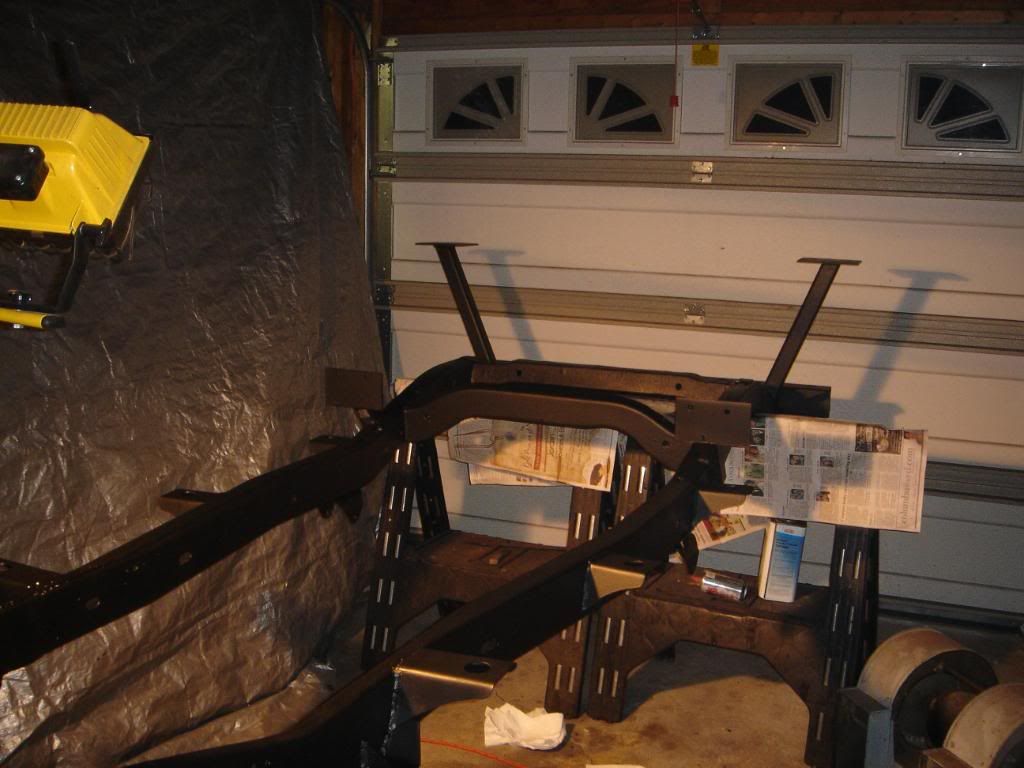

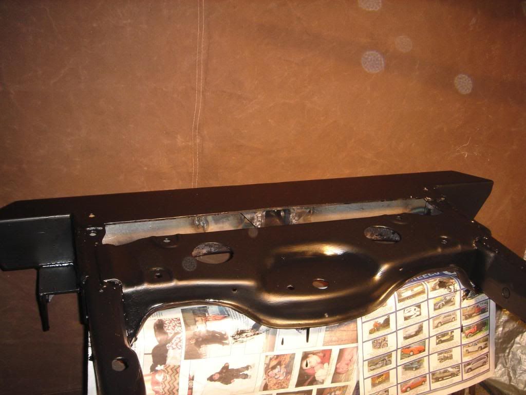

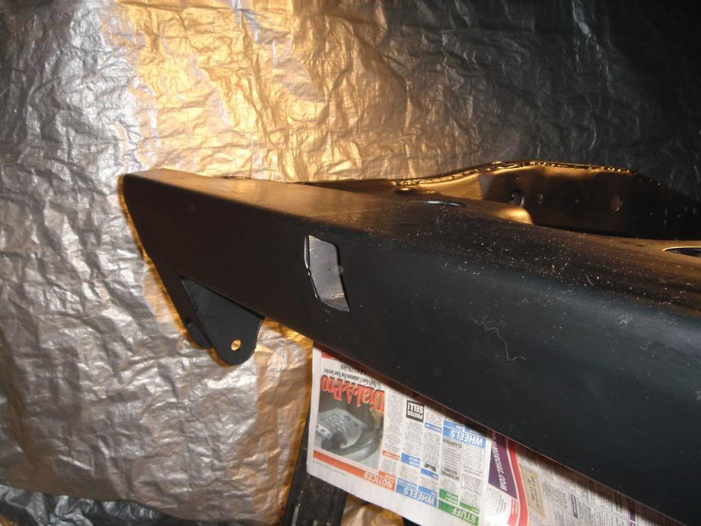

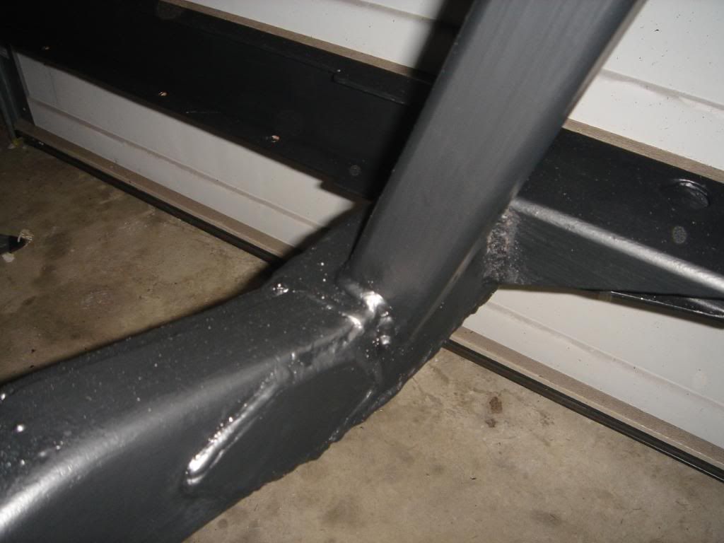

Well this week is Spring Break. Most kids choose boozin' on the beach. I chose to take the whole week to work on the Jeep.
Got the frame all cleaned up with aircraft stripper, elbow grease, and a pressure washer. Then I went to work making my front hitch receiver. It took a lot longer than I had hoped but I think it turned out alright. I took these pictures after coating most of it with Rust Encapsulator so the timeline might be a little confusing. The welds are ugly b/c it was just about impossible to get the right angle with the MIG gun to weld. Oh well, let me know what you think.
So after I got that done I wiped it all down with prep-sol and sprayed it with a few coats of rust converter I found at Autozone. It was much cheaper than the Eastwood stuff and turned out alright. Then I set up my "paint booth" which is pretty much just to make it easier to heat my painting area. I coated it with two generous coats of Eastwood Rust Encapsulator. This morning I turned the frame over and started working on the underside areas I couldn't get to last night. Overall I'm pretty pleased with the progress. Here are some pictures.

Posts: 4,228
Your rear frame tie-ins look interesting but simple and effective. I am assuming that is just 2" channel? I just installed my front tie-in from MORE and fabed up my own design for the middle points which uses some rubber to insulate between the frame mounted section and the part that attaches to the body. I was going to leave the rears alone but might look into something like you have on yours. I am assuming you had to cut out the inner corner supports on the body to make those fit. Do you plan on doing anything with those or just leave them out?

Posts: 260
Looking good.
It's 2" square tube. 1/4" wall. Wayyyy overkill but it was what I had laying around. Yes, I had to cut out inner corner supports. Not really too worried about them. I'm going to be trimming for TJ flares anyway.
