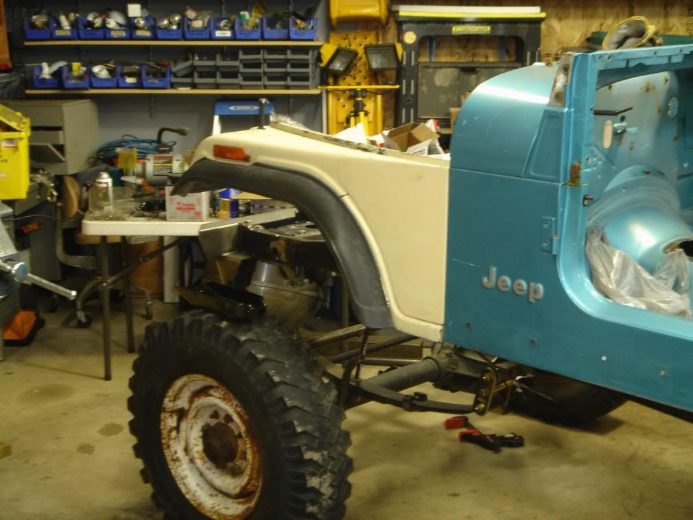

Put the front fender on to figure out where to put my F250 shock towers.

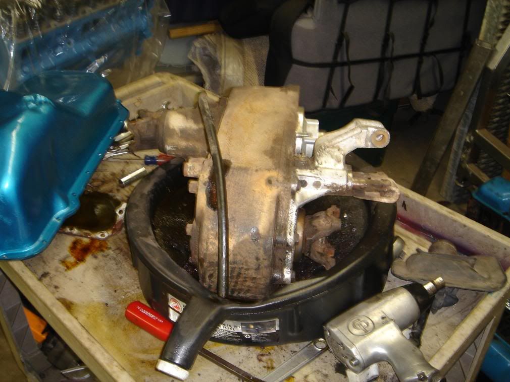

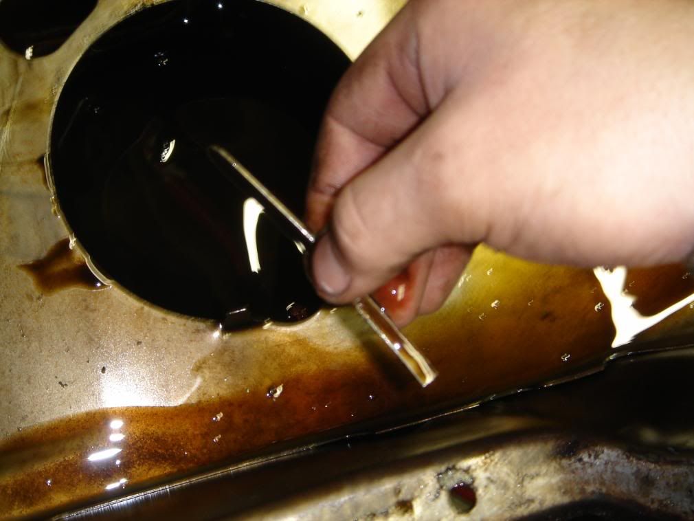

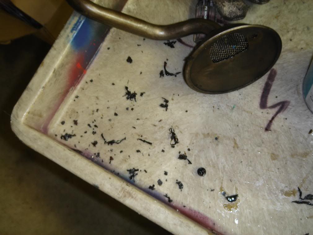

Pulled the oil pan off the 304 and look what I found. No wonder it had a new dipstick! I also got about half a tube of gasket maker out of the oil pickup. The pic was taken when it was only about 1/2 way cleaned out.

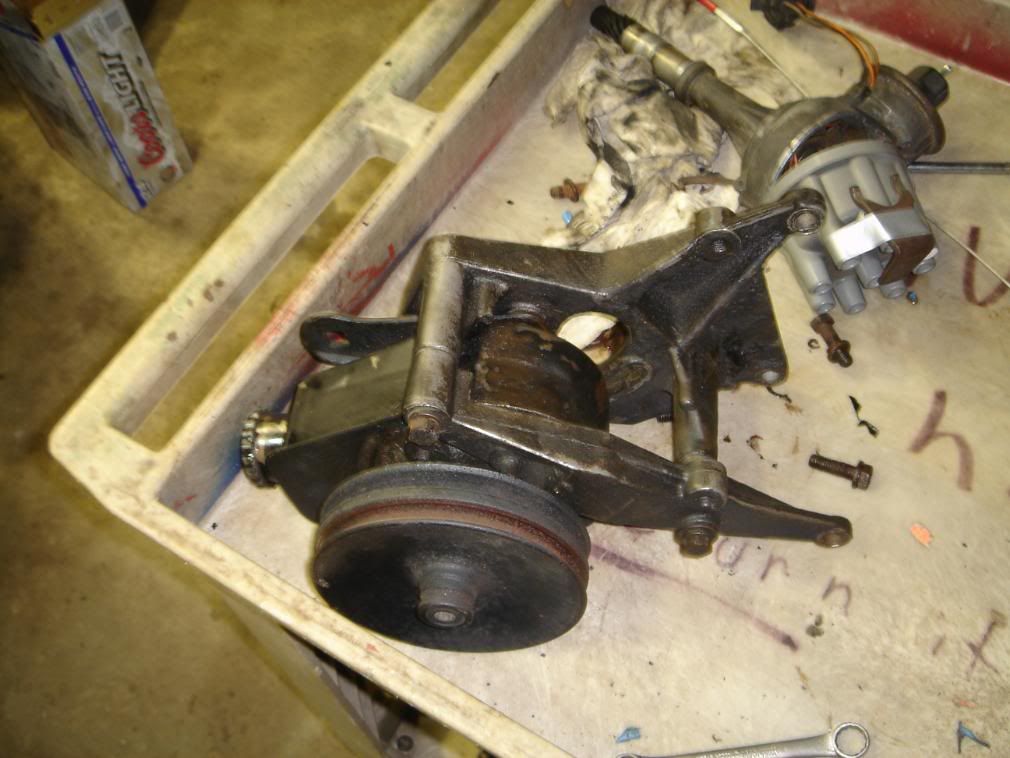

Random pictures of brackets that aren't exactly fun to clean. I've got a new high flow PS pump so I just the need brackets and pulley off this one. I've gotta stop at Autozone next weekend to get a pulley puller. You can also see the dizzy in the back. I think I'm just going to buy a new one instead of trying to clean that one up, it's pretty rough. I also bought a set of MSD dizzy and camshaft gears so I hopefully won't have any problems there.

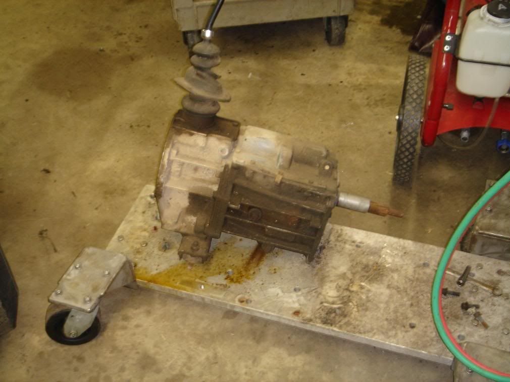

Draining all the oil out of my 'free' dana 300. I'm 99% sure it's the 1980 short shaft version as well so thats a plus. It'll sit behind the NP435 that I've yet to buy very nicely I think. You can also see the painted oil pan in the background. It's pretty beat up and I'm debating on buying a new one.

Hey man, looking great! Do yourself a favor, get a new oil pan. I just got through with an engine swap myself and my oil pan looked perfect. I cleaned it out and put it on the new motor only to have a pinhole leak on one of the welds that holds the skidplate on. Couldn't even see the hole. I must have moved around some dirt or crud that was in the bottom of the pan and freed up the hole.
Save yourself hours of aggravation and disappointment! Just get a new pan.

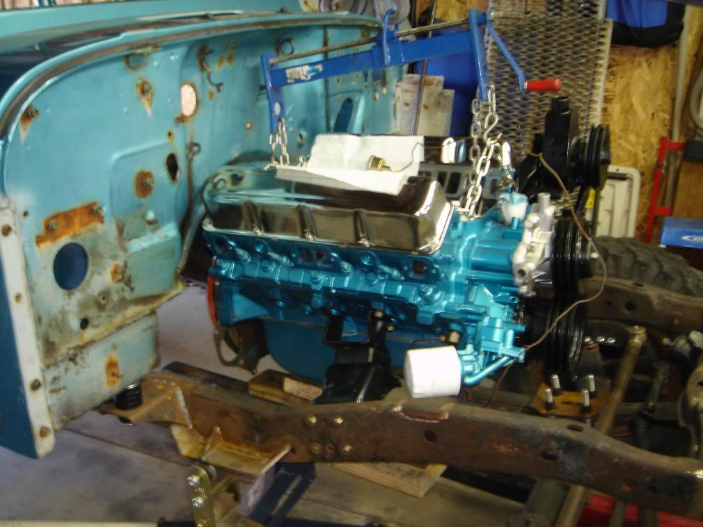

Here's the engine with the new flywheel and Centerforce Dual Friction Clutch.

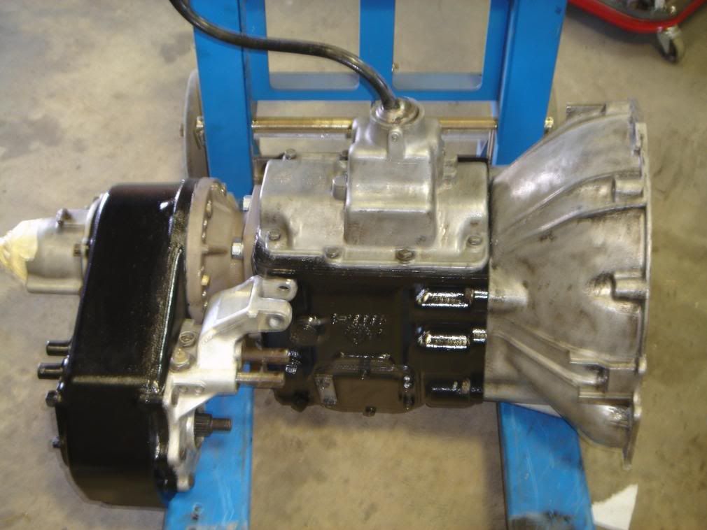

NP435 mated to a Dana 300 with new seals and other fun stuff all around!

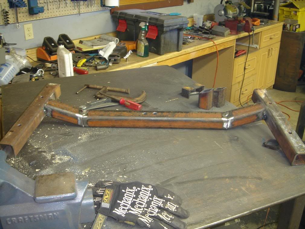

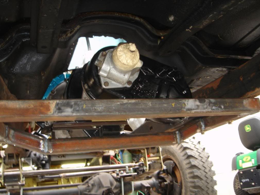

Engine meet chassis!!!

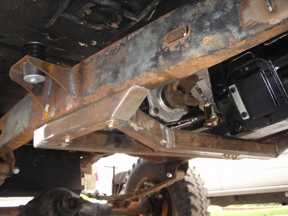

Time to start the crossmember/skidplate....

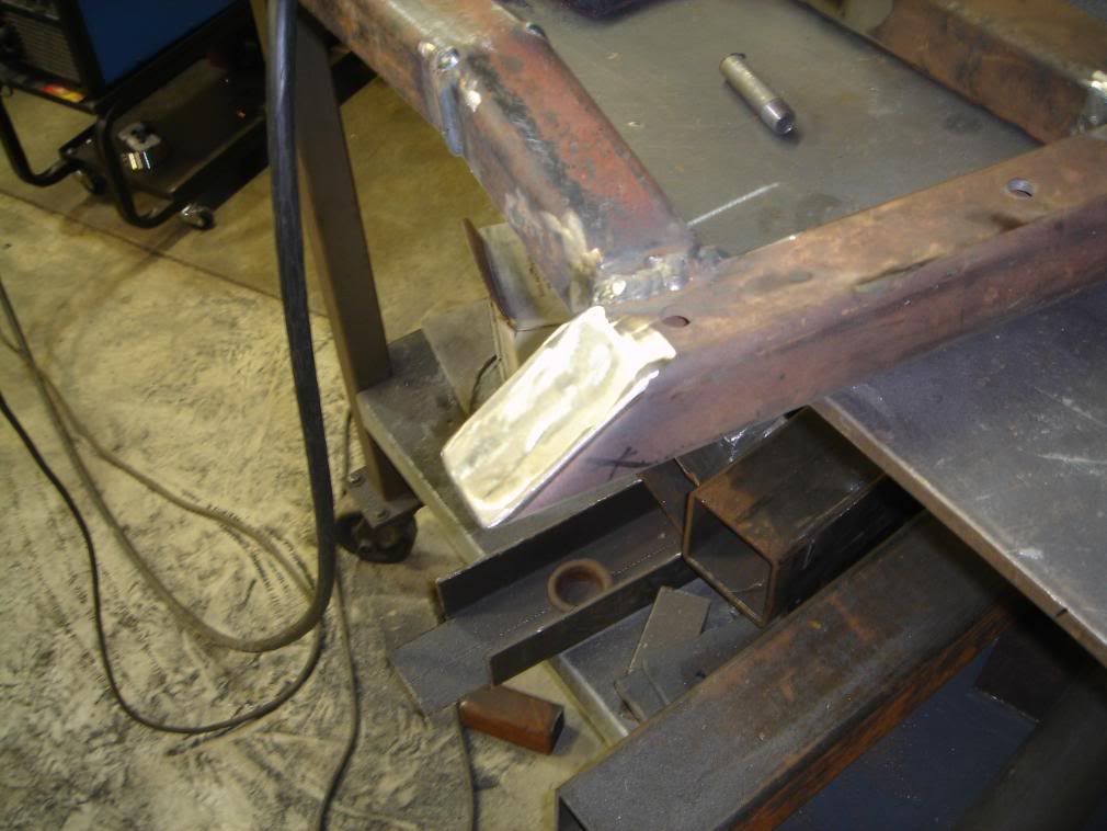

Decided to do a little angling and some welding and grinding for a 'smoother' look
All bolted up!
You'll notice that there's no skid to the crossmember, that'll be coming shortly!

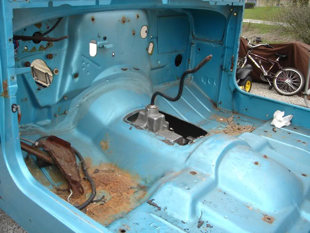

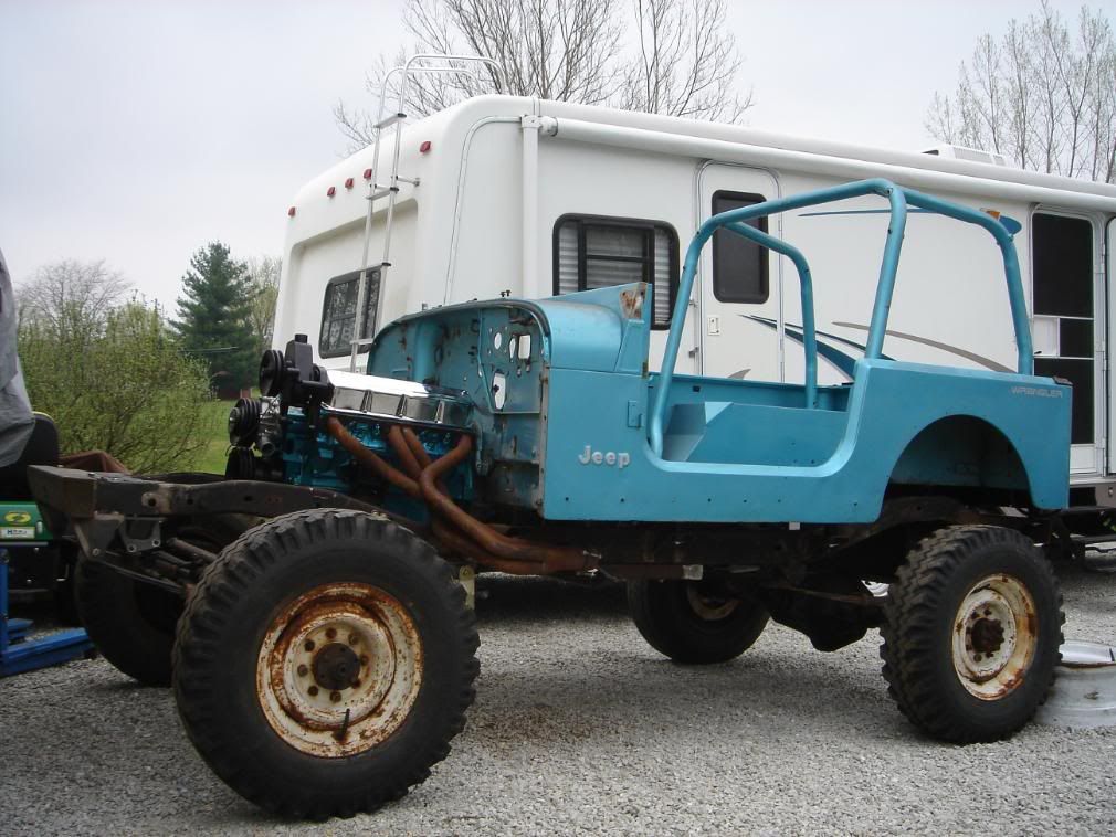

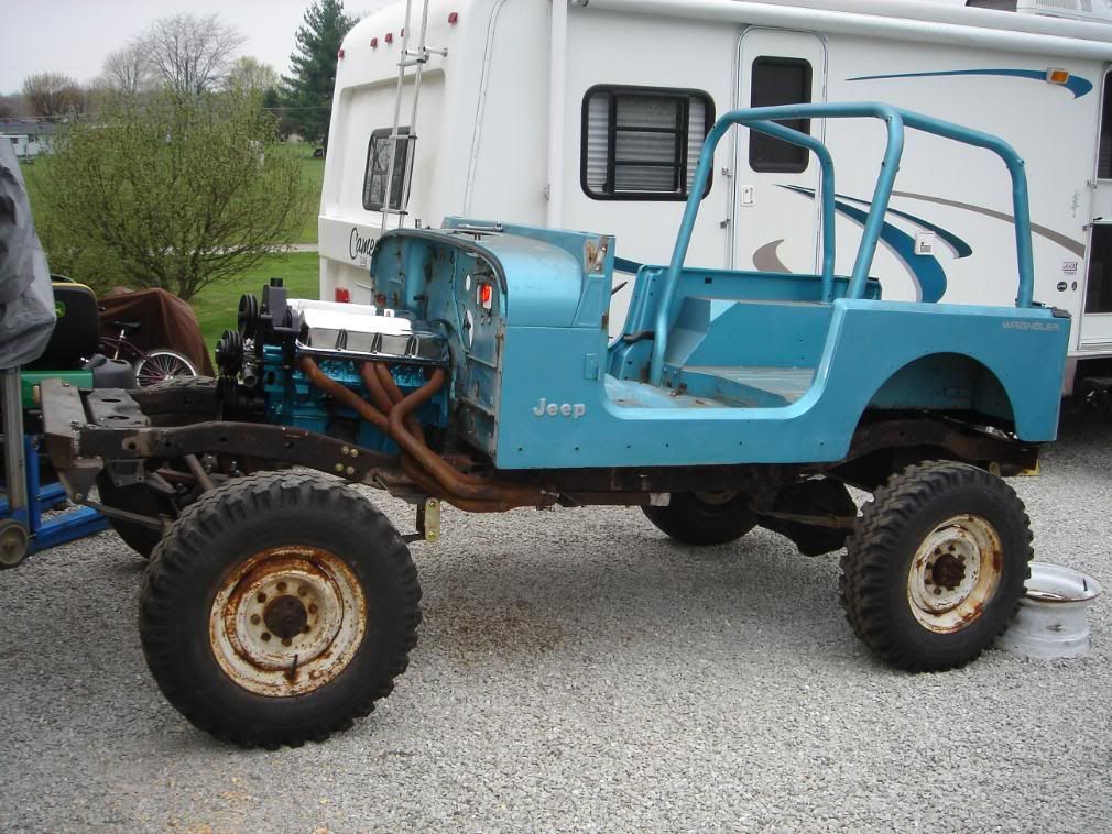

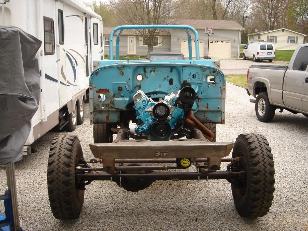

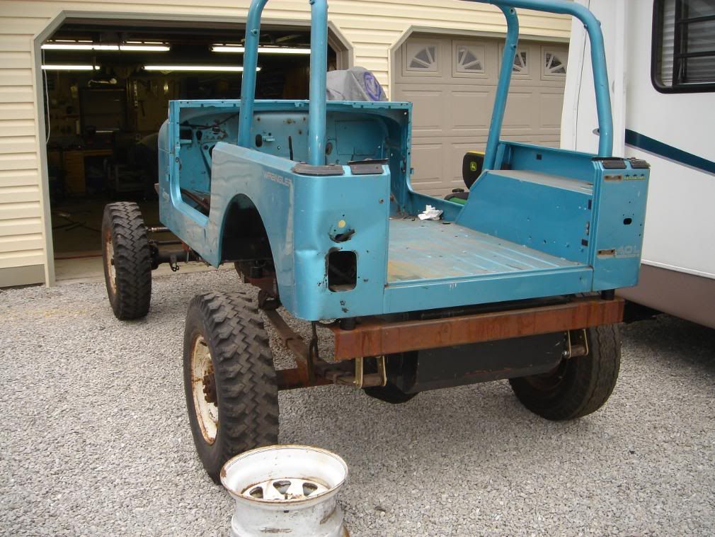

A few overall shots as it sits today.

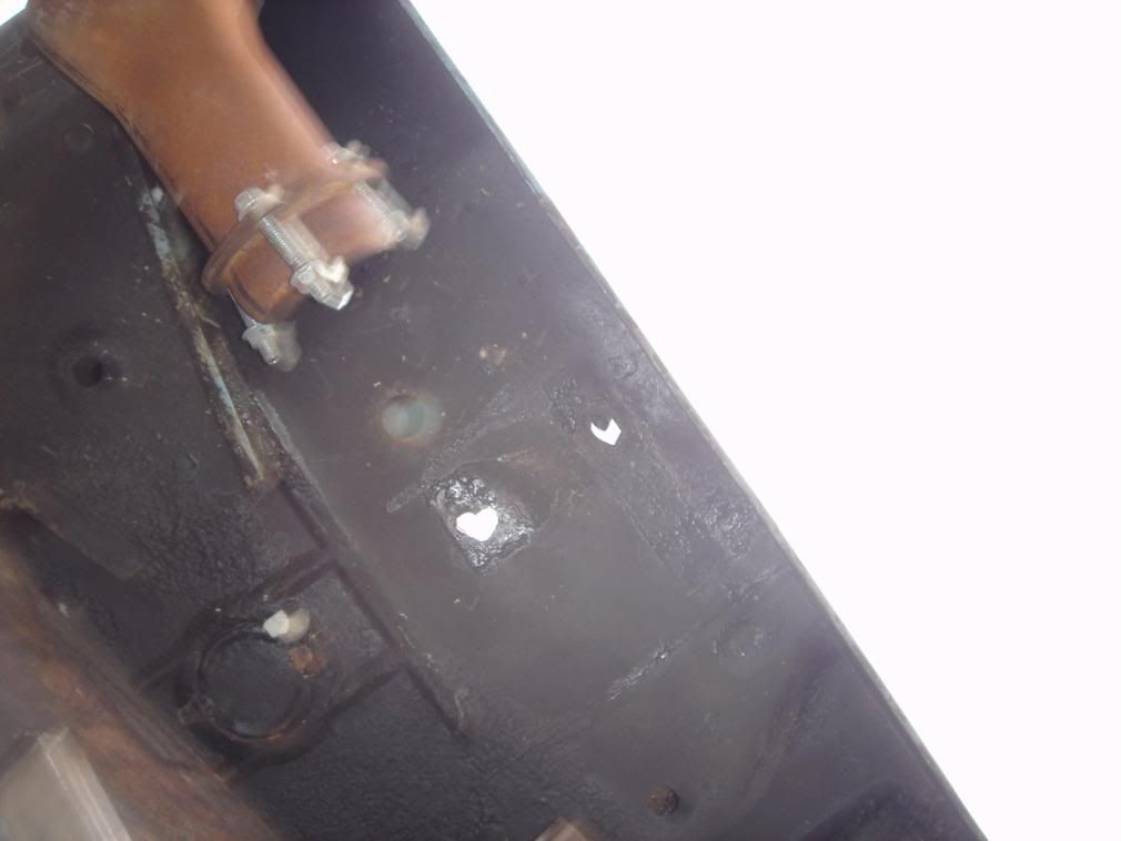

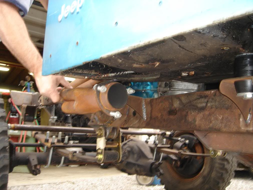

Here's where I really need help. I'm trying to figure out how to to frame tie-ins for my cage and still keep the side pipes. Any bright ideas? I've got a few but I'm not sure they're so bright...

Anyone have any ideas for the cage tie-in and the side pipes?

So I'm considering not using frame tie-ins on the cage. I know they're a good idea and maybe if I go with in-frame headers down the road I'll go back and tie it in. I've yet to find anyone who has pictures of where a non-tied in cage punched through the floor.
I'm really going back and forth on this one...help?

If you have about 2.5"-3" of space above the header collector, you could probably squeeze something like this in there. Use 1.5" YJ spring bushings inside 1.75"x.120" DOM tube for the isolator.
If you're not concerned about solid mounting, just do a "J" bend in a piece of tubing. Cut the tubing mid bend.. kind of like a "bologna" cut in an exhaust pipe..
