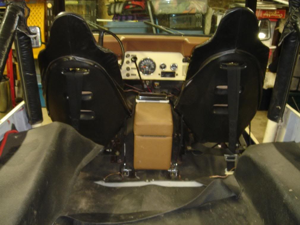

Mid tear down...

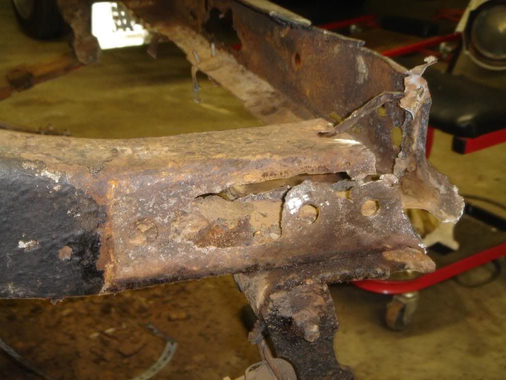

Posts: 257
The frame rot...

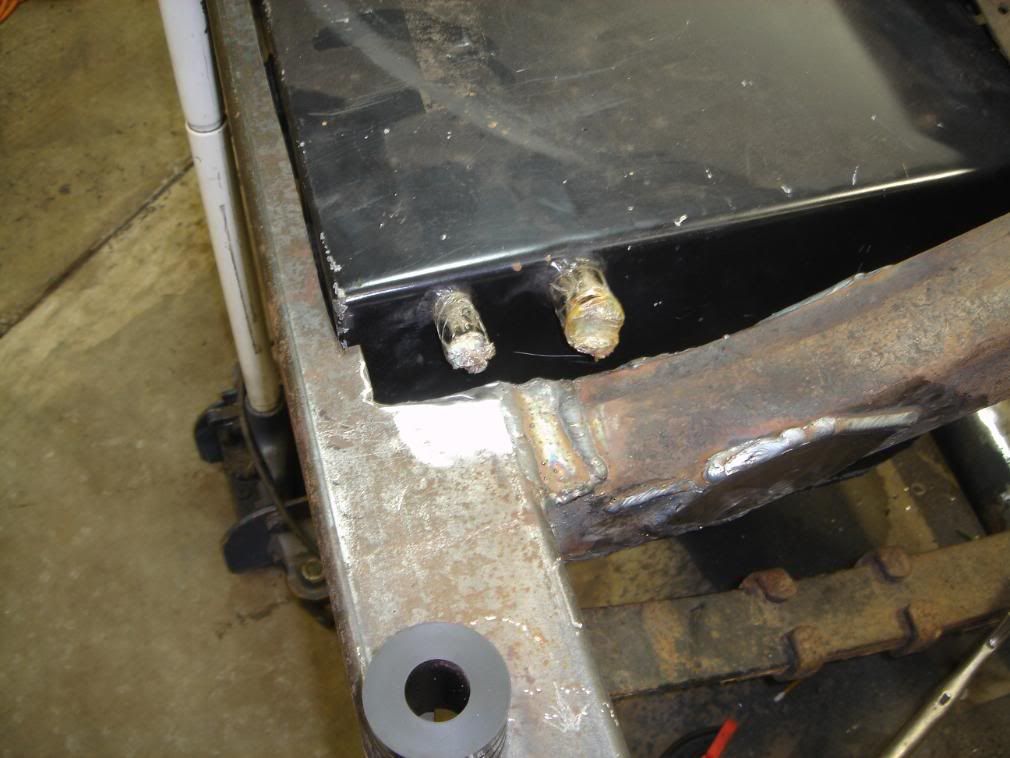

Well I finished the frame repair on the rear today. Got all 4 fish plates on and the plug welds ground down smooth. Also got the gas tank hung. I chopped up the mounts on the tank so I could move the tank back about an inch into the recessed area I made on my crossmember. The tank is 23.1 gallons IIRC. It's made out of 1/4" steel so no need for a skid plate.
Might be able to put the axle on the rear perch holes to gain another inch of wheelbase. I'll have to wait and flex it out to see.
You can see where I tucked it back into the x-member.
