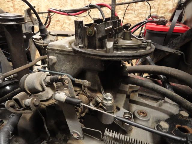

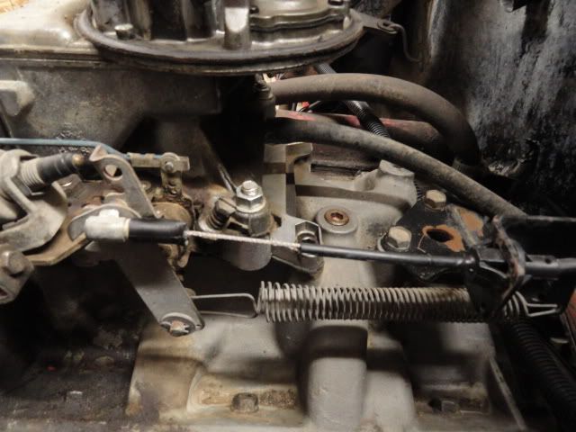

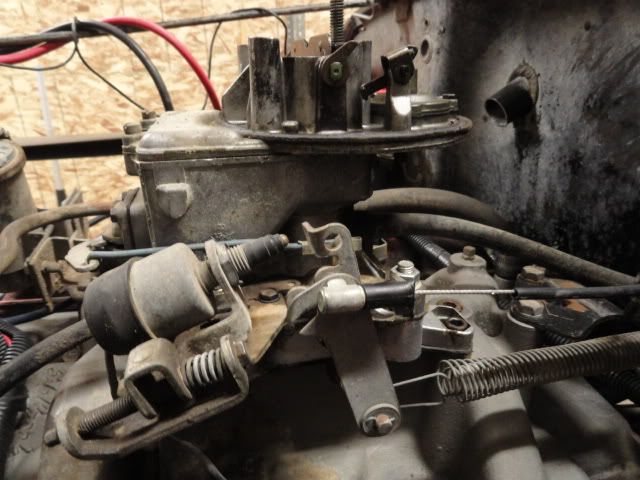

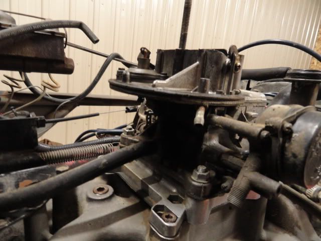

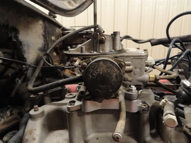

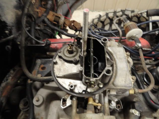

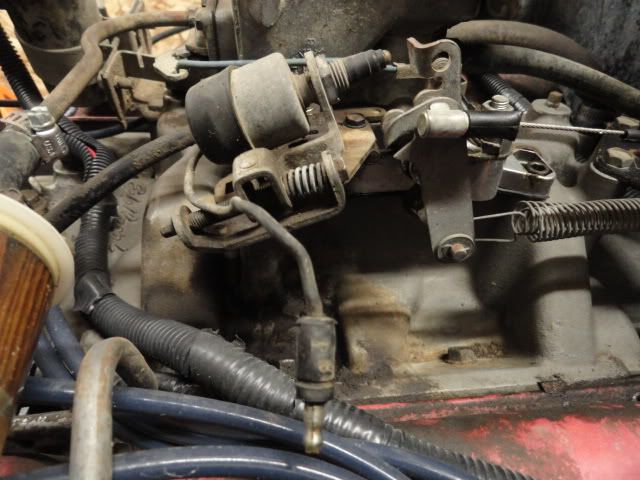

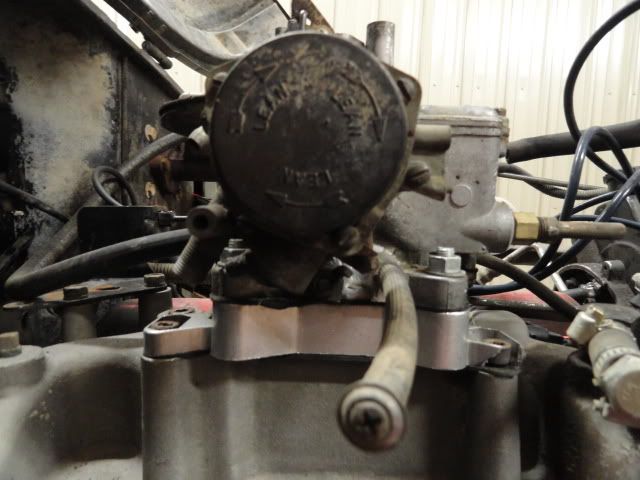

JeepHammer gave me a good list of things to check before I get into the carb to make sure it is working correctly. I am carb dumb. I have never really worked on one besides R/C cars and lawnmowers. Here are a few pictures of the carb. I need to know what is missing from it, and what is not hooked up correctly.
It seems to run good, but there is not a choke hooked up that I can see. I would like a choke back, it can get cold here, even in the summer.
I DO NOT plan on doing any major engine work to it this year unless I absolutely have to. I WILL however do all the basic checks JeepHammer told me to.

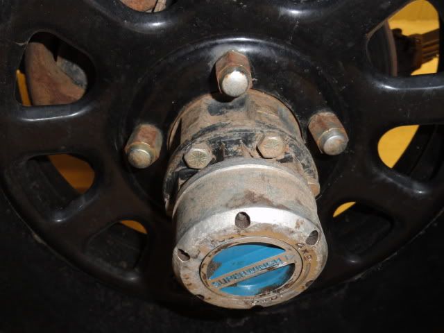

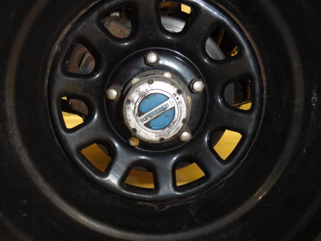

Here are my front hubs. I was told to retighten these bolts before I take it out every time. Sure enough when I checked them, they were loose.
What hubs do I have in case I have to get replacement parts? Any way to get these bolts from loosening up? Anyone have a good write-up on how to take these apart and put them back together. Like being carb dumb, I am also partly axle dumb. My main concern is so I can carry spare parts with me in case I break on the trail, AND, I know how to fix it, on the trail.

Oh yeah. YES, I do have a Haynes manual, and it is very vague on certain aspects.

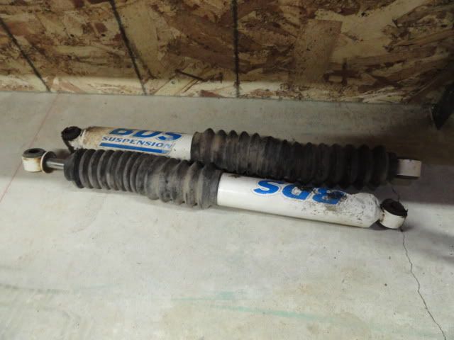

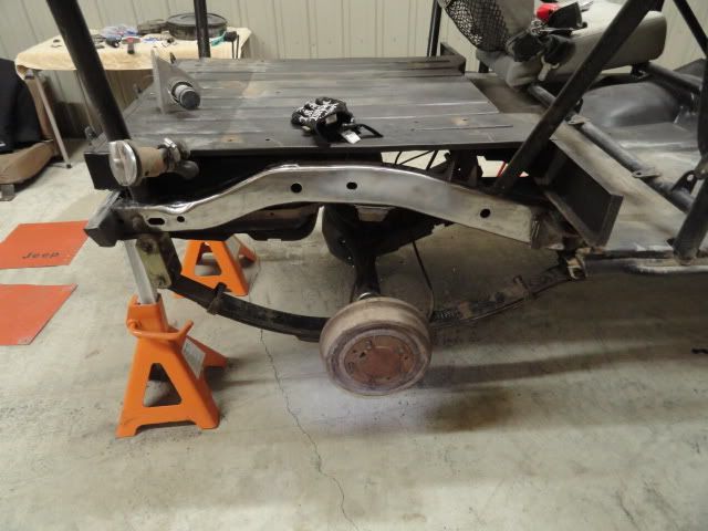

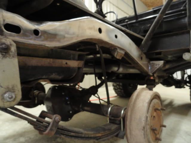

Made a bit of progress last night. I did notice though, and you can see it in the rear shot above, that the previous owner must have gotten weird into something hard, and the rear of the cage is pushed over a bit. The front is symetrical, but the rear is over about an inch. I will have to try and repair that, and weld a few crossbraces in to avoid that in the future. Or, just run it the way it is for now, and redo the cage next winter.
A discussion was had with my buddy who is helping me out, and it was decided that instead of messing with the carb, we are going to get fuel injection for it right away. He is going to piece together the one he has put in 3 other club members rigs, and they have had great results with.
Rear shocks are out. I am going to drop the gas tank tonight for better access to the frame. Then the rear axle is going to come out either tonight or tommorow for cleaning and new spring bushings.
I also pulled to rear drums to take a look. Drums look great. Hardware looks great. Probably could use some new pads. I will take the drums to work, have them turned, and replace all the hardware and pads just to be on the safe side.
I should be able to get the rear half of the frame down to bare metal by the end of tonight!
