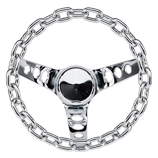

This is what every serious Offroader Uses:
