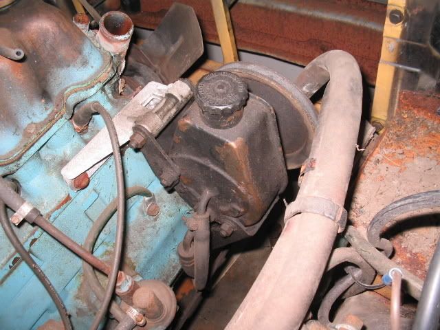

Here is a secton off the Part page:
This is what it looks like:
This is were the bolts are that you should take off:
Don't forget the double pulleys on the water pump.
And yes, this will be a pain later when trying to get the pulley lined up on your water pump because 3 different pumps were used on the CJ alone. No clue how may different ones were used on other AMC models.
