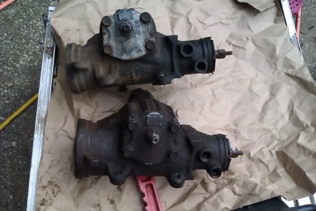

All GM tuck boxes that I know of are Saganaw boxes. They have a cast, somewhat fancy, "S" on the box. Look for ones that have 4 holes. The a junkyard has GM vehicles, it will have lots of boxes.......
Here are two. The smaller one is from a Waggie and the larger is from a J20 truck.
