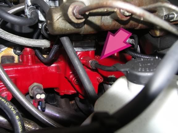

On the intake manifold, threaded fitting between the carb and the EGR valve.

I am the person molsenice is speaking of. I have the AMC 4cyl. I cannot find an available or unused port. I realize on the 258's you have one above the EGR but on my 4cyl there is not one. Can I splice into an existing vacuum hose of the same size or bigger than my vacuum hose on the booster.

The first place to look is on the manifold for a NPT plug on the casting, if it's not there, then look on the base of the carb for a large vaccum port with a cap, if no luck there then you have 3 options, buy a maniflod with the booster port, buy a spacer plate for the carb/manifold surface that has a 1/2" vaccum port or simply drill and tap for one in the manifold, NPT 3/8" or 1/2" of course. Teeing off the egr port is acceptable if it looks sufficent in size like the one in the picture up above.
