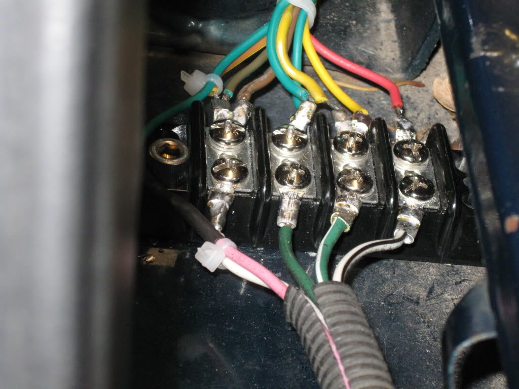

[IMG][/IMG]
not what you want but when I rewired mine I mounted this on top of driver's fender. It's all the wires going to the rear. Then when I did the tail lights, b/u lites, trailer lights, etc, I simply ran the wiring off the back side. everything clean, out of the way, and done from the top. Any changes/additions you care to make takes a screwdriver.
When I did my 4 pin harness it took 45 minutes and a soldering gun to attach 4 ring terminals.
Sorry to hijack....

Now that is slick! Nice idea. I think I may have an idea on how to connect /disconnect the plow lighting on mine. I think that would be better than a couple 6-pin trailer plugs/sockets!
