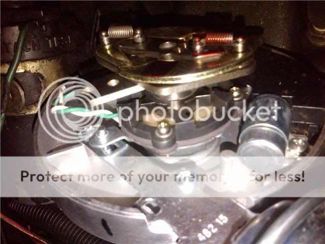

I honestly don't know what to do guys. I have done all above the above recommendations to timing and tips when installing the distributor along with aligning the rotor and #1 position. I even just went and bought a new DUI distributor just to see if that were the case. It didn't fix anything. Could the issue be with the manifold and possibly installing it wrong? Everything went to hell when I switched from the S2P2 to the air gap. The engine just struggles and acts like it wants to start but nothing. I did pull the plugs and they're pictured below. Let me know what you think. I'm losing my mind over this thing

Did you get the extra travel (distributor rotation) you needed and has it run long enough to get a light on it? Also, those plugs are toast so I'd start with a clean set gapped at .040.
You also may try removing the spacer so you get a little better signal to the carb but I'd start with new plugs.
