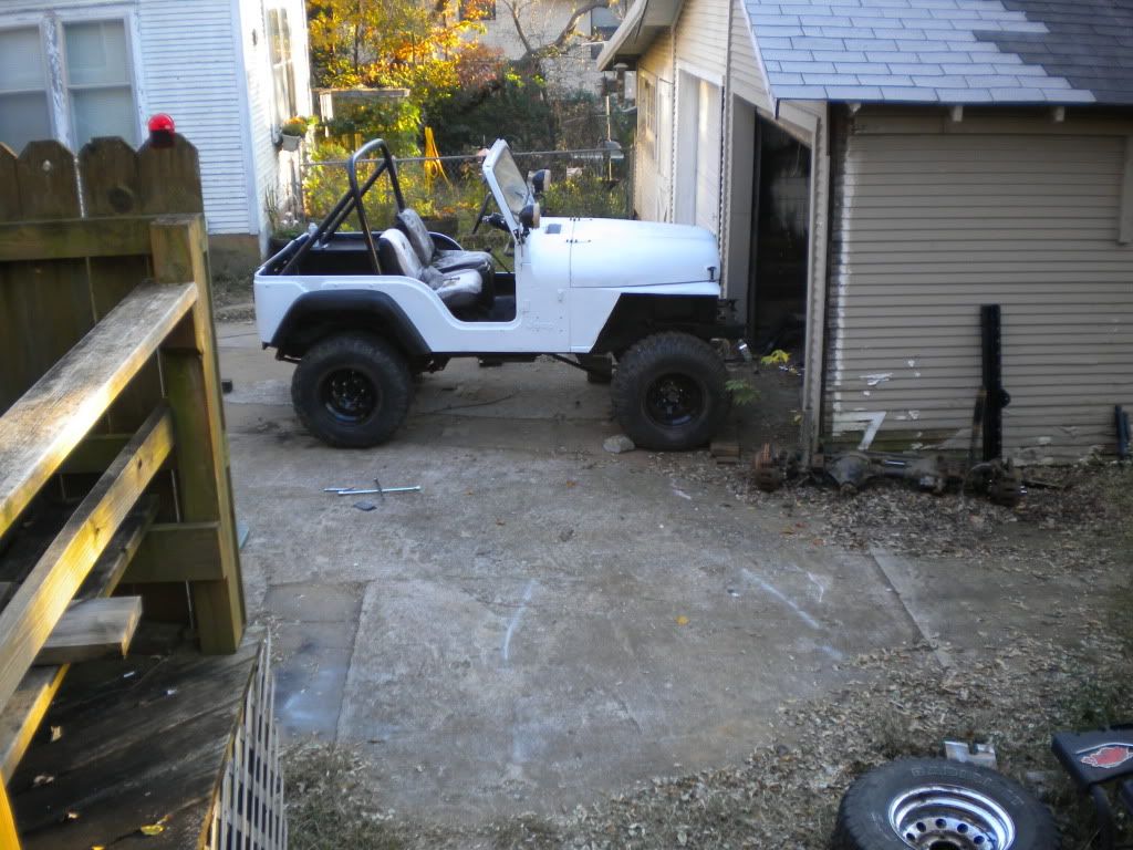

Here is mine. YJ stock springs with widetrack axles and 33s. I am redoing everything but this was before disassembly.
Brian

Thanks GraKee99, that doesn't look too high. I'd say it's right on the line of where I want to be, no higher.
Were you happy with the way the suspension performed? Basically any feedback, good or bad, would be great. Street and trail.

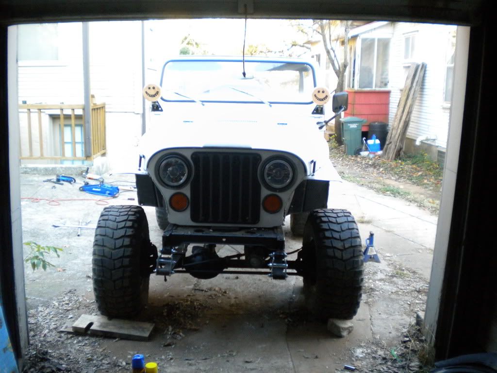

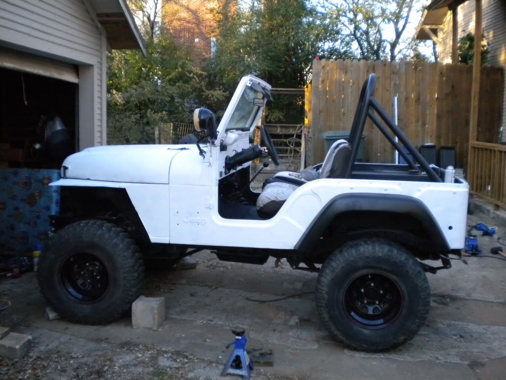

Front
Rear
Spring over and 33s
Beat it to fit, paint it to match!
Wheel, Wrench, Repeat.

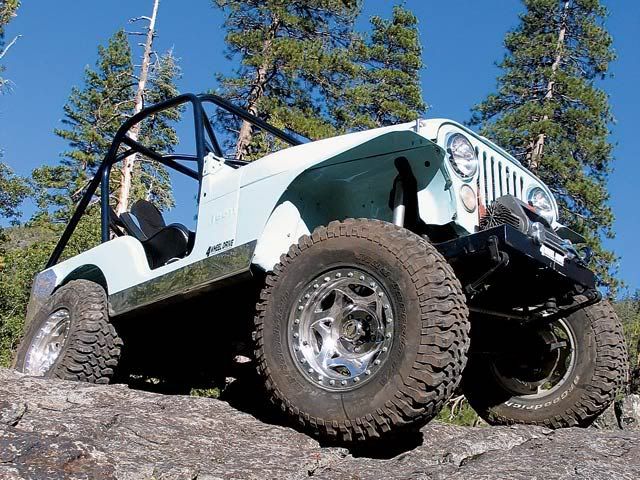

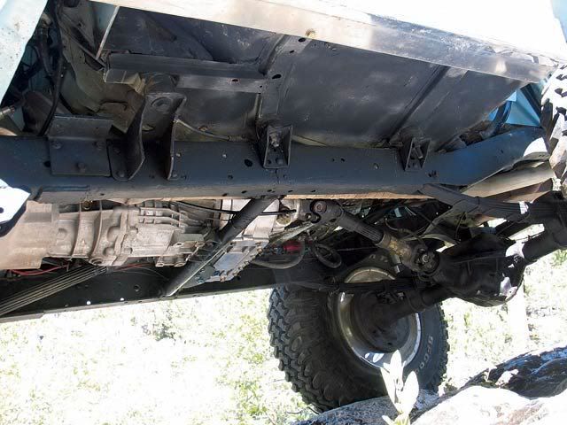

Originally Posted by CSP View Post
One way to lower the COG while spring over is to french the spring and shackle hangers into the frame rails rather than mounting them on the bottom of the rails.

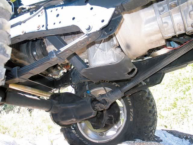

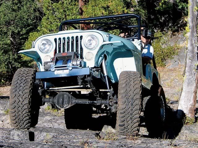

Here's one I found that I like, for obvious reasons. This was taken out of a 4WD online article.
I like how he frenched in the rear. I'm not sure what he did on the shackle side though, if anything.
I don't know what he did up front. It looks like a fabbed rear hanger but I'm not sure if the center bolt sits closer to the frame or not. I'd need to look at mine again. For the front shackle, again, I'm not sure what he did but they look as if they might be frenched in as well.
No idea what springs he used, custom, ect. It almost looks like stock "narrow" CJ springs up front.
I think I'd be scared to cut into my frame like that. I guess a little plating on the outside would ease any worries.

82JeepCJ7, nice jeep!
Stock shackles, YJ stock springs? That looks great!

post #10 of 20 Old 01-20-2011, 01:01 PM
CSP
Join Date: Aug 2002
Location: Colorado
Posts: 16,077
The thing to do is build a "box" inside the frame rails that contain the ends of the springs. Plating won't do much when you take away that much on the bottom side of the rail.
Ok, I see what you're saying. I'm sure I can search around and find some details if I were to go that route.
Welding in there would prove quite challenging I'd imagine. Or do you think it's just a matter of proper execution? Build it first and stuff it in there type thing?

post #12 of 20 Old 01-20-2011, 01:57 PM
CSP
Join Date: Aug 2002
Location: Colorado
Posts: 16,077
Yep, build it first and then incorporate that into the rail.
Those are the stock springs and shackles. I used the original sway bar links to build my own disconnects. Basically cut the ends off and welded on some DOM tube and solid bar, then drilled a cross hole where the hitch pin goes in. The links are shorter than stock due to using the original front spring plates. The plates have to be switched side to side in order to use the sway bar stud. But in doing so, you have to either slot, or fill and redrill the holes for the U-bolts because the one U-bolt is bigger on the passenger side that goes around the pumpkin. I used a 4" drop pittman arm and my drag link came out flat. I get no bump steer at all. It rides great. Handles great. And the flex is awesome.
A friend of mine was running a 4" spring lift on his CJ. After wheeling with me one day and seeing how well mine flexed compared to his, we did a SOA on his about 2 weeks later using Wrangler springs. He ended up trading his lift springs strait across for the stock springs.
82JeepCJ7 is offline

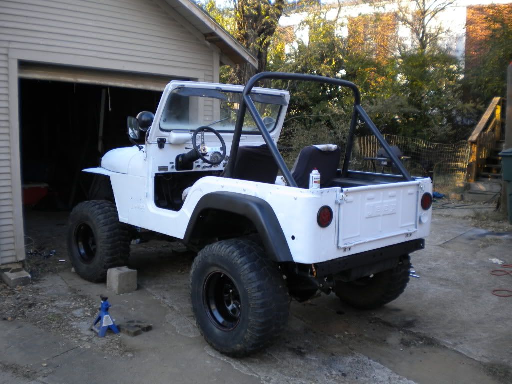

Here is a couple old pics.
That's awesome. Thanks for the help and the feedback, here and in the other thread. I definitely plan to run the sway bar on the street and that helps. That jeep sits perfect.
