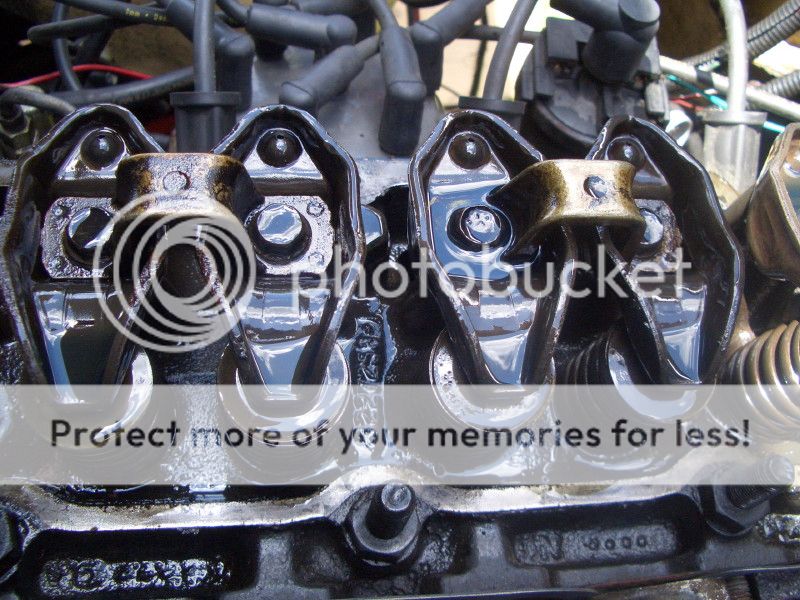

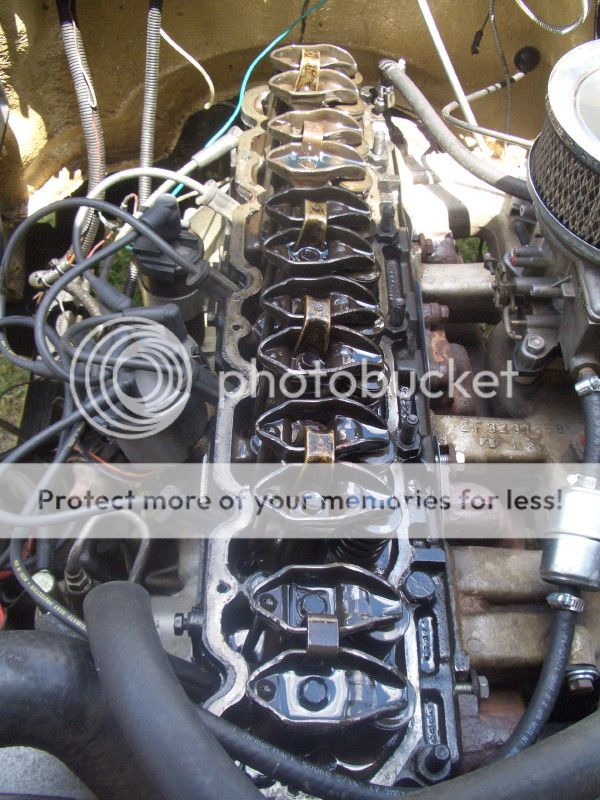

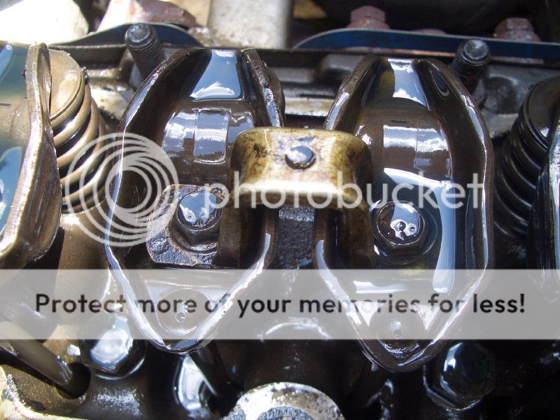

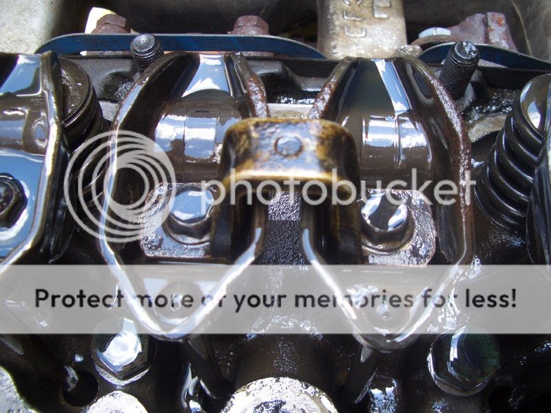

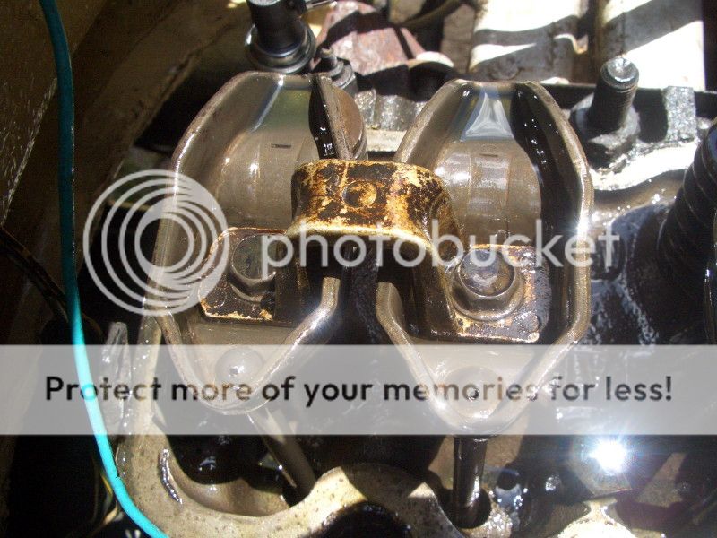

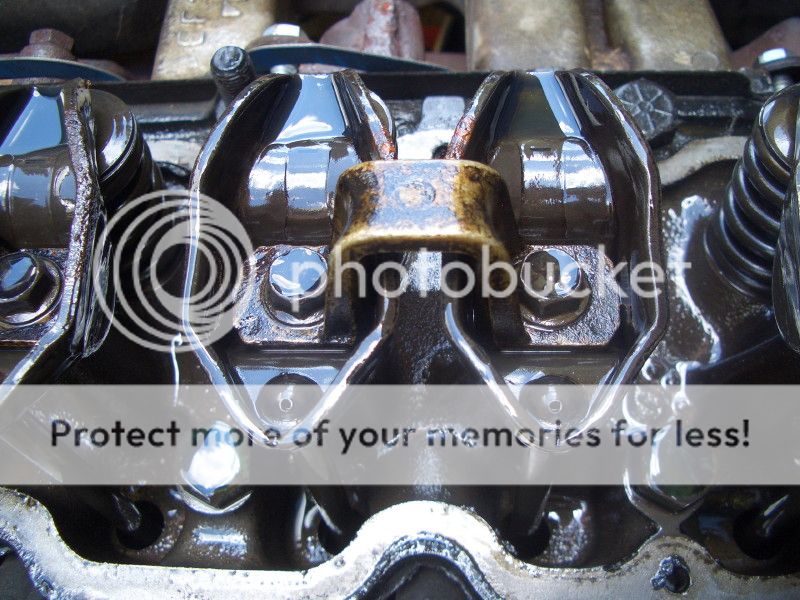

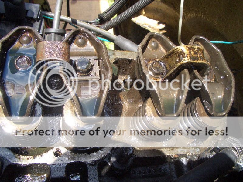

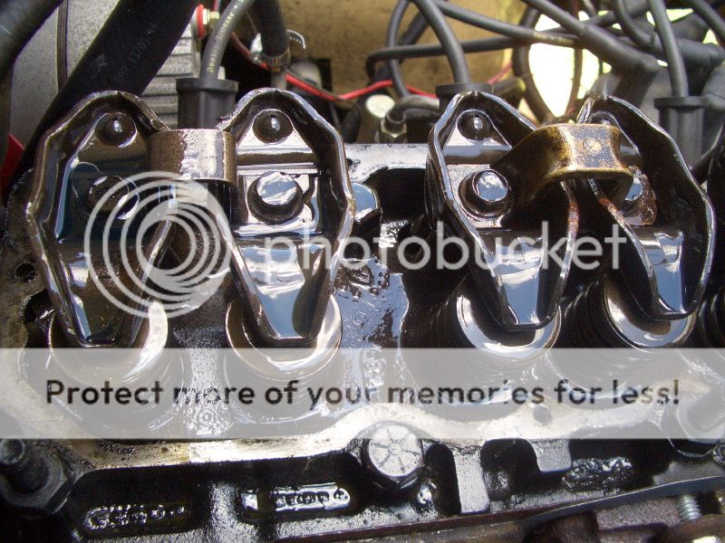

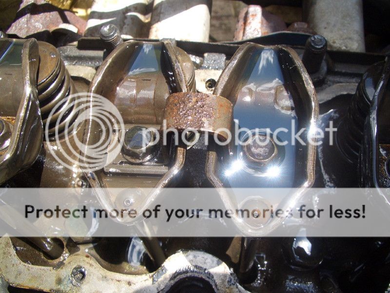

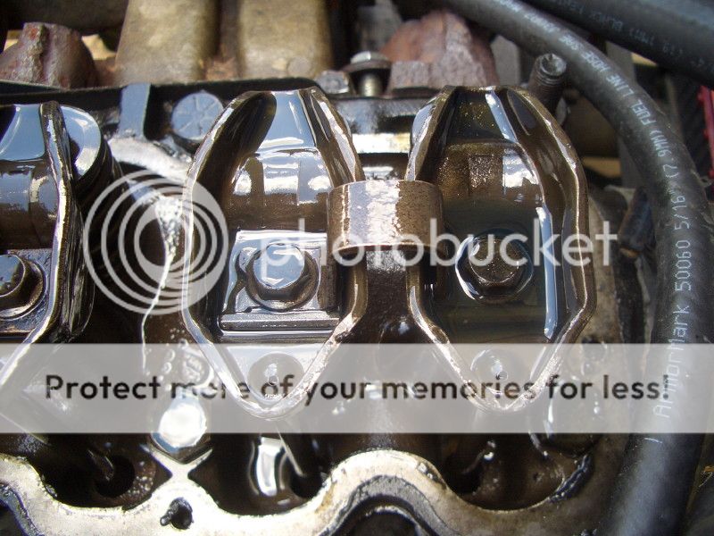

This is probably gonna be overkill, but here goes. I wanted to make sure I had some good photos. The Jeep is sitting half under shelter so there is an obvious shadow. These pics are of the rockers. I took a bunch!
Cylinders 1 and 2 from driver's side.
Cylinders 3 and 4 from DS.
Cylinders 5 and 6 from DS.
Overall shot.
#1 cylinder from Passenger Side.
#2 cylinder from PS.
#3 cylinder from PS.
#4 cylinder from PS.
#5 cylinder from PS.
#6 cylinder from PS.
And valve cover. It is metal.

You held the throttle wide open with all plugs out for the dry test?
The wet test was wide open with only the plug out you were testing?
No matter how you did it the numbers a re close enough to me I can't see a injured cylinder. But you must have blow by because you can't build vacuum in the engine by blocking the breather and the dipstick tube.
If you shine a flashlight into the oil drain plug hole is there and broken piston skirt material?
86cj74.2L is offline
