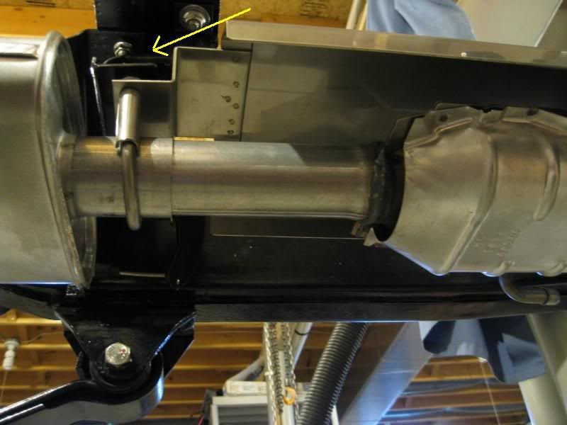

heat shield
Originally Posted by VACJ7 View Post
I made my own heat shield for the cat. I can snap a pic later tonight if you like.
thanks that would be great. I figured making it was the simplest way. Thanks for letting me look over your shoulder, build looks great.
Powder coating looks great. saving up for a gun. I'm really tired of spray cans.

Originally Posted by keith460 View Post
You can get those pieces for the exhaust hanger from NAPA cheaply. But nothing beats homemade and functional.
+1
Now you tell me that Keith!! It did not even cross my mind that anyone would carry that piece. At least he enjoyed making it.
Is this the OEM hanger just after the muffler?
Looks to be the one!

Sorry Keith, what I REALLY meant to ask is that the hanger for here. My rear hanger, which I assumed was OEM, looks more like a Z.

Hard to see in the photos but it is similar to the rear but wraps around on a plate with two mounting holes.

Ahhhhh, I see. Yeah, that is long gone. I'll have to make something work.
Here is the one I made last year. Welded couple of allthread couplers to 2 muffler clamps, bent up some galvanized sheet and there it is. But you are in luck that Keith's latest post has a pic of the one he made. Much nicer than mine. I think during this rebuild I will make mine out of some thicker steel.
'84 CJ-7 |

Paul and Keith - Thanks for the PICs. My mounting brackets rusted away and I could not imagine how to make that connection. Now I see.
