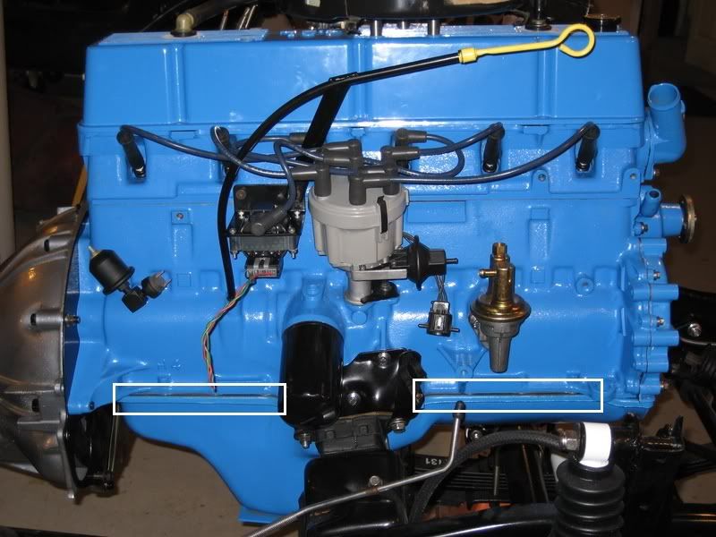

I needed a new oil pan for this engine so I ended up buying a new one from the local Autozone. It is a Spectre Premium brand and the quality is not bad. It was half the cost of an OMIX pan and is made in Canada which I am hoping is better than China!
That's good to know since I have a spare 258 engine here at the house that I bought for $50.00 and it needs a new oil pan. I read the Omix-Ada have fitment issues so I will use the Spectre Premium brand instead. Thanks.

Nice detail work on the timing cover, I painted only the 0 and 8 numbers on mine and the line on the Harmonic Damper too. Your oil pan came out great looking and I hope you painted the edge around the perimeter where it makes contact with the engine block. I failed to do mine while powder coating and had to use Linseed oil to cover the exposed bare steel so it would not rust.
I am jealous, AMC blue is a way better looking color for the engine then old Ford blue.
