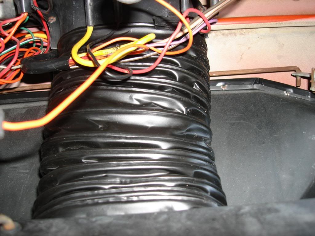

defroster oval vent tube
Vent tube from from heater box to Defroster vents
Crown #5462328
25$
B
Unsure how long it will hold up but it did fit well after I trimmed all of the extra plastic venting back to the metal bands. The OEM is not plastic so I rate this a B. The levers that snap it tight feel cheap but they are holding.

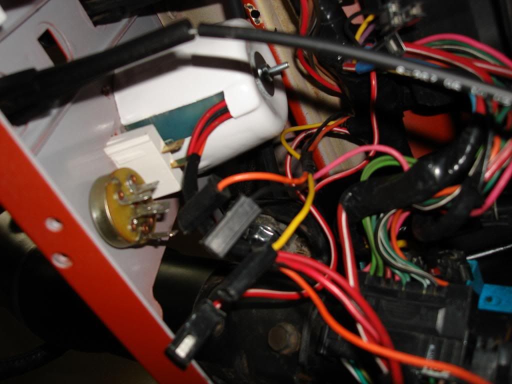

Factory tach mounting bracket/cup
Mounting cup for the factory tack
Ebay user CJ6WORX
A+
16$
Perfect fit, I replaced the (factory?) wood/metal screw with a 8/32 hanger bolt. I had to drill the plastic cup a few thousandth for the new bolt to fit. Added a fender washer and it fits better than new. It is much easier to fit the cup over the machine thread bolt and install a nut than it was to search for the hole in the tach with a little wood screw
