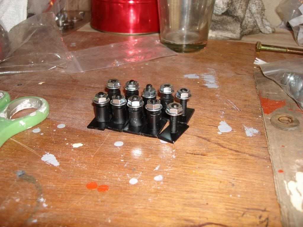

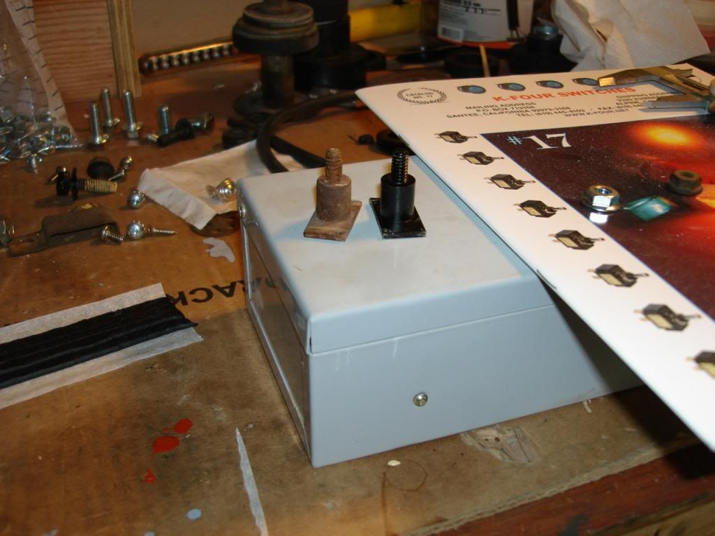

Black aluminum mirror bushings. Required work with a die grinder to enlarge the hole the tube goes into.
I wouldn't buy these again .
Grade= D

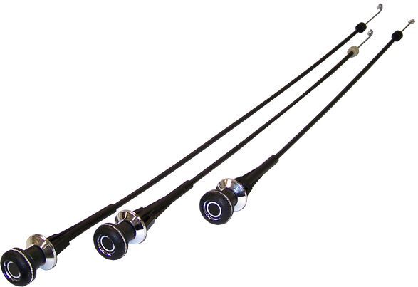

Heater or Control Cable kit from Crown. Part #5463657K
Knobs come off the cables. Had to heat the steel of the cable to fuse the knobs back on after two came off.
Grade D

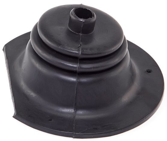

T4 or T5 Shift Boot from Crown. Part #J5752010
Poor quality rubber with seam that splits apart after less than a year. Not contoured at the base to fit contour of transmission floor cover plate. It is well known that these boots rip apart. Cure, buy an OEM version that are still available from dealer. I did.
Grade F

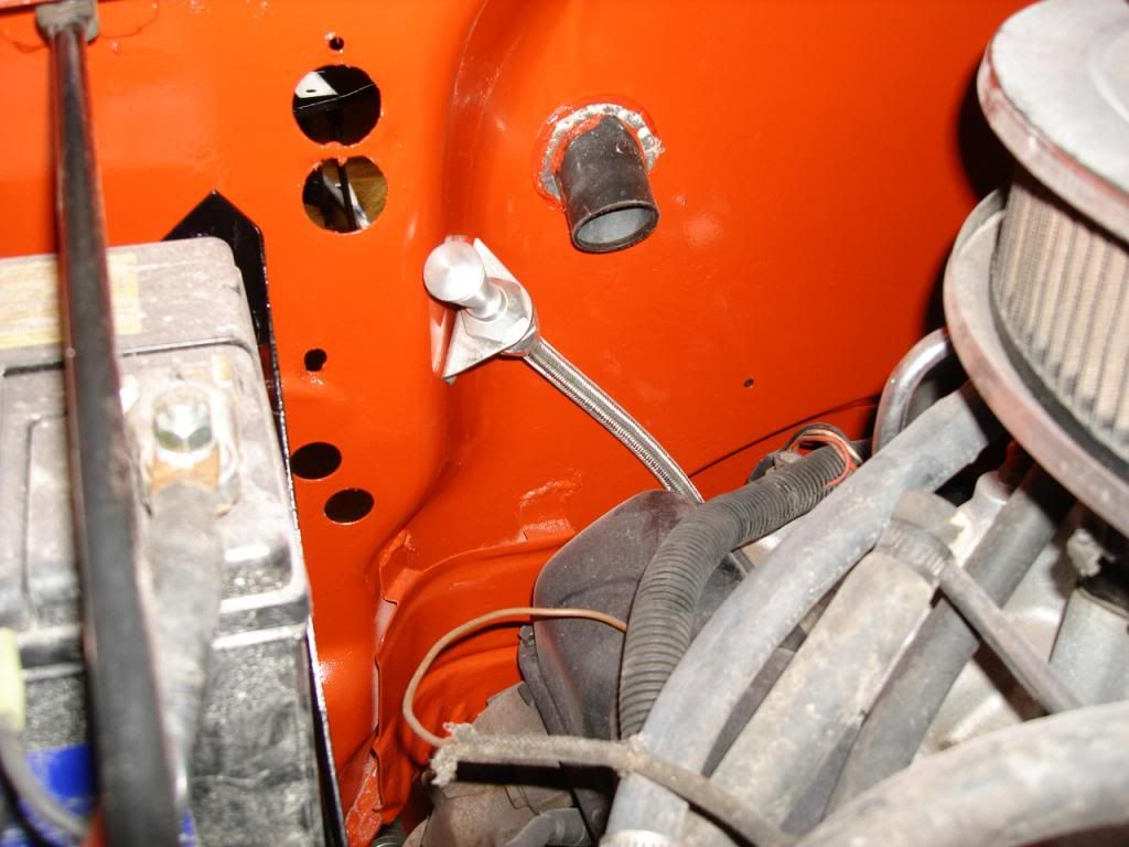

Lokar transmission dipstick
Lokar #TD-3904FM
dipstick tube for a 904
90$
A
http://www.lokar.com/product-pgs/tra...tick-main.html
I was tired of messing with the factory tube leaking. The braided line from lokar is perfect. Time will tell if it handles the twisting of off-road driving. It is mounted to the firewall. They do have an option to mount it to the bell housing but I am trying the FW first.

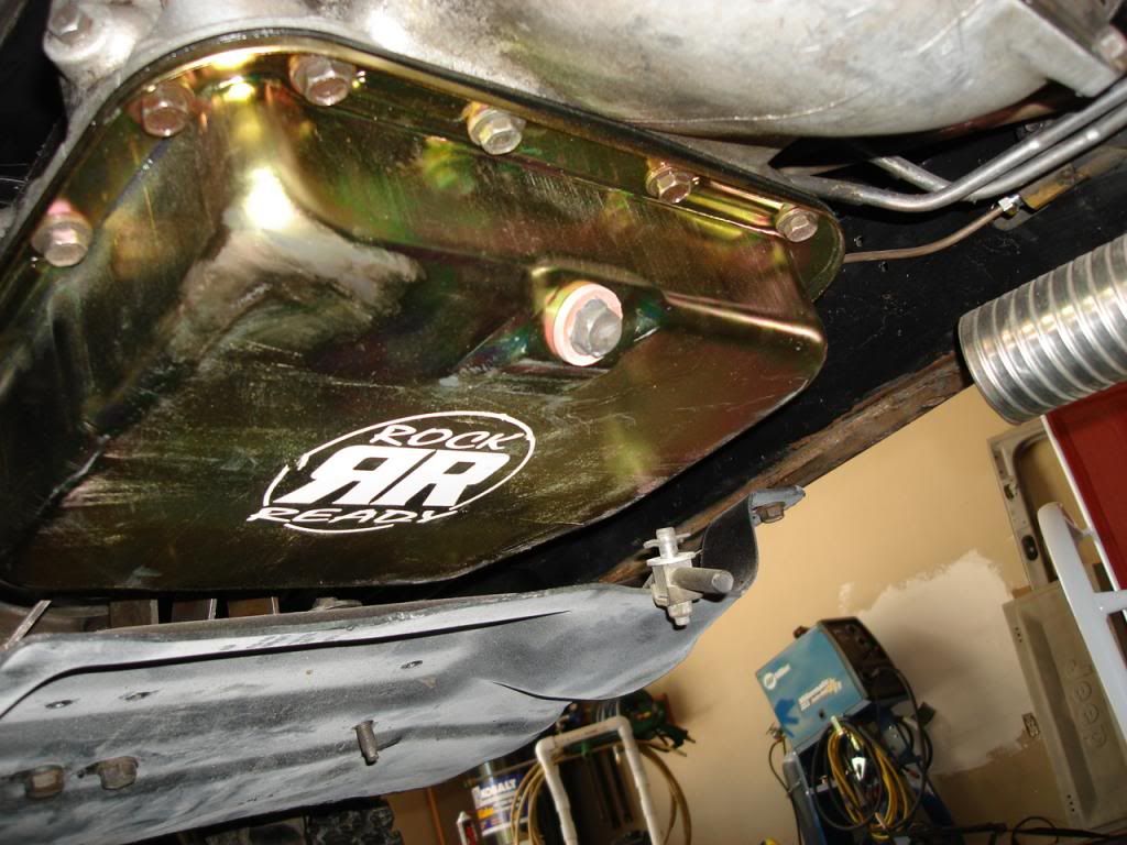

Skyjacker suspensions transmission pan
skyjacker part OPA999
150$
A
http://www.summitracing.com/parts/sja-opa999/overview/
First, the drain plug is in the front. no more fluid on the cross member. It is heavy gauge steel and i can't see bending the flange. I guess you could with enough torque but that is not the pans fault. I installed it with the pan gasket from the Dodge dealer. ( I CAN NOT RECOMMEND THIS ENOUGH). Do not waste your time with anything else. the dealer gasket was 20$??? can't remember, but even if it were 40 it would be a bargain.
