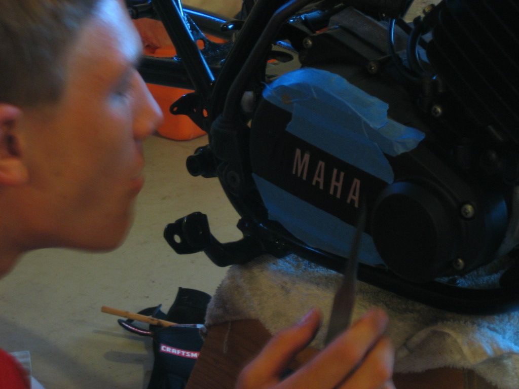

I've painted many a thing that was made of aluminum. The key is to "pickle" the aluminum before painting. I think I used straight white vinegar back in the day before painting but mostly do powder coating now on aluminum.
Paint right over your raised letters and when the paint dries, use a wide flat bastard file to remove the paint and allow the letters to shine through. I did that on my powder coated valve cover on my Jeep this way and many other projects in the past using that method.
Here's a few pics of my son doing a high school project of restoring our old 1980 Yamaha dirt bike and using the file method on the raised letters. This was about 10 years ago.
