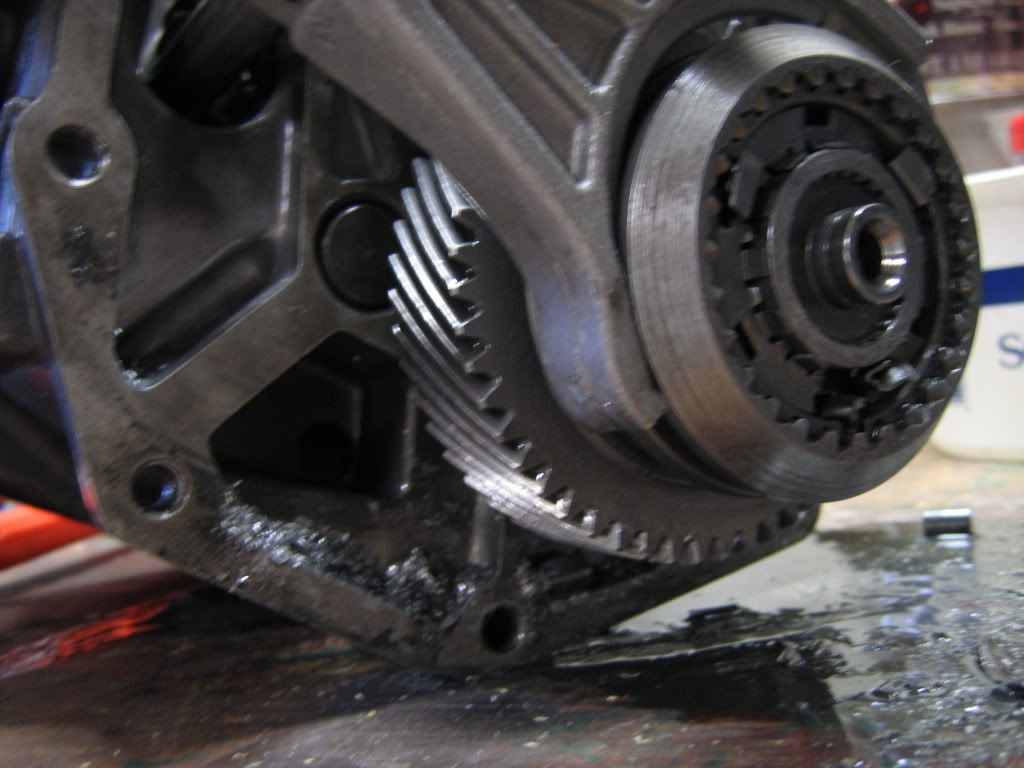

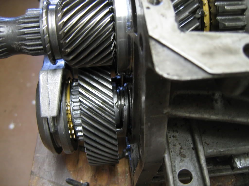

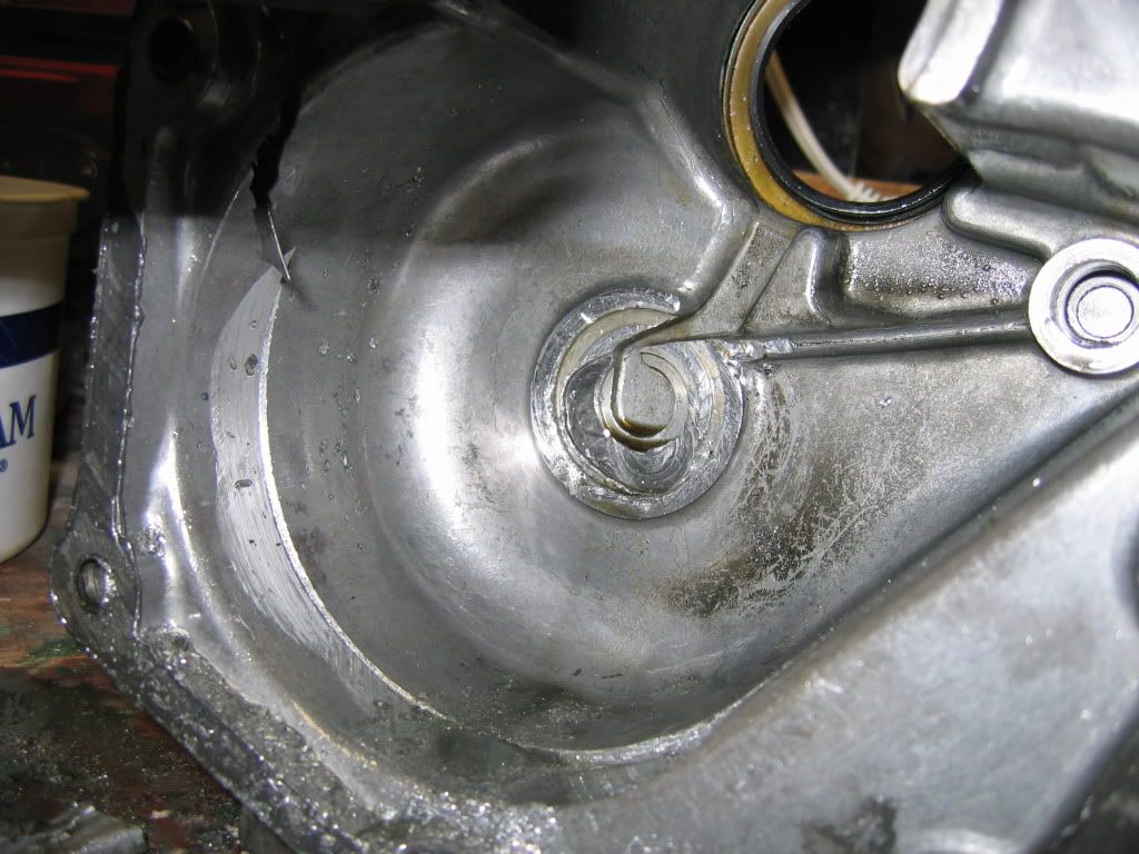

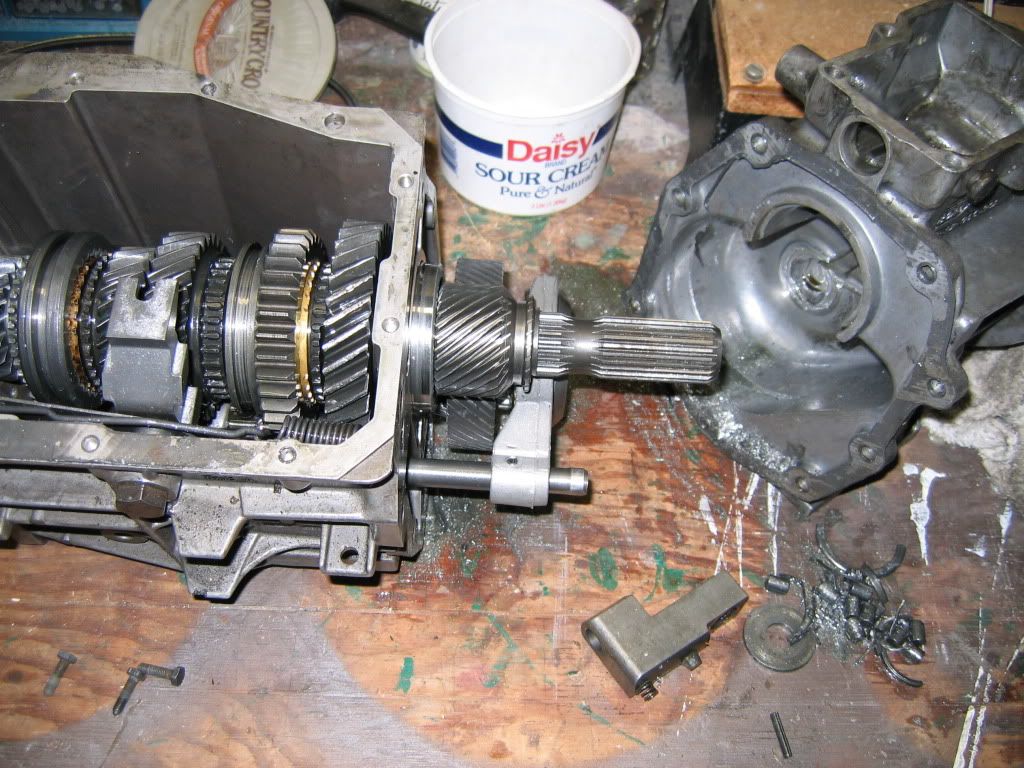

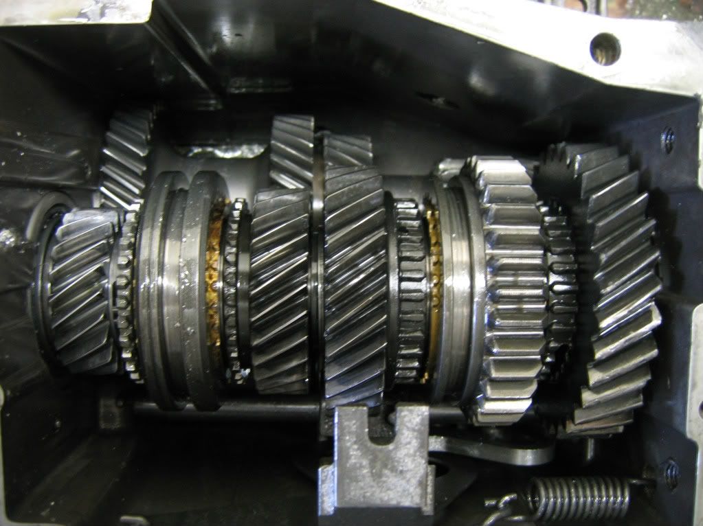

Decided to take a look inside. Pulled the tailhousing off and roller bearings and other bits and pieces fell out.
Inside the tailhousing.
A piece of what appears to be the 5th gear shift fork was broken off. The third pic shows a damaged bearing in that area close to the case. Crappy pics I know.
Heres a pic of the inside. Not much damage I can see in here besides some teeth on the gear at the far right which is the rear of the case.
What is strange is, I was having trouble getting in 1st. Had not driven it fast enough to get up to 5th yet. Can anyone with experience with these tell me how bad it looks or what might be involved?

Bearing and 'Rebuild' kit, not horribly expensive.
Cluster shaft bearing gave up. Not usual.
Check NOVAK web site,
Link: http://www.novak-adapt.com/knowledge/t4_t5.htm
T-5 is so weak I would consider replacing it, since it's just going to do this again...
Check the link posted for recommendations.
I don't know if it's the angle of the camera, flash or what,
But some of your gears look like they have been overheated in the pictures.
(Could be my monitor too)
This thing ever been ran low on lubricant?
Towed something REALLY HEAVY?

Depends on the hard parts of the cluster where the bearings failed.
If there is a lot of hard part damage, then you will spend more on replacements that the transmission is worth.
High quality replacment parts are EXPENSIVE.
And you haven't dug into the transmission completely yet, you don't know what else is hiding in there,

The amount of steel shavings at the bottom of the case are a good indication of how much has been worn off it. Those teeth also do not look so good. You could repair it and buy new bits and put it all back together but you have it out already and it is not the strongest box. Up to you, it would be easier to rebuild it and you could do that quickly and have the jeep back on the road.
Plenty of choice of Jeep boxes out there which will fit apart from a T5 or you can go for something a bit stronger and spend a bit more. Jeephammer gave the Novak website address, very informative on relative strengths and applications. If you went standard Jeep you could get all the parts you need from a scrapped one at relatively little cost and there is plenty of debate on here as to which are the good ones.
For instance the T176 is a medium duty 4 speed fitted to your year behind the I6 and would be long lived and easy to fit. I have one on an 84 and it is fine, shifts well and is reliable.
I would not personally bother with a 5 speed box unless I had an application for it, the 4 speed is plenty for most uses as the 258 is quite flexible but then I do not have a highway here where we can get up to high speeds for long distances.
