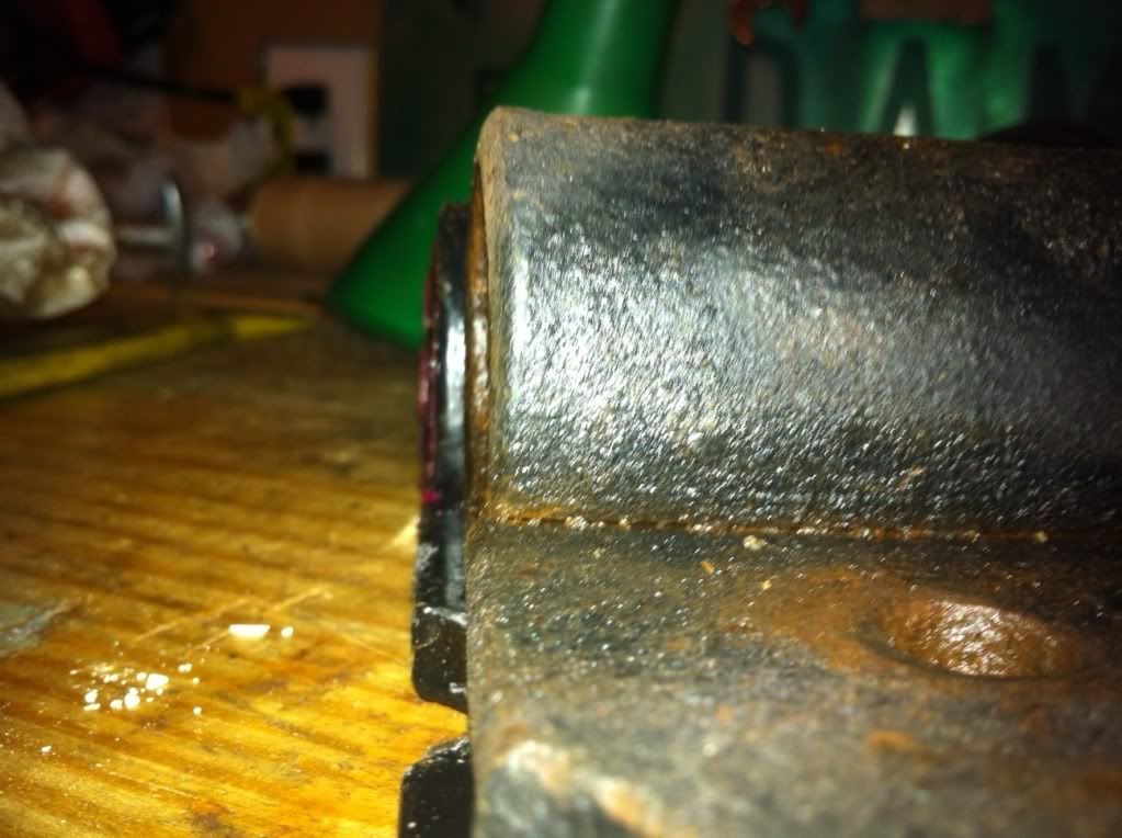

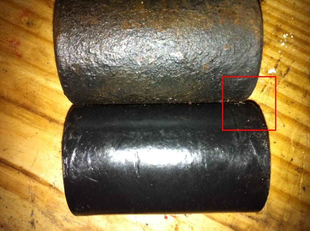

I ordered a new rear shackle hanger off ebay the other day to replace a broken one (see picture below). After having trouble with the install, I stopped and compared the old and new hangers. It turns out the old hanger is 2 7/16" wide
while the new hanger is 2 5/8". With the bushings in the new hanger, there is now way the shackle will fit.
Anyone else have this problem? I didn't find anything after searching the forums and the google.

Old vs new rear hanger

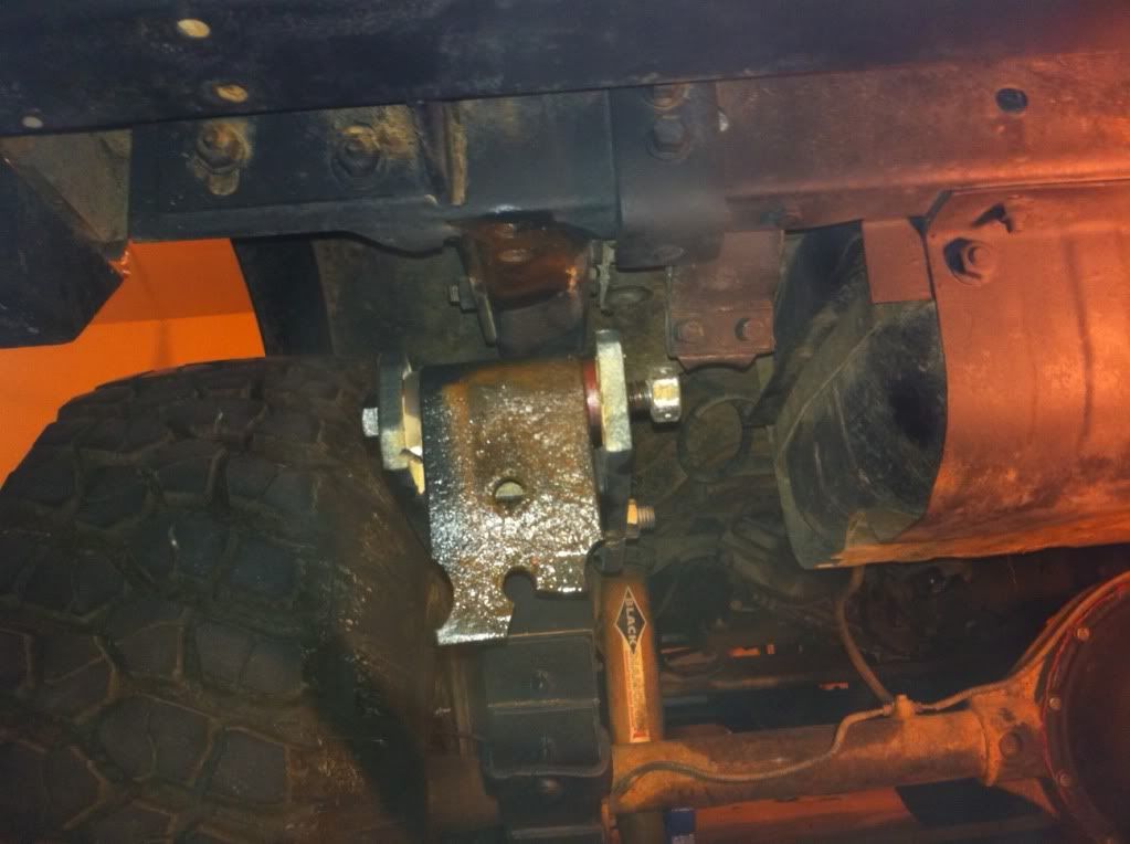

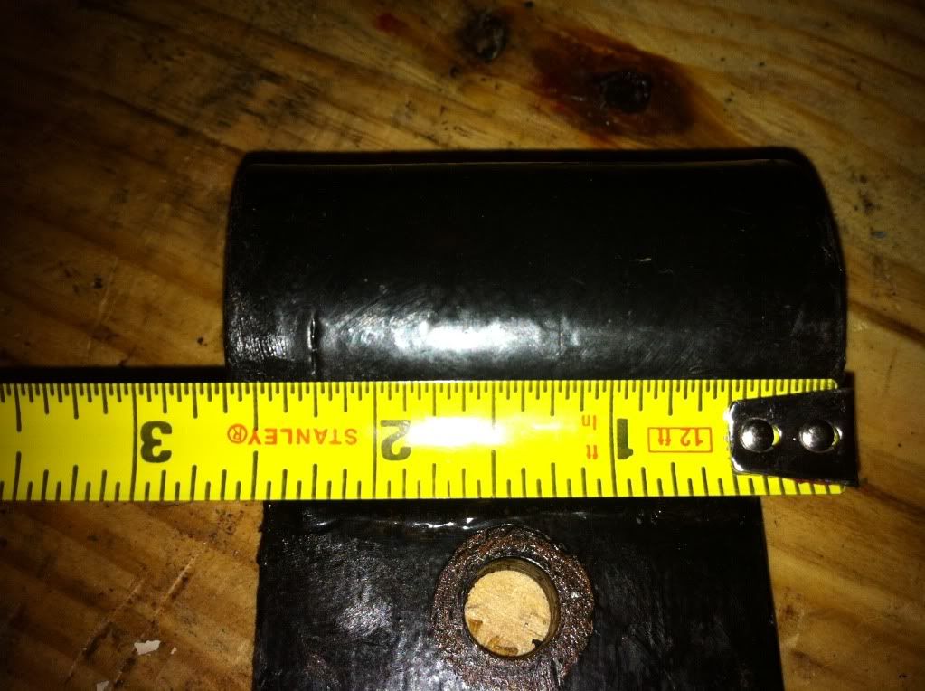

I measured again, just to make sure (picture below). I doubt this would be a problem for shackles like Keith has. Mine have the welded piece in the center like the Warrior shackles in the last picture below.
I will say, I have a Rugged Ridge steering box mount, steering box brace, and a few other parts. They all fit without a problem. Rugged Ridge often has the nice combination of quality and price. I don't consider them to be crappy. The original design of these hanger seems to be the problem, and that's why I'm going with the Crabtree (already ordered them).
Thanks for all the replies!
2 5/8" wide

My type of shackle
