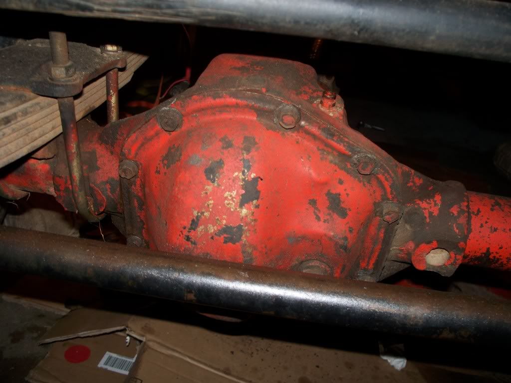

The axles are from a Ford Bronco, or at least if they were originally together, they are. The front is a Dana 44, no idea what is inside yet though it is most likely stock. The rear is a Ford 9-inch rear. Also, don't know whats inside.
The springs are on top of the axles, and there are ridiculously sized shackles front and rear. Yes, I do plan to remove them and use something much shorter and sturdy.

This is the Ford 9-inch rear:
