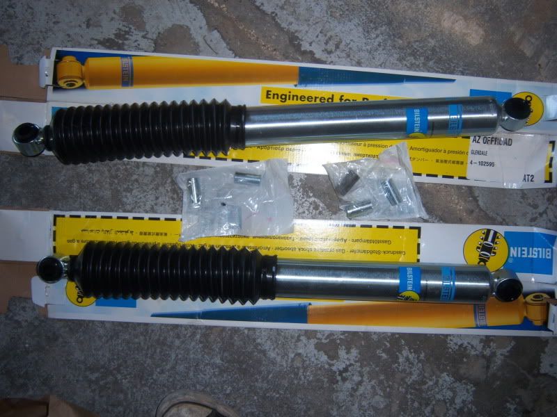

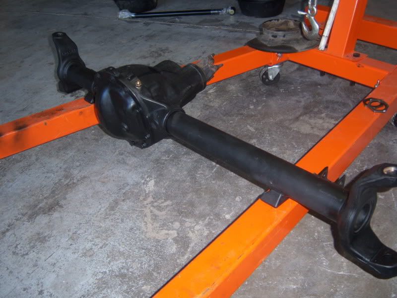

a few more items
Just a few more items to post up. The shocks and kit are in and front axle is getting cleaned up as well. That is just a coat of primer on the axle. The old bolts in the diff cover will also be replaced with zinc coated bolts to match the fresh D44 rear end.
