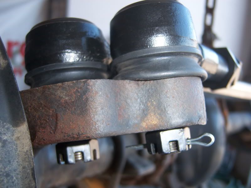

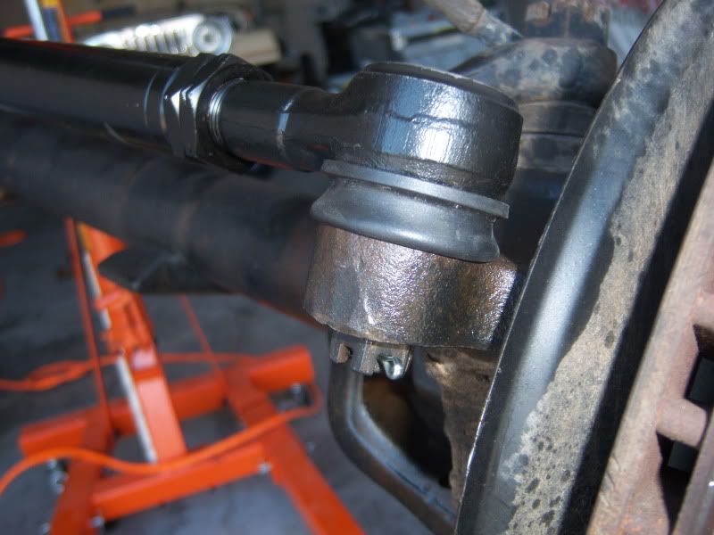

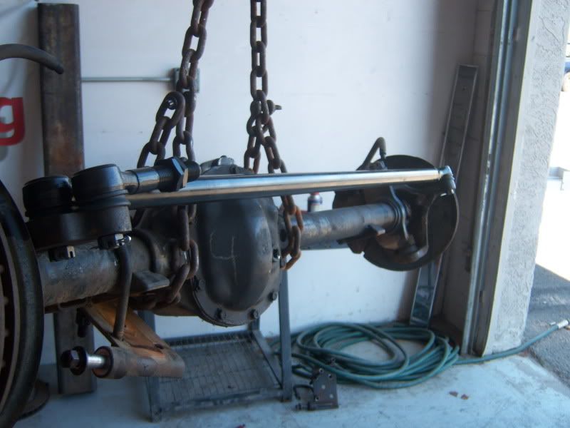

Uhh...its getting the OME lift done, HD tie rod and drag link flip, and HD steering box brace. Having the front axle stripped down and re-painted while its out as well.

Yeah....will be running a new stabilizer as well. You can buy the flip kit from ok4wd. It comes with the 3 sleeves for the bottom part of the hole for the TR and DL, and the reemer.

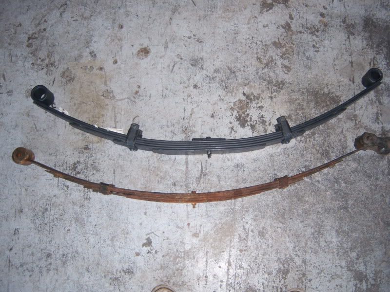

Anyway, I wanted the readers to know that my old springs sagged noticeably from the weight of the winch. When I lifted it off, the front end came up probably an inch! After the lift, when I reinstalled the winch, the front didn't move at all with the heavy OME springs. Nice!
