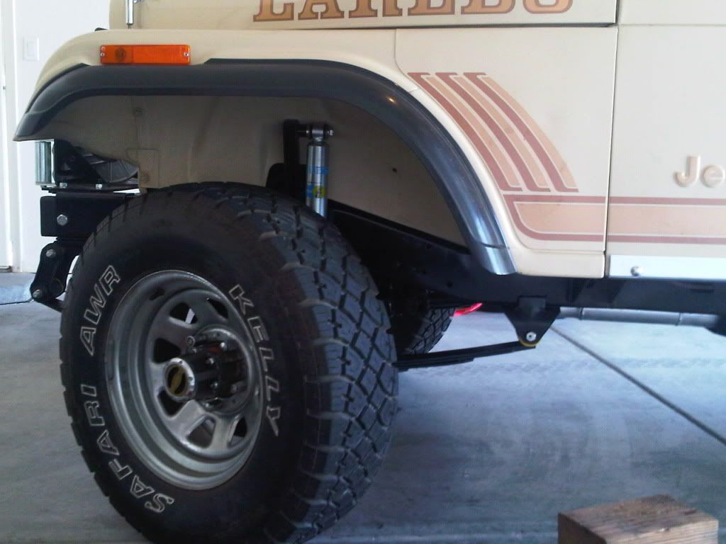

I just wanted to let you know I used Rocky Roads extended mounts on the front. The Bilsteins were a little long, so the mounts worked out perfect.
