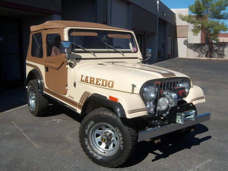

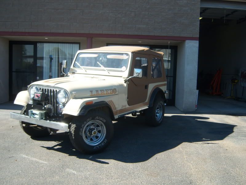

Matt....nice original paint and decal CJ you have there.....here is mine before it went under the knife for the lift....still waiting to see the end result.
I will put up pics after the lift is on for a before and after comparison.
