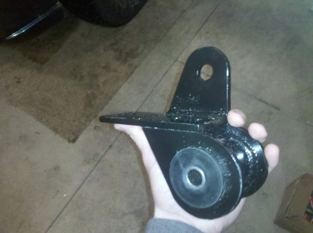

Great thread! I have the OME kit as well and will hopefully be getting around to putting my chassis together shortly. Definitely some info here that will be helpful. I've actually had my kit since about January and I've noticed a few differences between mine and the ones shown. My kit came complete with shackle hangers and new brake lines. I also didn't have any problems with the shocks, they sent the right ones. Maybe they have changed the mounts since I got my kit, but mine look like this:

Hey Jered,
Those shackle mounts look bomb-proof. But, I'm curious what that extra vertical tab is for, or how that's going to mount.
Keep us informed when you get around to the install.

From the looks of it Matt, those tabs on the side are an extra mounting point to the side of the frame. Hopefully I'll be getting on this in the next couple of weeks, so I'll post pictures when I get there.

I dug my frame out to do some work so I brought the shackle mount along to mock it.
It sets so you can bolt it to the original mounts, has a large hole so you dont have to cut the rivet off, and then another hole up front. So When these puppies are bolted up they will be held on by 4 bolts
