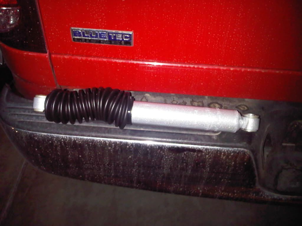

I picked up my stabilizer yesterday....the closest I could find to a Bilstein...in looks anyway...since they don't make one.

I found out that most steering dampers are simply a 50/50 valving, so there's very little difference between any of them.
That one looks awfully long, however. I hope you don't run into clearance problems with the front pumpkin.

Can you tell the length of yours fully extended?

It's the compressed length you need to worry about, since that's what allows enough travel in the shock when you turn the wheel hard right.
Mine measures about 13" eyelet center to center fully compressed. It comes within 1/4" of hitting my pumpkin when I crank the wheel full right.

My Rancho stabilizer is right about 13" fully compressed.....shouldnbe good to go. Have you checked clearance at thebrear corner of your fenders with your new BFGs?

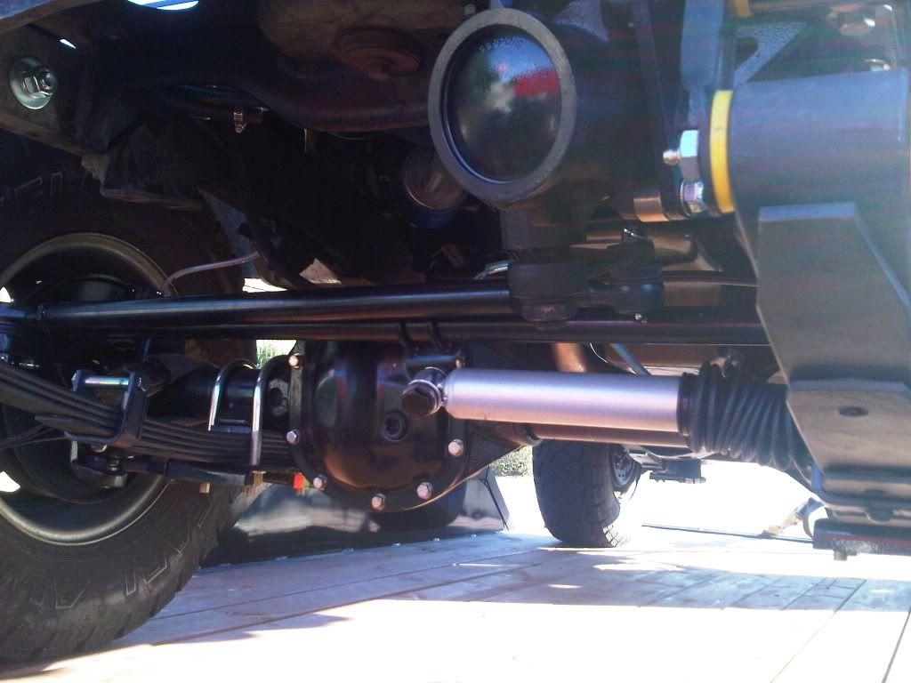

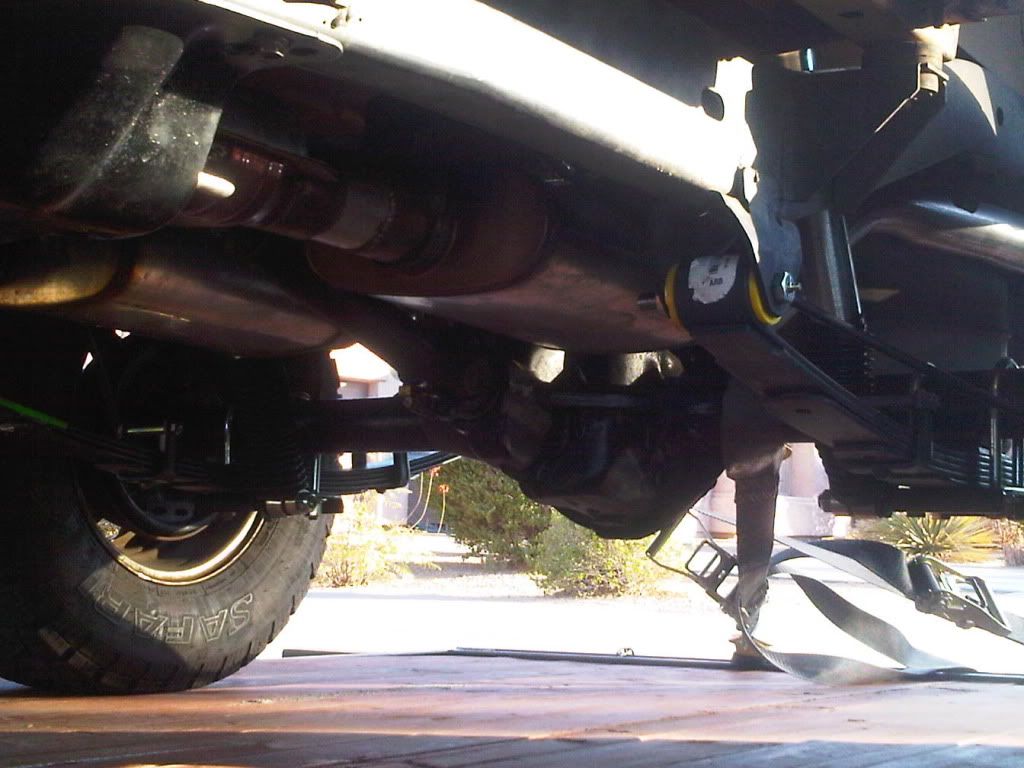

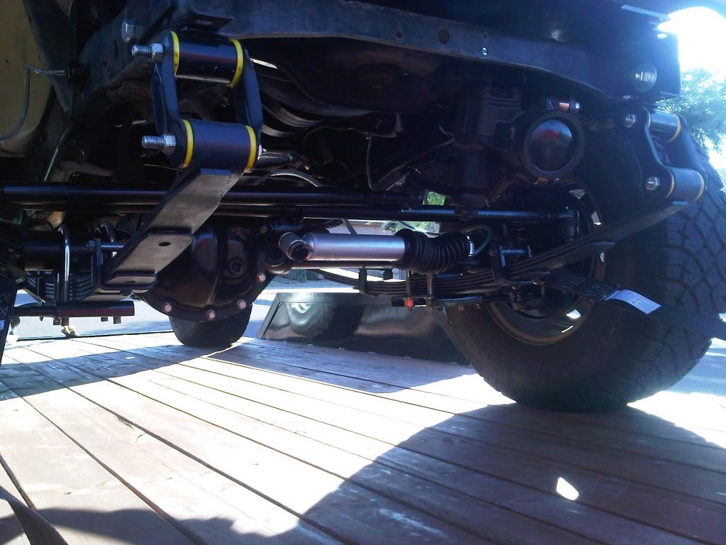

So, here are a few pics of the Jeep. I couldn"t flex it out all the way because my HD tie rod was coming into contact with the sway bar bracket on the frame. I will have to remove those to get another 2-3" of up travel in the front, which will give me a little more droop in the rear. Other than that, I had to order some front extended shock mounts from Rocky Road to let the front Bilsteins use all of their travel. I will have those this Friday. So in other words, it still has more to go..

Looks great, Tim!! But, when are you going to really flex that thing?
Post a few pics of the shock mount extensions, when your mechanic gets them on. I'm curious what they are all about.

The longer mounts should be here Friday, and I will put them on maybe Sunday. The OE ones unbolt, and the new ones bolt on where the old ones are. I haven't bought tires yet. I haven't had time to get to the shop. If you want to see what the shock mounts look like, check out Rocky Road Outfitters website. Like I said, it still had room to go.....it just couldn't because of the tie rod hitting the sway bar mount.
