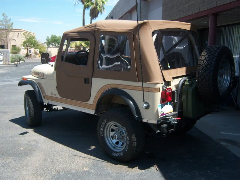

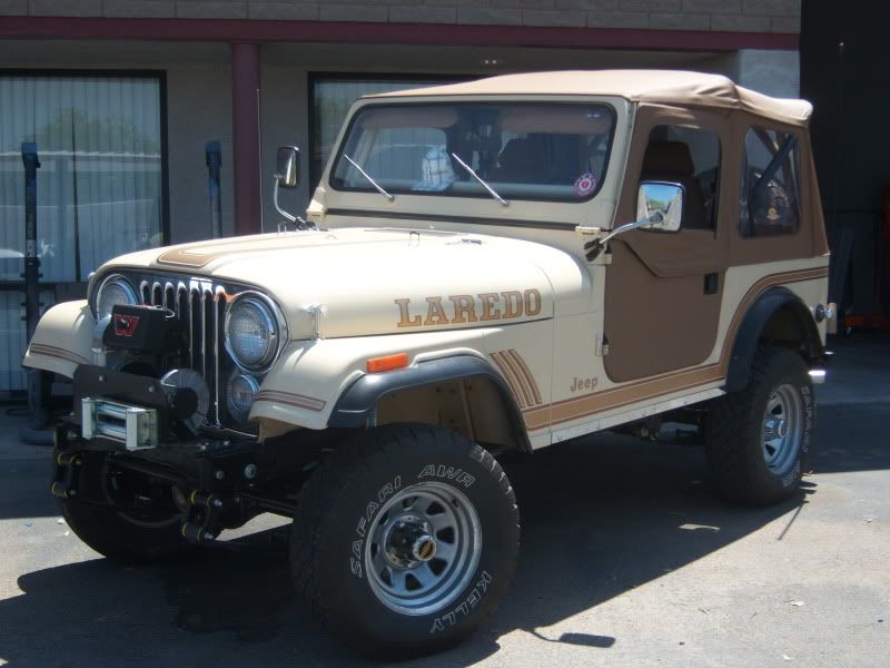

So...the lift is on...just a few things left to button up like the ARB lines, new bolts in the front diff. cover, trim the u-bolts, check alignment, steering stabilizer, etc. Kind of embarrasing on the 30" tires......but not for much longer

Looks great, Tim!! Even with the smaller tires!

Thx Rich. I decided on wheels, 16s, and either 265/75 16 KM2 or 285/75 16 KM2........so basically a 32x10.50 or a 33x11. We will see what fits.......big bump stops go against my moral and ethical beliefs

Awesome, Tim!!
The Bilstein's look bada$$. Are you going with u-bolt skid plates after you trim them?
Let's see some flex!!!

Nope....same as you....no skid plates for the u-bolts....I will get some more pics of the front end when everything is together.....and get some flex pics.
