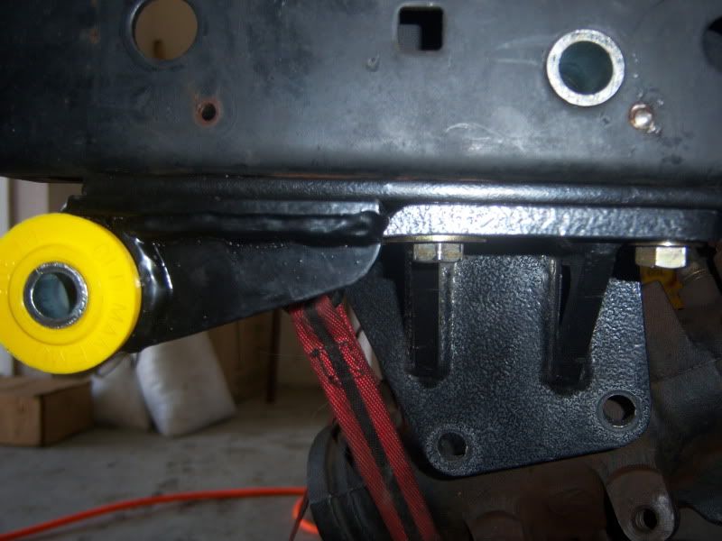

Darn, that Big Daddy brace looked sweet.
Hope you get it sold.
Matt

Did you just cut the shim, or was there other modification involved?
Matt
Matt1981CJ7 is online now
post #169 of 1071 Old 08-11-2011, 04:48 PM
85LaredoCJ7
Posts: 1,879
John trimmed up the bracket a little bit....

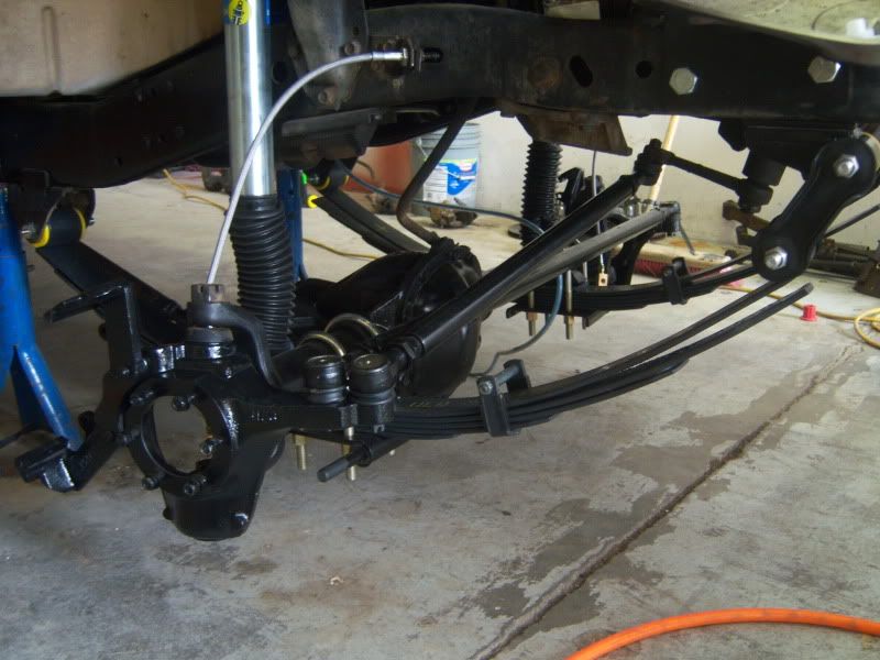

@Matt: Did you do the tie rod flip?
@Tim: Are your shocks backwards?
-boom

Rich.....nope. Per Bilstein....a mono is supposed to be mounted like that for this application. The decals on the shock is what made me question this because I have the same shocks on my Dodge CTD, and they are mounted boot-up. The boots on the CJ's shocks have drain holes, which when mounted the way they are, allow moisture drainage I suppose.
Very interesting. I just learned something new. Thanks, Tim! Looking forward to seeing the finished project!!
