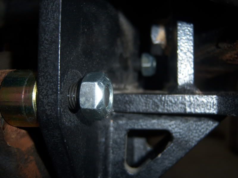

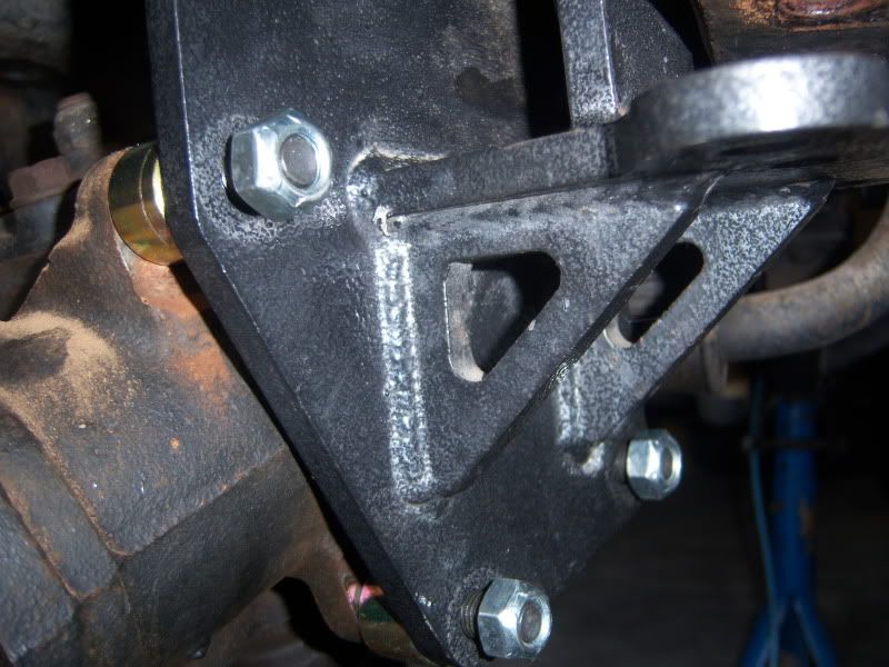

Getting the "Big Daddy" steering box bracket set up.
85LaredoCJ7 is offline

I just installed Sam's Offroad bracket a few weeks back and I swear my steering seems that much tighter...a great upgrade that will eventually need to be done

85LaredoCJ7,
Dang, you're on a mission to make me pull that heavy-a$$ winch, again, aren't you?
Adding to my list of "desired, but not crucial" items.......
