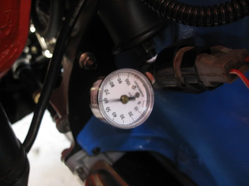

A good feature is to add an additional Oil Pressure Gauge right at the engine block so you know what kind of pressure you have at a glance. I bought a small glycerin filled gauge from McMaster-Carr.com. The one in the photo is not liquid filled and was shortly changed out with one that is.

Keith,
Where did you attach?
rosco3059 is offline

Attach what? The pressure gauge?
Yes, the pressure gauge

I had to remove the pipe fitting and drill and tap another 1/8 NPT for the gauge.
Used the existing pipe fitting as a pilot hole guide for centering while drilling. Then flipped the block around and finished drilling with the correct size drill for taping the 1/8" NPT.
Then tapped it to a 1/8" NPT.
Installed back in the engine block.
