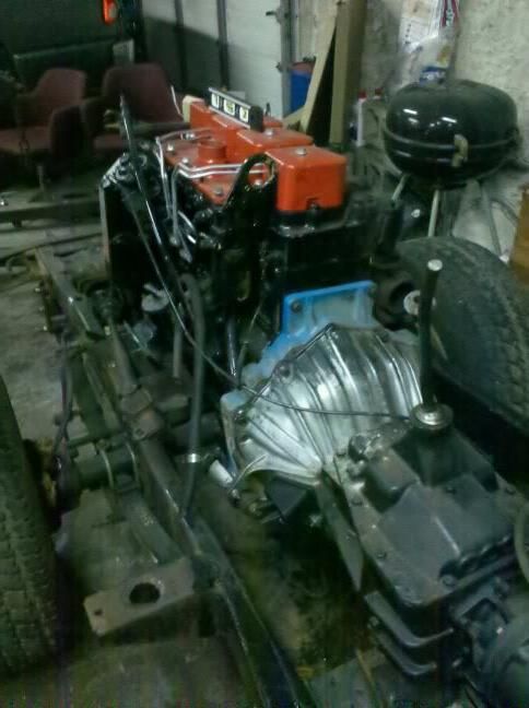

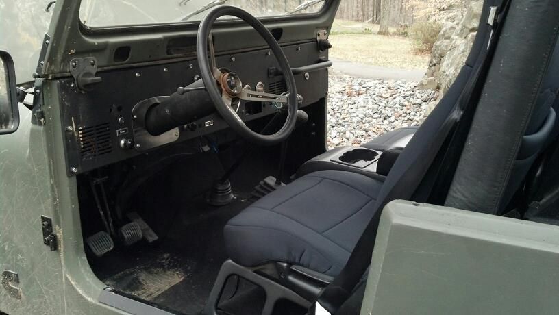

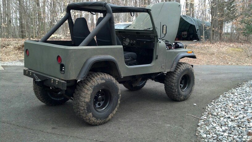

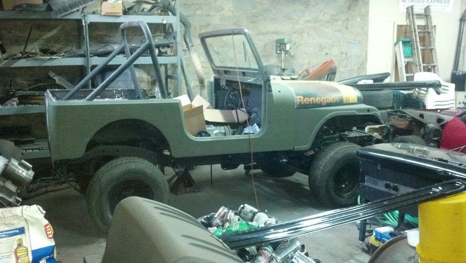

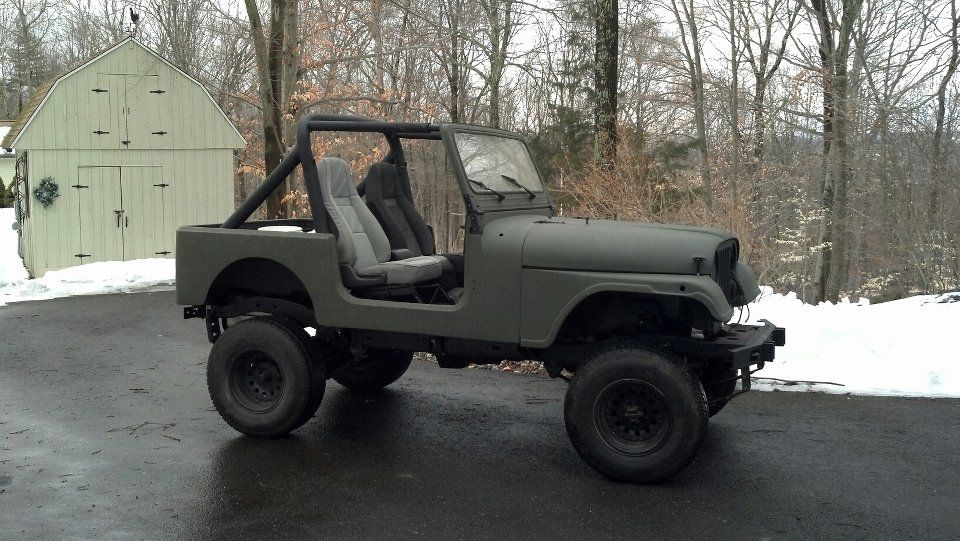

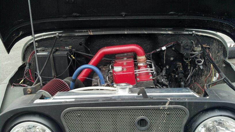

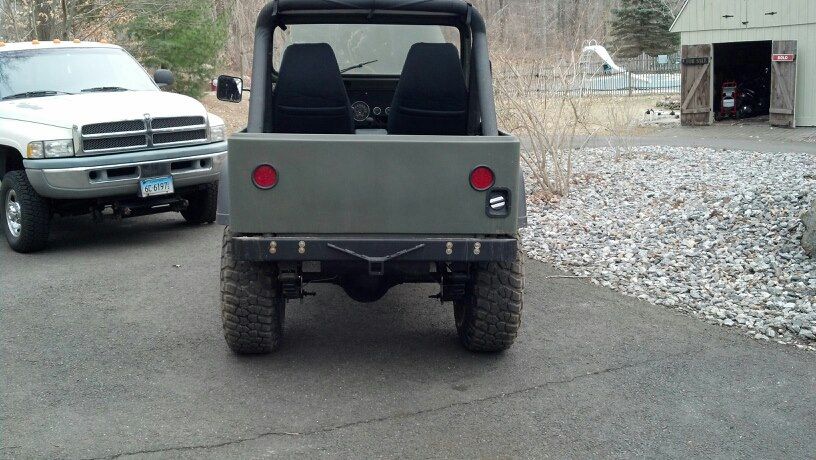

Well my 4bt CJ is just about done. Just waiting on a few more minor parts to show up. Been driving around and pretty much all the bugs are worked out of it. Specs are as follows..
105hp Cummins 4bt
SM465 4 speed
Dana 300
Aluminum radiator with dual electric fans
4inch suspension lift
1 inch body lift
Fiberglass tub
yj roll bar
35x12.5x15 KM2s
Black rock wheels
Has dana 30 and amc 20 with 4.10s for now. New axles are in the works.
Few pics of build
1985 CJ7. Cummins 4BT, SM465, Dana 300. 4inch lift. Fiberglass tub.

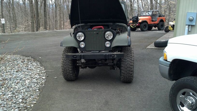

Took a few more pics today.
rdorman011 likes this.

Looks awesome. by the way what motor mounts did you use?
92 YJ 4.3L Vortec SM-465/NP241.
80 CJ-7 4.5BT Cumminns Diesel still in building stage.
Dre40 is offline
post #266 of 320 Old 04-01-2013, 03:10 AM
04Xmatt
Location: torrington, ct
Posts: 42
Bought liquid isolaters and fabricated the mounts myself.
04Xmatt is offline
post #267 of 320 Old 04-01-2013, 06:15 AM
Dre40
Location: Ellenton, FL
Posts: 634
Do you happen to have a part # or where did you get them? thanks

04Xmatt
Posts: 42
Bought them from a guy on www.4btswaps.com. I'm pretty sure they are 1st generation dodge cummins mounts.
