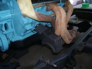

mike4089
Join Date: Oct 2005
Posts: 292
well i did this swap over the winter and this is the first big big project i have ever done...went fairly smooth thanks to some help from some friends...here are some pic
