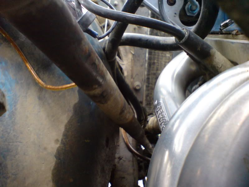

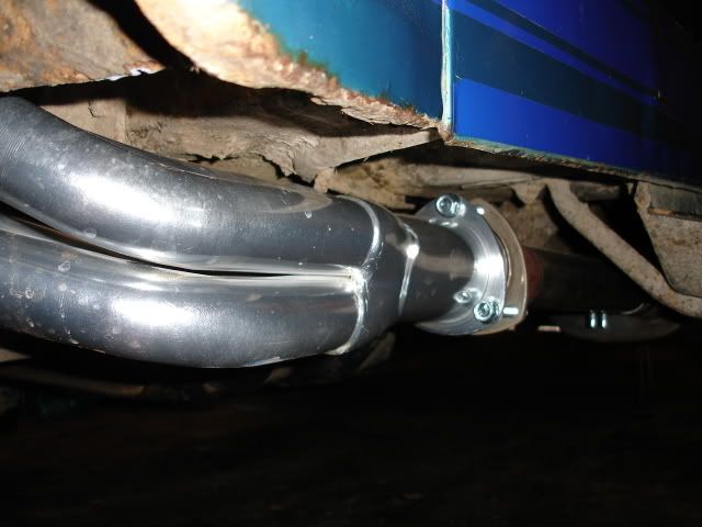

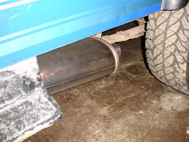

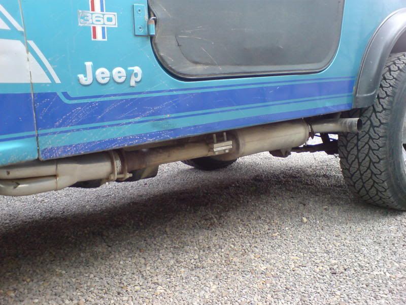

Originally Posted by Dropkick_pride
amc 258 and 304, 360, and 401 will all drop in and connect to your trans.
I would love to hear some more about the exhaust routing and possible problems with manifolds/headers and different trannies.
Easiest option:
Hope fully in the next couple of weeks it's off to the exhaust centre to get it welded and exiting infront of the wheels, then around the corner to get it tuned up then finally it's off to the hills for a beating.
Pilot bushings I'm afraid I bought all three and compared which one fitted best.
Distributors I'd already purchased a MSD setup which replaced everything including the dizzy, but IMO it's an ideal time to swap to a HEI setup.
Mounts I couldn't really work out which bit I needed to replace and as shipping takes 6 days to 2 weeks I played it safe and bought some MORE mounts which with the exchange rate cost £130 over here and were really easy to install.
Bellhousing I've got a 176 tranny so it bolted straight up to it but I replaced the clutch release bearing while it was easy to get at.
'86 cj7, 360 cui, msd ignition, hedman htc's and still upgrading
marmaduke is offline

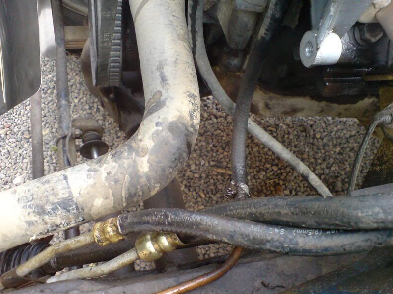

Originally Posted by Jeepcreep927
I don't believe the 2 core radiotors are enough to cool an 8. I tried one and there was no mistake about it running hot. It was a new radiator and everything was flowing, just not enough surface area to cool properly. I used a heavy duty 3 core (stock replacement from AutoZone) in my 360 swap, and it works fine. Still tossing around thoughts on fans.
I run my original 258 2 core fan with a Flexalite 18" Performance fan and it NEVER over heats, as for header clearances and fuel lines I'll try and get some pics on later, I swapped from a 258 though so I had to re-route the fuel line from the other side of the engine bay.

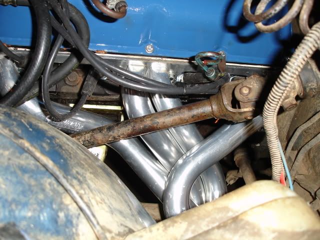

[QUOTE=cromd]
Originally Posted by marmaduke
Easiest option:
How close is your steering shaft to that header. I have the same setup and the shaft actually rubs the header that is closet to the front of the vehicle. Not sure what I can do about it.
Slightly better pics:
No clearance issues and as they 're fenderwell headers and the fuel lines run inside the chassis they are no where near the header either
