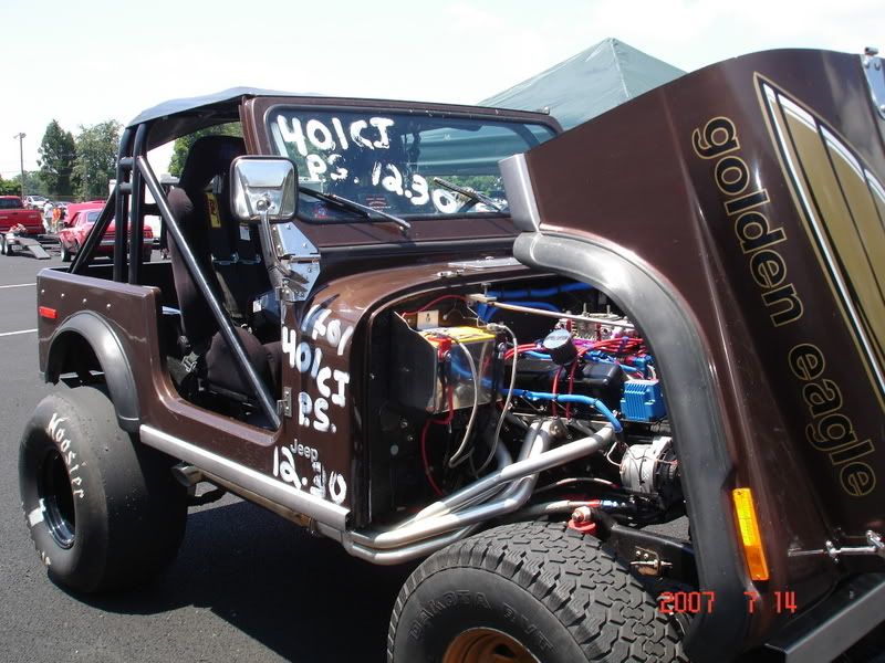

Originally Posted by fuzz401 View Post
these are fenderwell headers
fuzz401,
How does this exhaust setup work on the street? I guess what I'm getting at is does the cab suck a lot of fumes in with the top off with the exhaust dumped in front of the rear tires? I like the simplicity of dumping it there but if it affects cab air quality I suppose it's best to send it behind the rear tires.
Thx for looking.

I have never realy had a problem with fumes - if you sit idaling a lot you get some but driving never noticed it with or with out a hard top

I've never had any problems with fumes from my side pipes either. like fuzz said, sometimes you can smell it a little if it's idling for a while

Can anyone post a picture of the fenderwell headers from underneath? I looked under mine today and can't believe they will fit without cutting the front fenderwells. Maybe I'm missing something, but a picture sure would help. Or you can email it to me to keep it off the forum at noneck@noneckschevelle.com Thanks!!

you have to cut the small flat spots on the bott of the fenders and move the brace on the fender

I think I see the flat spots to trim on the fenderwells,any pics to show the bracket change?
