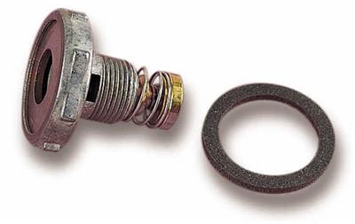

Spring Loaded Needle & Seat!
These are even called 'Off Road' needle & seat valves, but buttheads simply will not spring for the few bucks and 5 minutes it takes to install them,
they would rather b!tch about the 'Holley'...
They would rather fix blame than fix problems!
Cost, about $22, Holley p/n 6-513
http://store.summitracing.com/partde...5&autoview=sku
Spring loaded inlet valve keeps the valve/float from 'Bouncing' the valve open and flooding the carb.

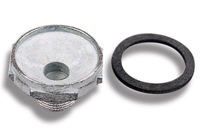

Serious off roaders running Holley even take the power valve completely out and use a plug, jetting up a little to compensate for loss of power valve enrichment...
I don't recommend this if you are going to drive this vehicle on the street at all!
Power Valve Plug, Holley p/n 26-36 , $4.50

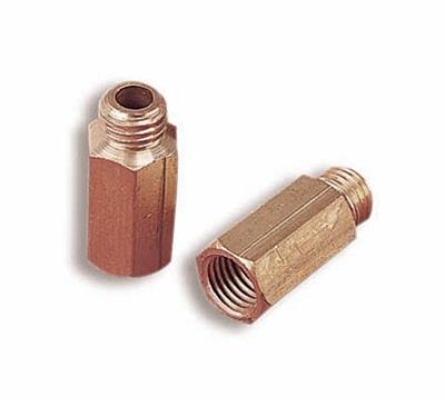

Main Jet extensions... Cost about $8.
Move the jets away from the valve body to the center of the float bowl where they are less likely to suck air instead of fuel.
Keeps you from 'Sucking Air' on extreme Pitch (nose Up/Down) grades.

The biggest problem we have with Holleys is power valves, and 15 minutes with a vacuum gauge will eliminate 90% of those problems!
Power valve 1 InHg to 1.5 InHg below your 'Part Throttle Cruise' vacuum reading if you are 'Hot Rodding'...
Lets the enrichment come 'IN' right away when you 'Goose' the throttle.
2 InHg to 2.5 InHg below your 'Part Throttle Cruise' vacuum reading when you are off roading the vehicle some,
This keeps the Power Valve closed when you are at idle, and just trying to 'Goose' the throttle to 'Finesse' an obstacle... So the vehicle doesn't 'Load Up' or 'Flood Out'...
(rock crawlers and rock racers don't 'Finesse' anything!)
You still want that power valve working if you drive on the street!
That is a REAL FUEL SAVER when you are on the street, and doesn't do a bad job on trail rides keeping the fuel consumption at reasonable levels!
Plug the Power Valve and jet up the carb to compensate if you are ONLY off roading at serious angles all the time...
Rock Racers don't care about 'Finesse' or 'Fuel Mileage', so they can do without it.
