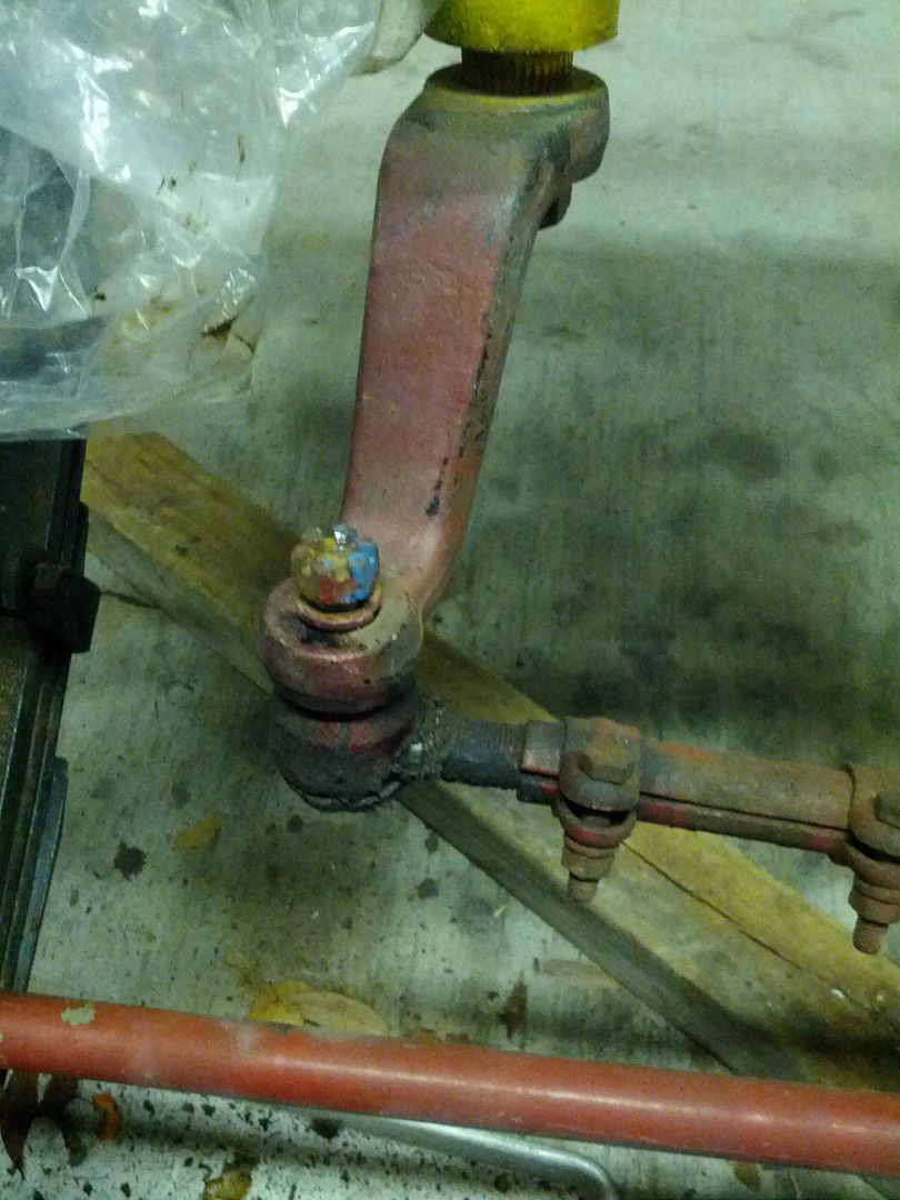

I have a bit more time yesterday and pulled a few more items off the old roller in the car port. Removed the sway bar, steering stabilizer, and all the shocks. not too much left on the frame, just need to remove the steering box and the attached steering arm and rod. of which has presented some difficulty for me. I've remove the nuts from the bolt holding this steering rod but cannot seem to get the bolts to come out. in the pics below I've only loosely returned the nuts so not to loose them. I even tried to persuade them with a 3lb hand sledge and they didn't budge. any pointers on how I can get these two out? (note: I'm not trying to remove the pitman arm from the steering box, just the rod from the pitman arm, i think they are the tie rod ends) My goal is get the frame with axles still attached to my cousin's shop by this weekend. weather is looking up to get the powder coating work done.

I think i just found my own answer.. they make a tool called a tie rod puller, hmmmm... imagine that.

you need 2ea. 3# hammers....
Thar dropped pitman arm sure lines up the geometry, too bad it increases the turning radius.

Well, I got the tie rod ends off the pitman arm and steering knuckle today, was short work with the right tool, used the pickle fork wedge tool and a 5lb hammer - 3 whacks and they popped right off. Also removed the motor mount brackets and loaded her on the trailer to haul to my cousins shop tomorrow for a blast and powder-coat. Left it as a roller at this point for ease of movement. Felt like a major way-point for me. I think for the most part I am finally done tearing apart and will soon be putting back together Gotta say it, with no prior experience a jeep comes apart pretty darn easy. hope it all goes back as easy....
