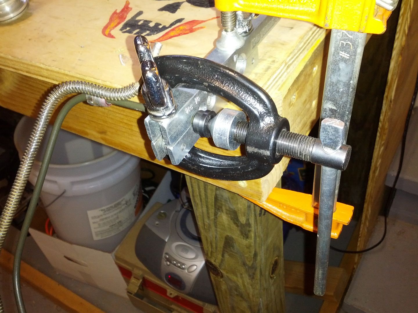

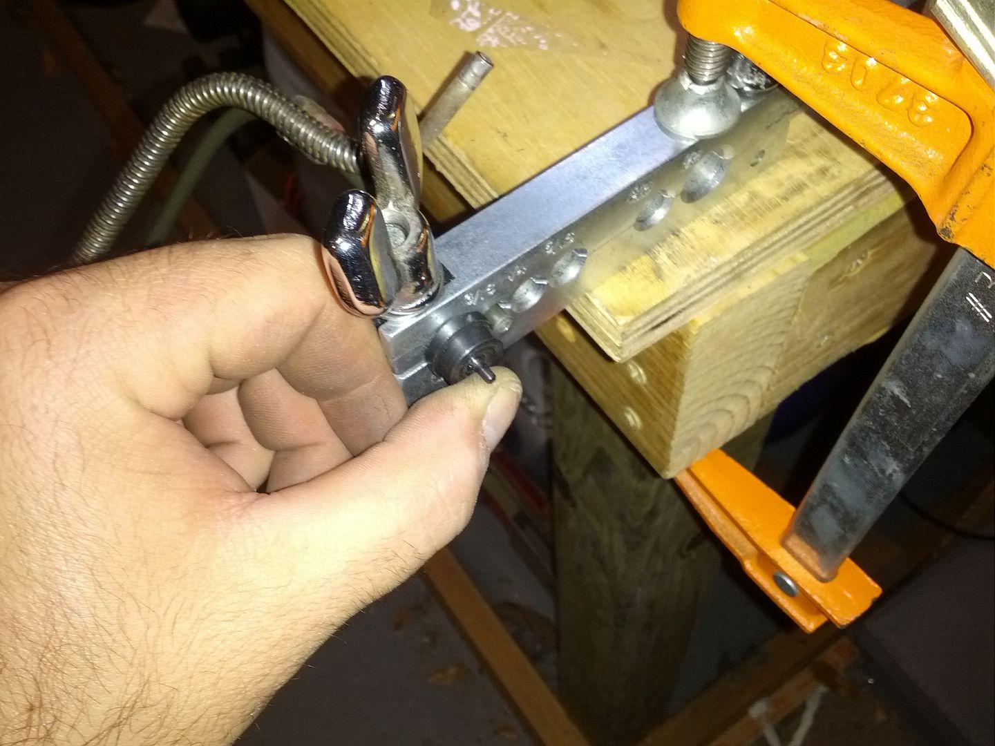

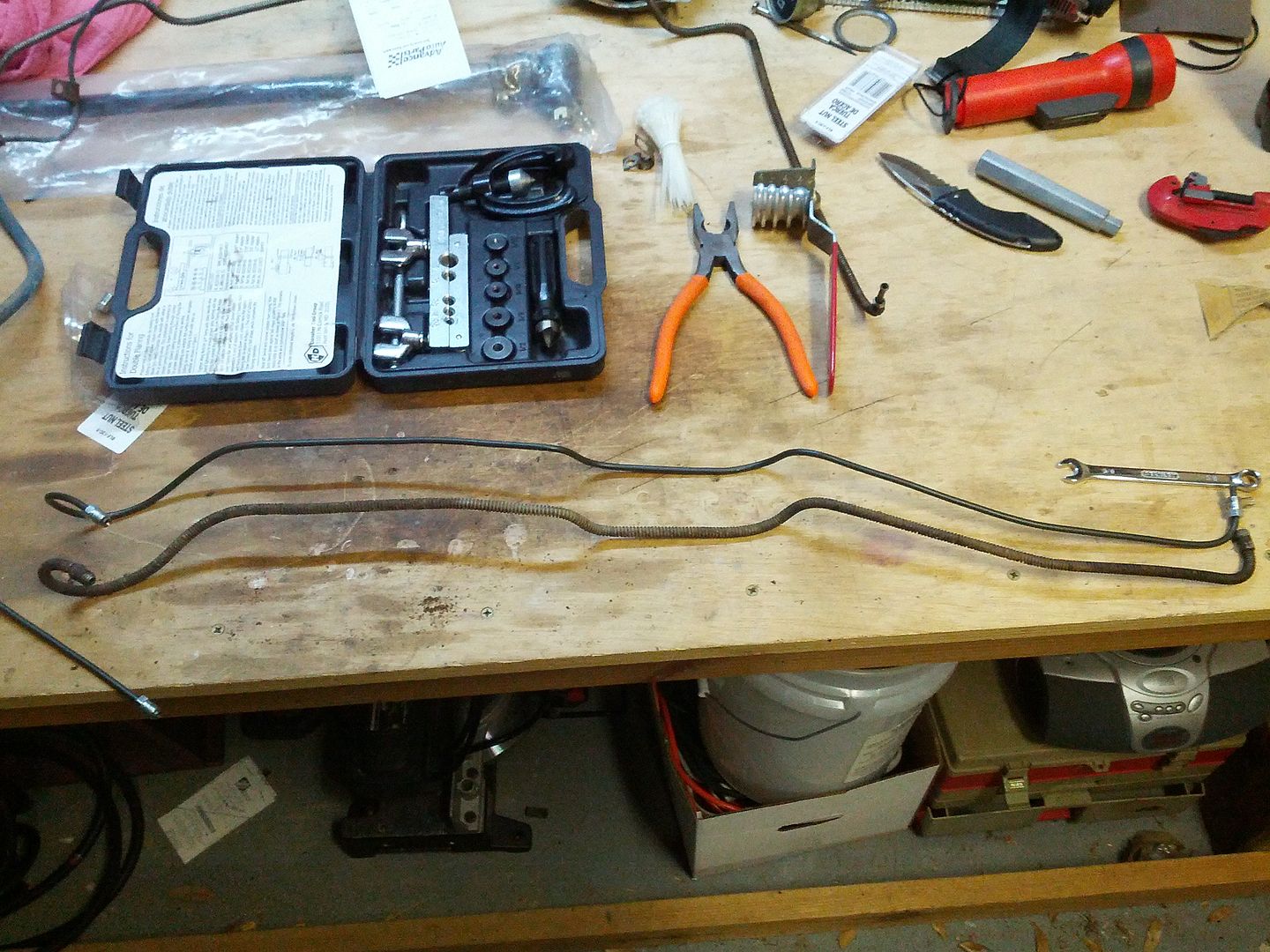

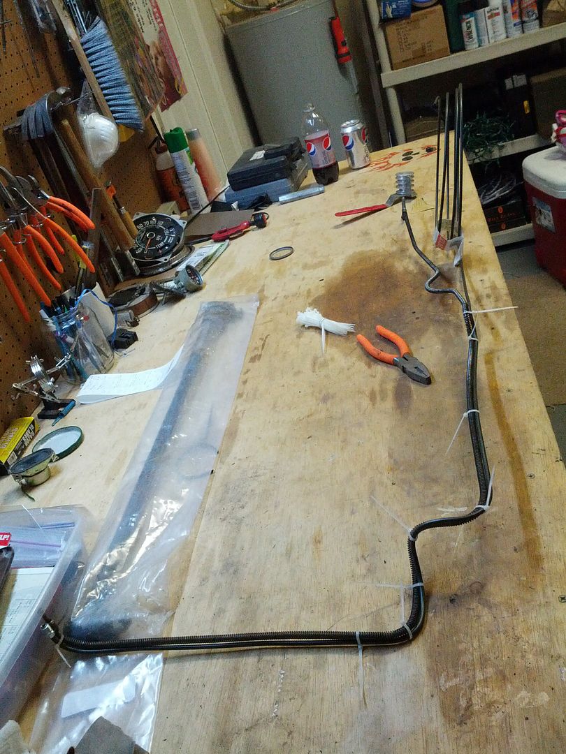

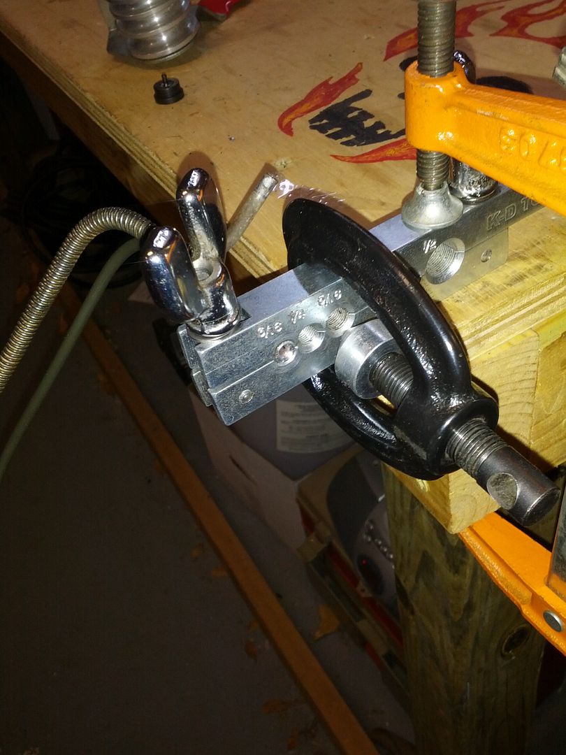

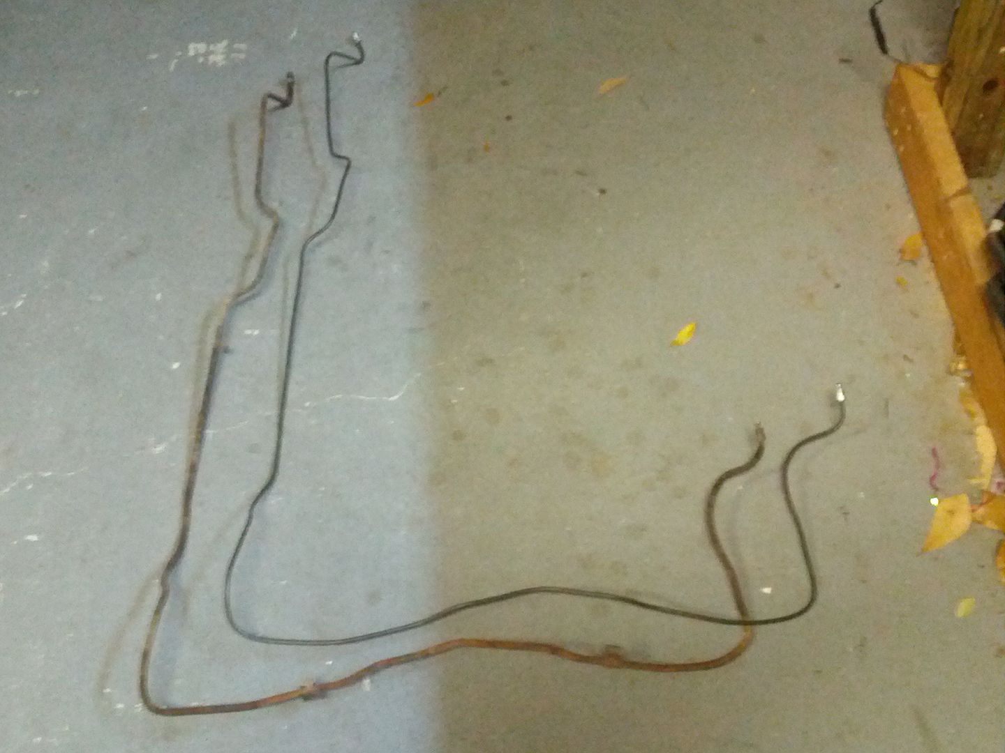

Tonight I took on the take of brake lines... Picked up a 25' roll of the Poly-Armour PVF Steel Brake Line and the 3/8" 24 brake line nuts/fittings. Borrowed a friends tube bender, cutter, and double flaring kit. Then proceeded to bend me some tubing. There is a little be of a learning curve to it but it is not to hard to do. most of the line i was able to thumb bend without crimping the line. also learned a trick, i zip tied the old line to the new as i bent it this kept it in form and help me identify where i needed to do little tweaks at the end and ensures a near prefect duplicate bend each time.
also please note the the cost benefit of beginning your own line far out ways the time and effort learning to do it your self, saved over $200 bending the line at home vs. the prevent kits. Which is good, as I think my shocks are shot... compressed all four of then all the way last night and still fully compressed tonight... ahh they were looking pretty rough to boot..

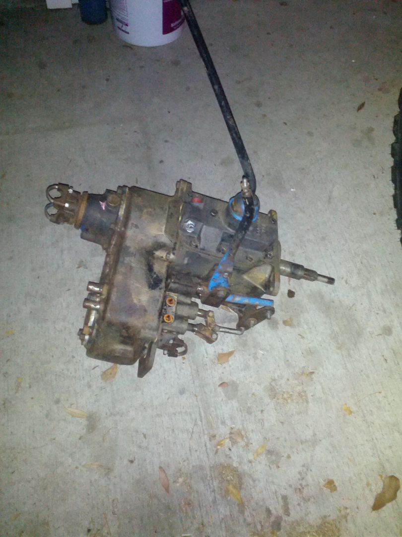

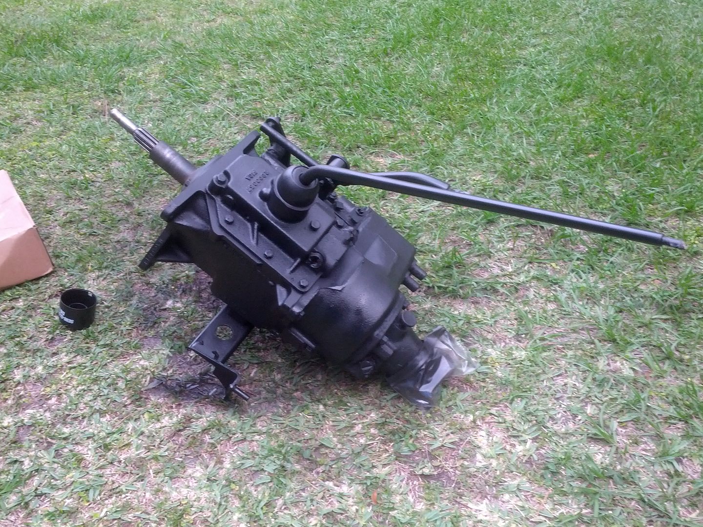

Rebuilt the T150 (seals, bearings, gaskets, new fluid, and new back up light switch). Blasted it and repainted the transmission, transfer case, and bellhouseing nice pretty black.
Reinstalled the clutch to the flywheel
Then today I, Reinstalled the I6-258, T150, and D20 back into the nice shiny frame had to take a moment to cherish the moment, the motor has been out for quite some time and seeing it back in place felt real good. Over the next few weeks I plan to get all the accessories put back in place. Starter, exhaust, fan, and pulleys. Also going to get serious about the body work this week too. going to check out the current status of the tube and start the body filling process to get her all nice and strait again.
