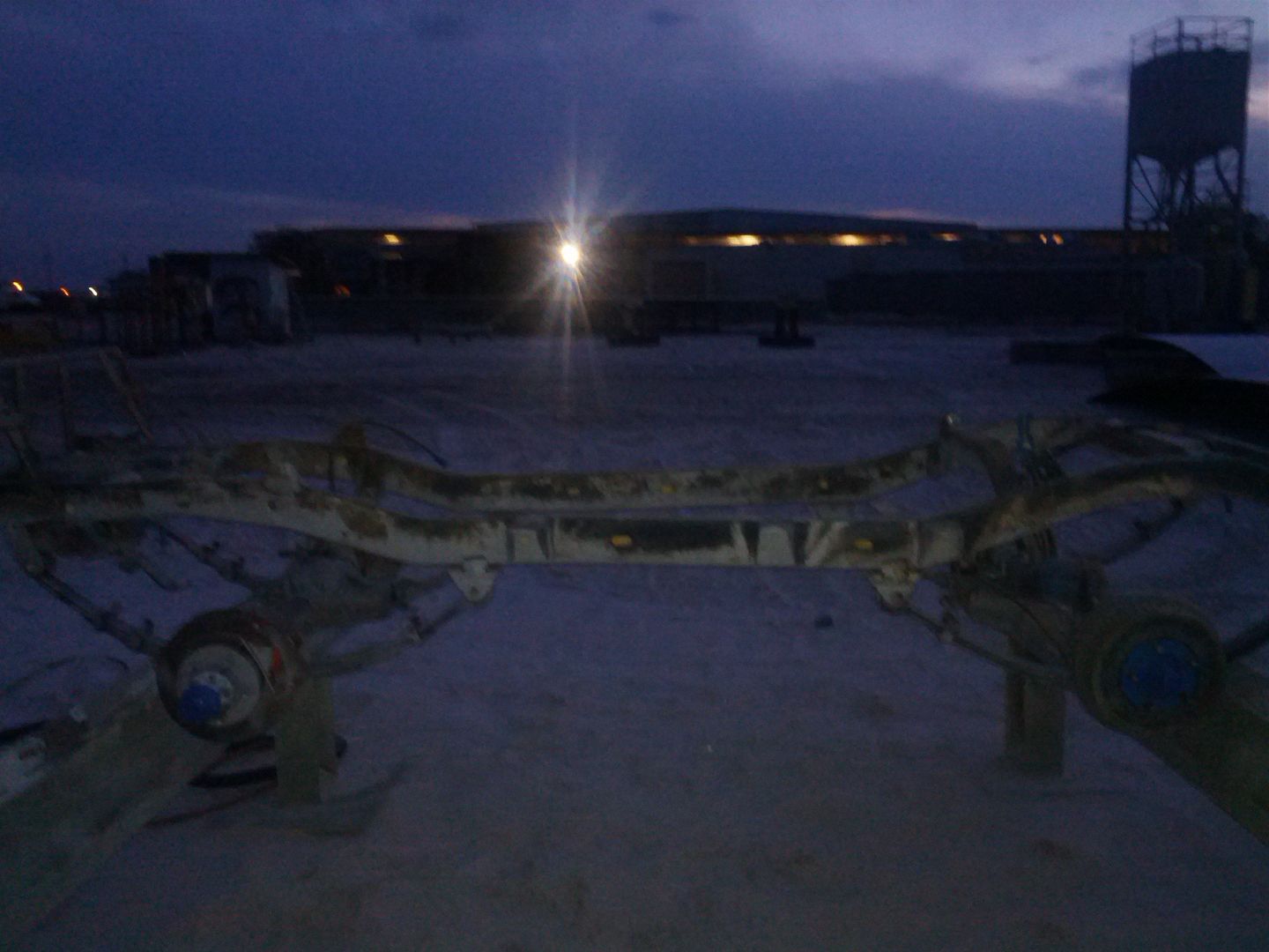

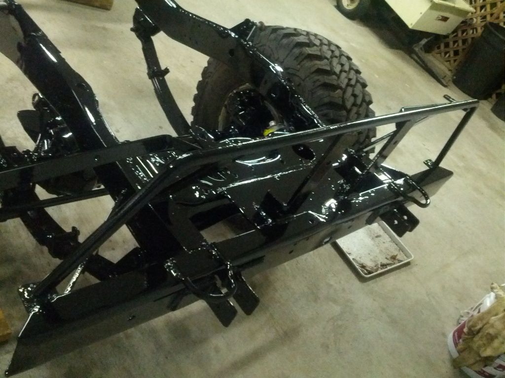

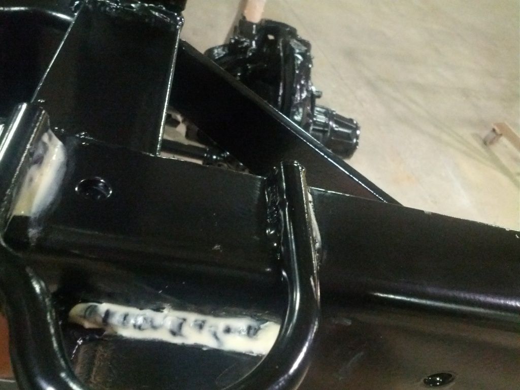

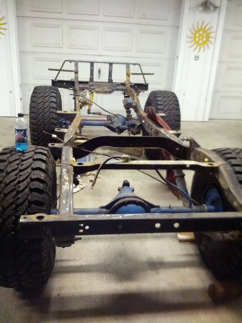

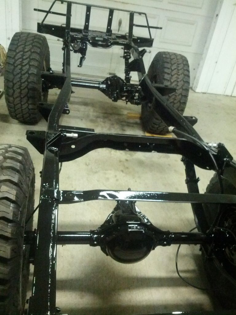

Some pics as promised...
This is the before...
This is the after shot
Griffen24 is offline

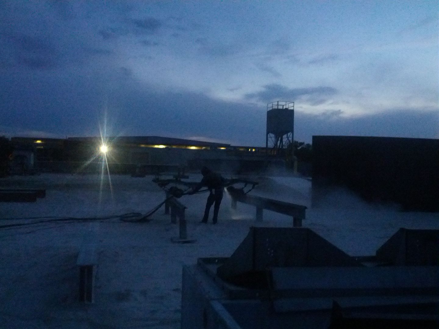

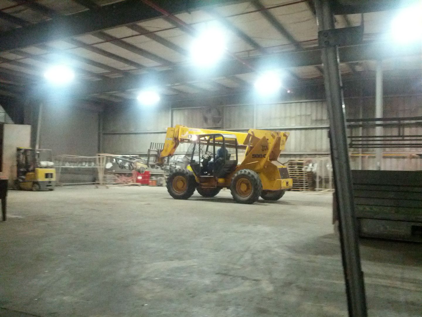

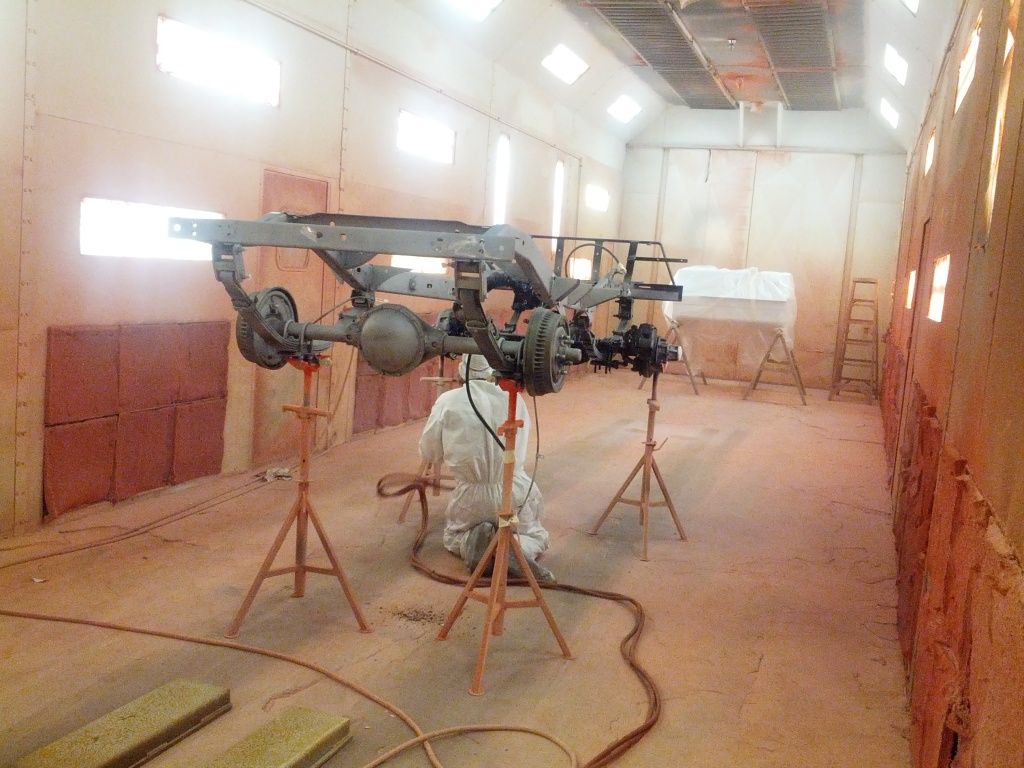

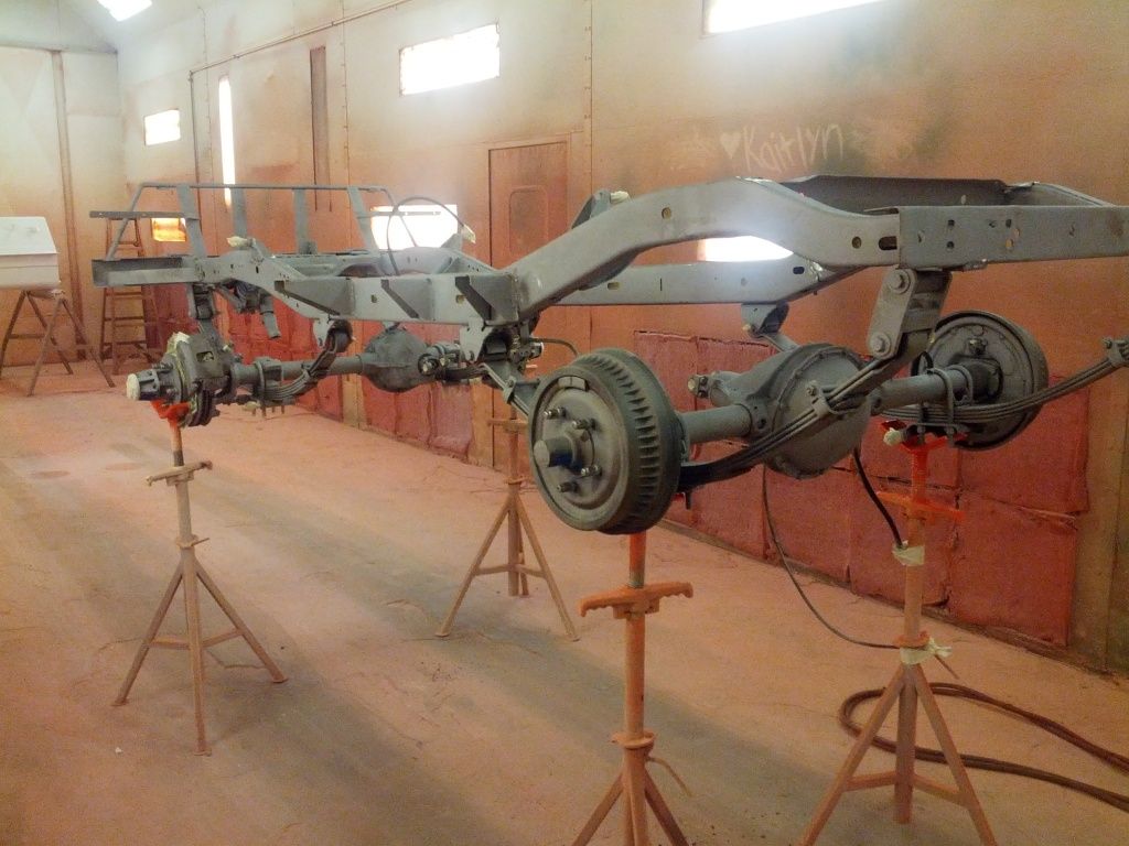

Here are some pics from my cousin's shop where he did the work and the steps we took. From late night blast in too spit and shine.
Ready to blast
Letting the sand fly

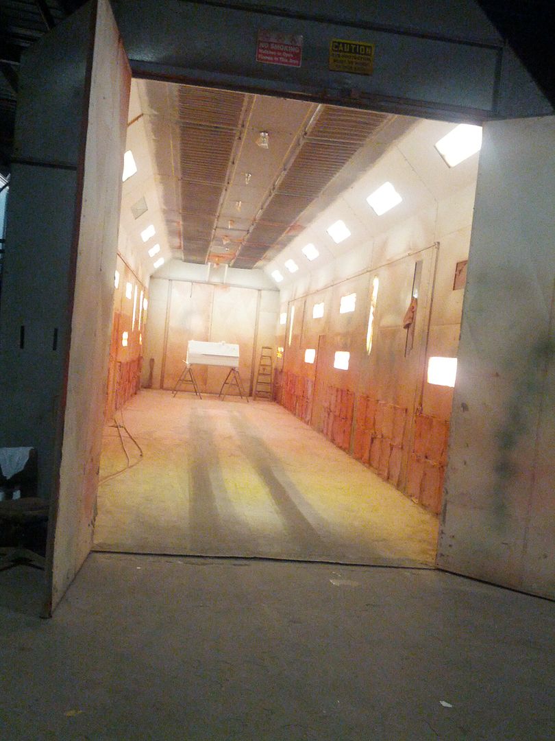

Bringing it in to the paint bay the easy way..
The paint bay / oven.
Up in place in its stripped neckad glory
Cousin Jamie working his magic.
Then puddying up some ugly weld joints prior to the final coat.
We went with enamel over powder and I am very happy with the end results, the mirror black finish just makes me all giddy inside. Now I have to get new shiny brake and fule lines for her.

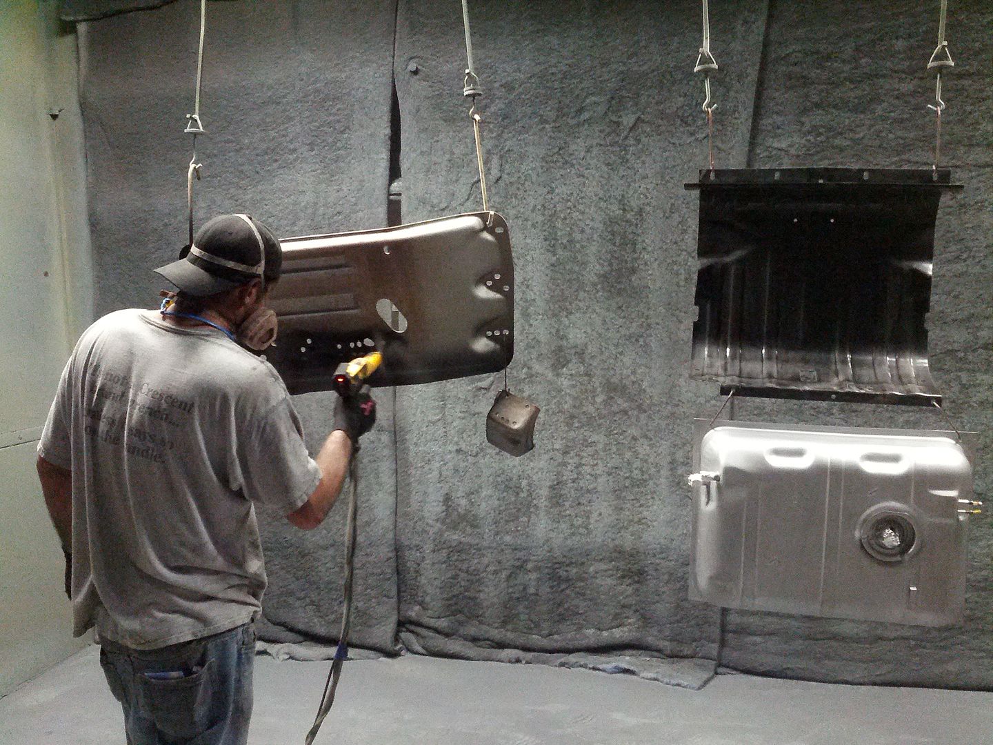

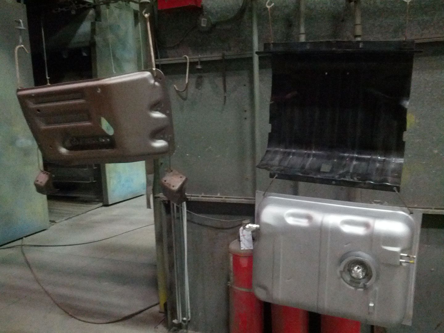

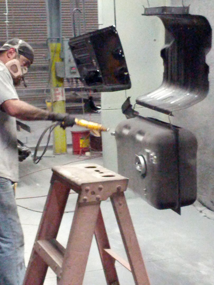

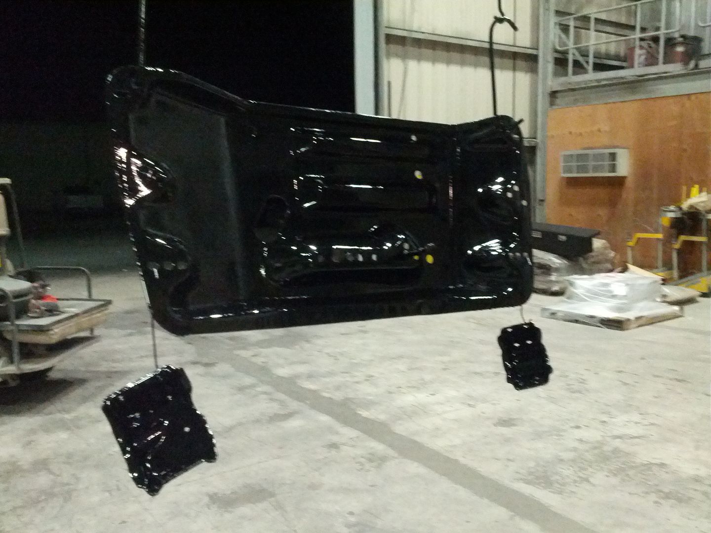

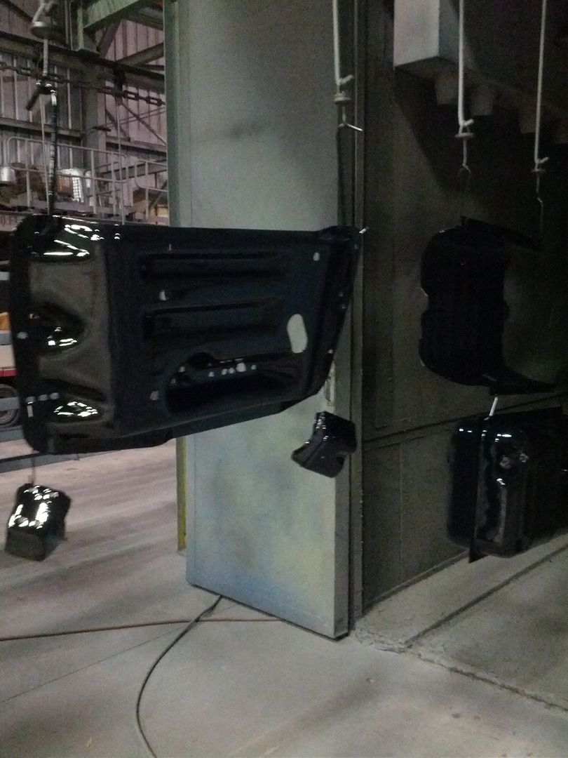

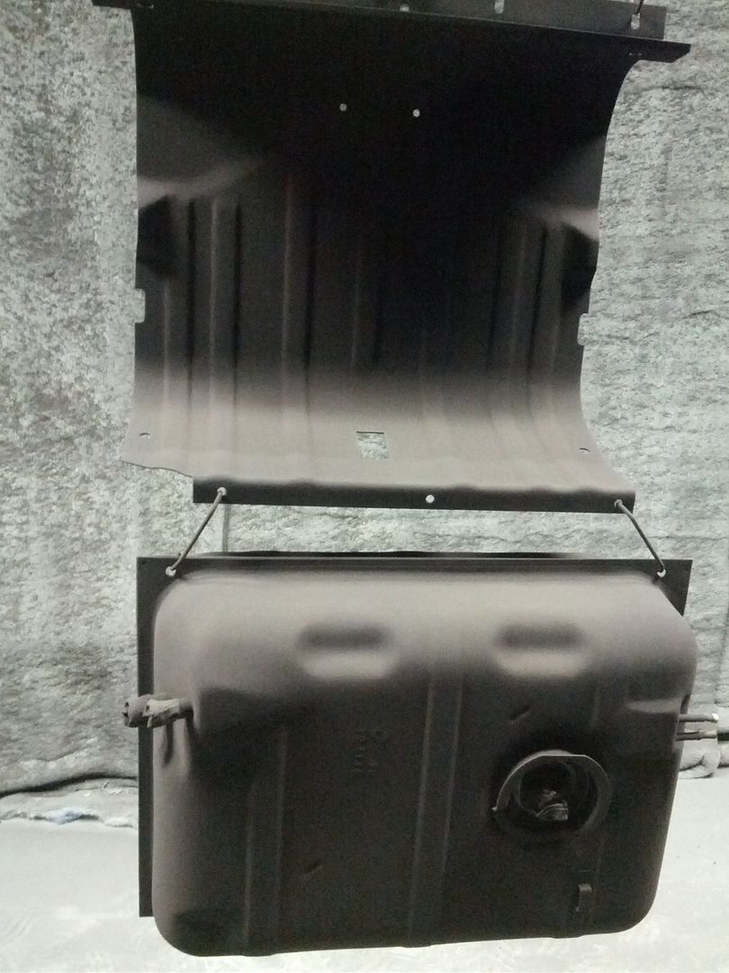

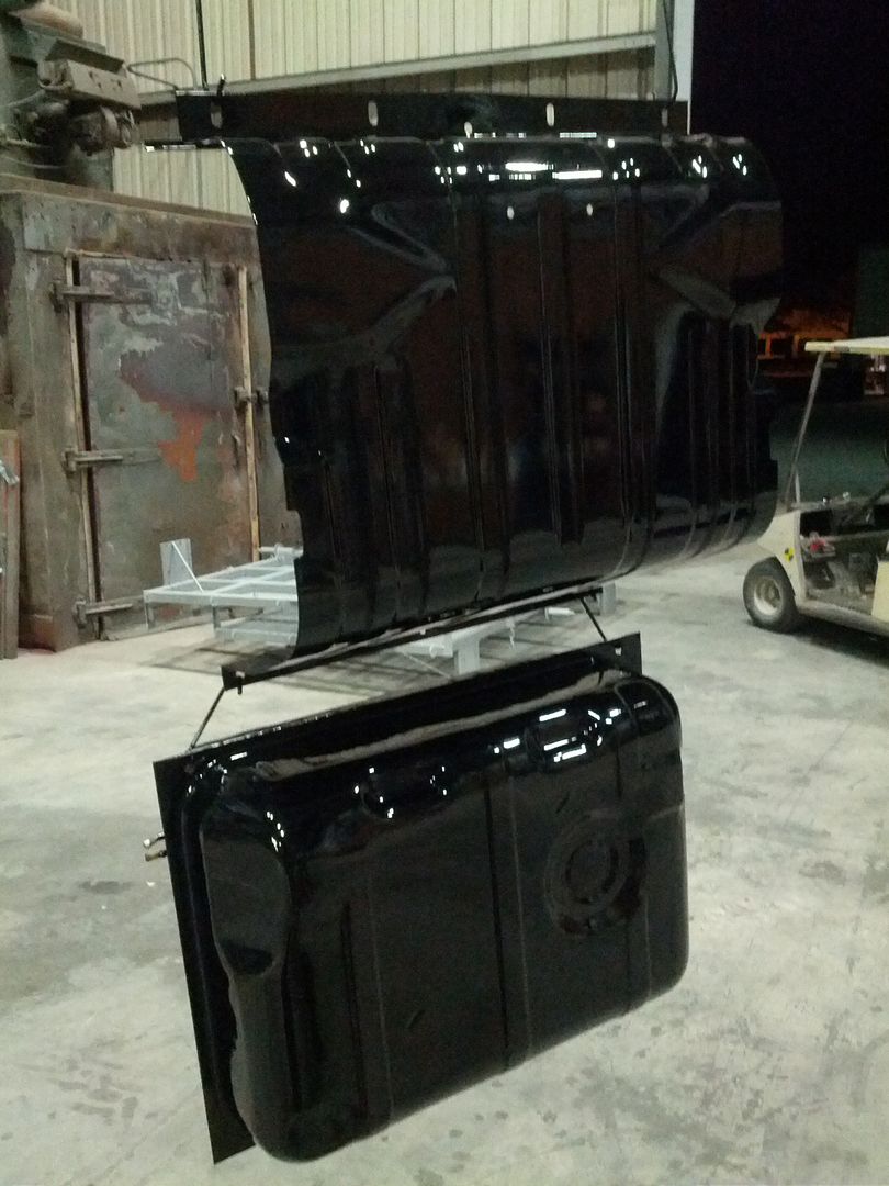

Here are the latest pic's of last nights paint works.
Got the fresh shipment from cseoffroad. New fuel tank, fuel tank skid plate, tank straps, and sending unit.

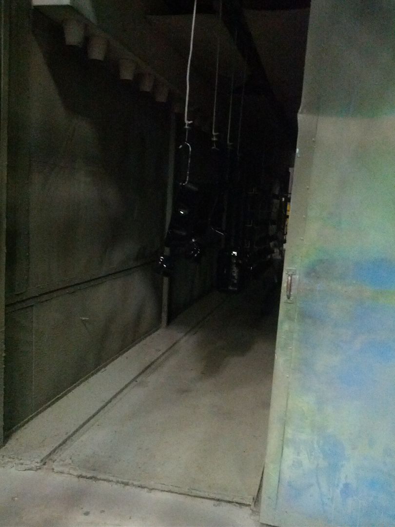

Unpackaged them, scuffed them up with scotchbrite pads, blew them off with compressed air, taped or should I say tin foiled all the part I didn't want painted. Then hung then on the powder coating conveyer chain. You'll see my tank, skid pan, tranny skid pan, and motor mounts all hung up.
Here is where Jamie works his magic.
All powdered up
Into the oven
20 min later out of the oven comes some yummy cookies
I have some stuff around the house to do right now but should be able to squeak in some jeep time this weekend. Get the tank, skids, and motor mounts installed.
