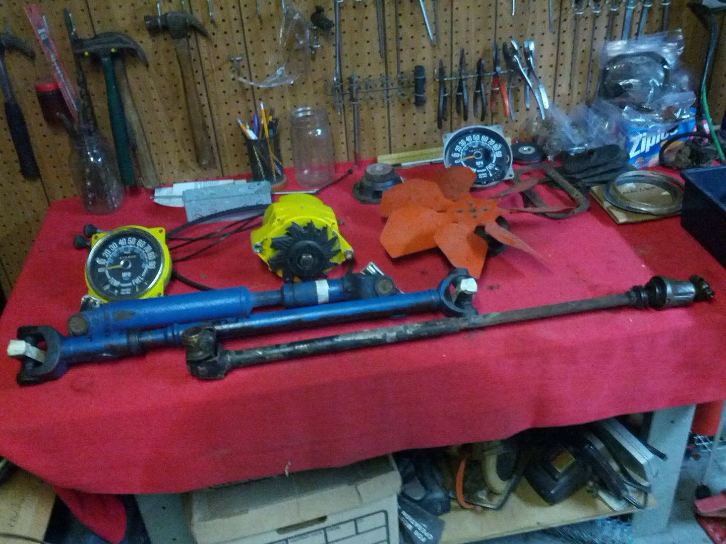

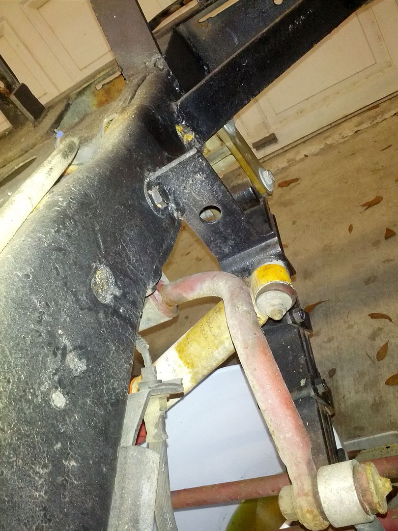

I was able to get a bit more tinkering / demo done on the five tonight. Removed both the front and Rear drive-shafts, the Lower Steering Shaft Assembly, the alternator, the Fan blade, and the power stearing pump.
My new bargain Engine Stand

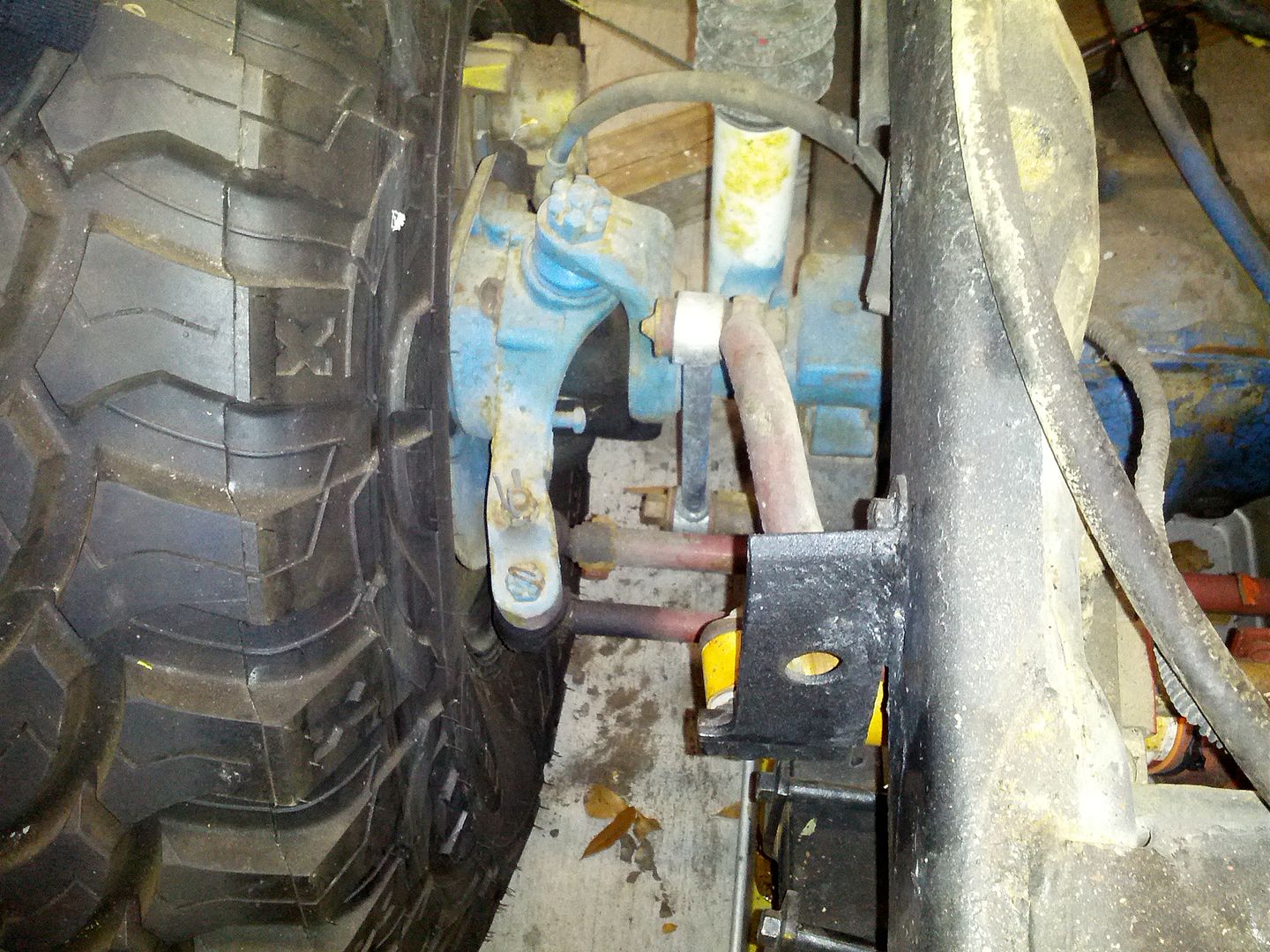

While tinkering around the engine tonight I noticed something that concerned me a little bit. On the passenger side front axle side of the frame a PO must have installed this bracket for the steering stabilizer shock to mount to. the only think is i see that it is cutting a groove into my tire there... nothing major yet but still cutting in..
Anyone else with a cj5 with steering stabilizer have the same mount here or is it normally in a different location?

I would remove that. Not good. Mine clamps around the axle tube.

That looks like a home made stabilizer that was designed like that so the PO could use a long shock absorber that he had hanging around....

Thanks guys, looks like I will be removing this bracket and buying the proper shock kit.

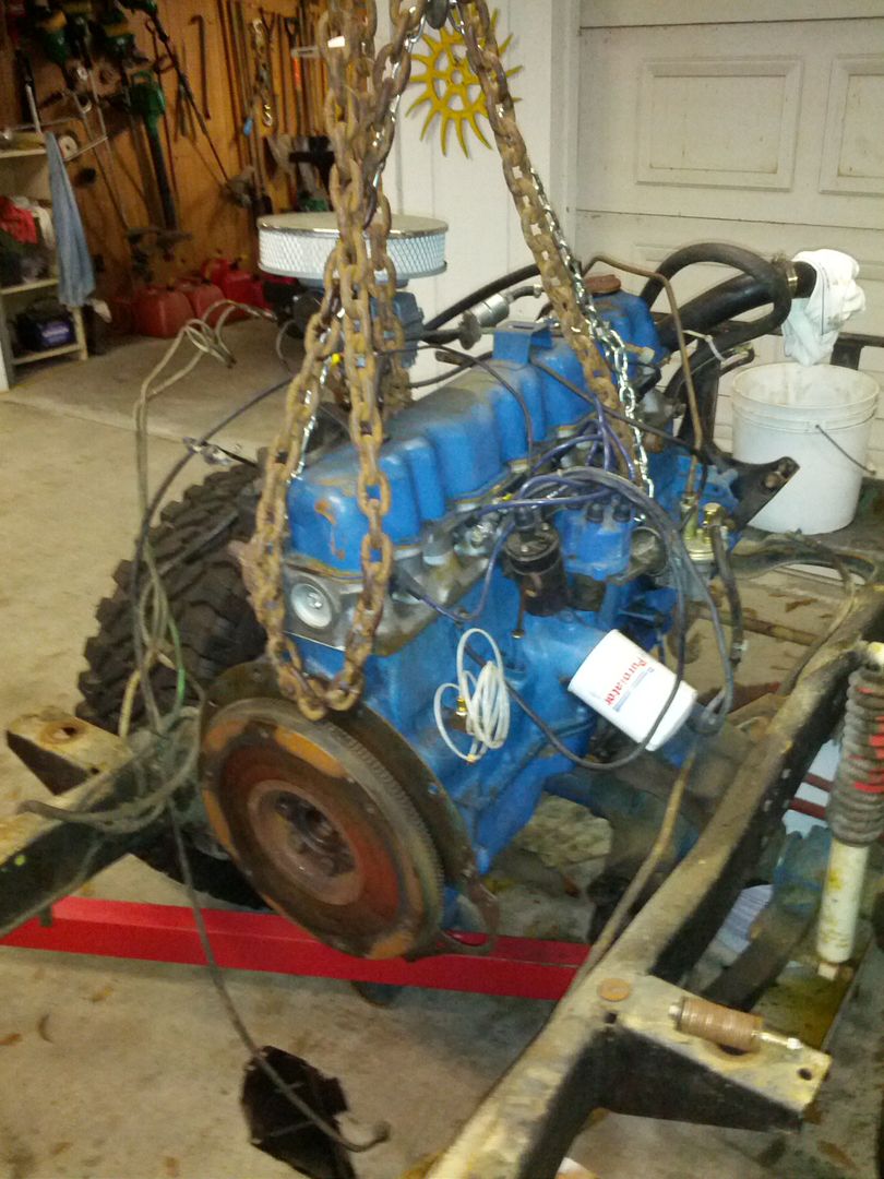

Spent the night last night pulling my engine, transmission and transfer case. Poor budget engine stand strains to hold the 258. Will post some pics later tonight. Looks like I will need a new gear ring for the fly wheel, current one has quite a few chewed up teeth. Pulled the tranny and xfer case together and was barely able to lift them... Didn't want to sperate and drain them. Was hoping to only give them good cleaning, we shall see once cleaned and I take as peek inside. Now I am trying to figure out how to get all that remains off the frame so I can send it in for new power coating.

I didn't separate my tranny and Tcase either, but it was a 2-man job to move/lift them. We degreased and painted them up, and they came out looking good. There is some good info about changing out the gear on your flywheel that will make it easier. IIRC, you need to count the teeth and be sure you get the same one. Maybe someone will remember where the thread is with the pics on changing the gear. It invloves putting the flywheel in the freezer.

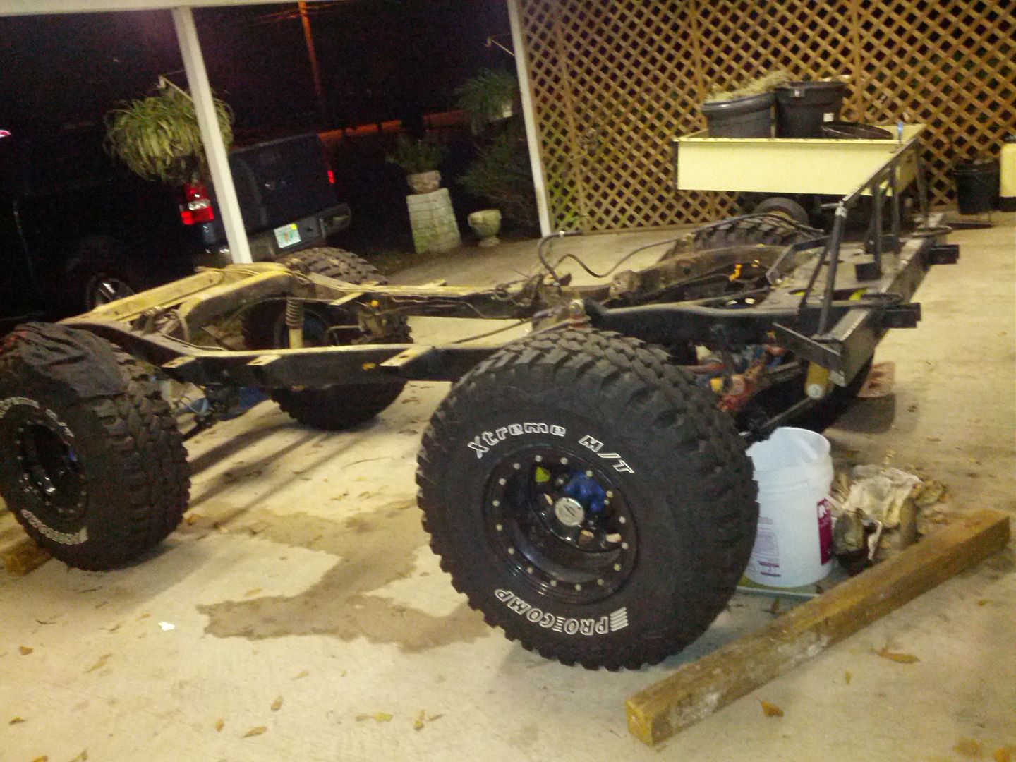

post #37 of 140 Old 12-20-2012, 10:28 PM Thread Starter
Griffen24
1979 CJ5
Location: Lakeland
Posts: 114

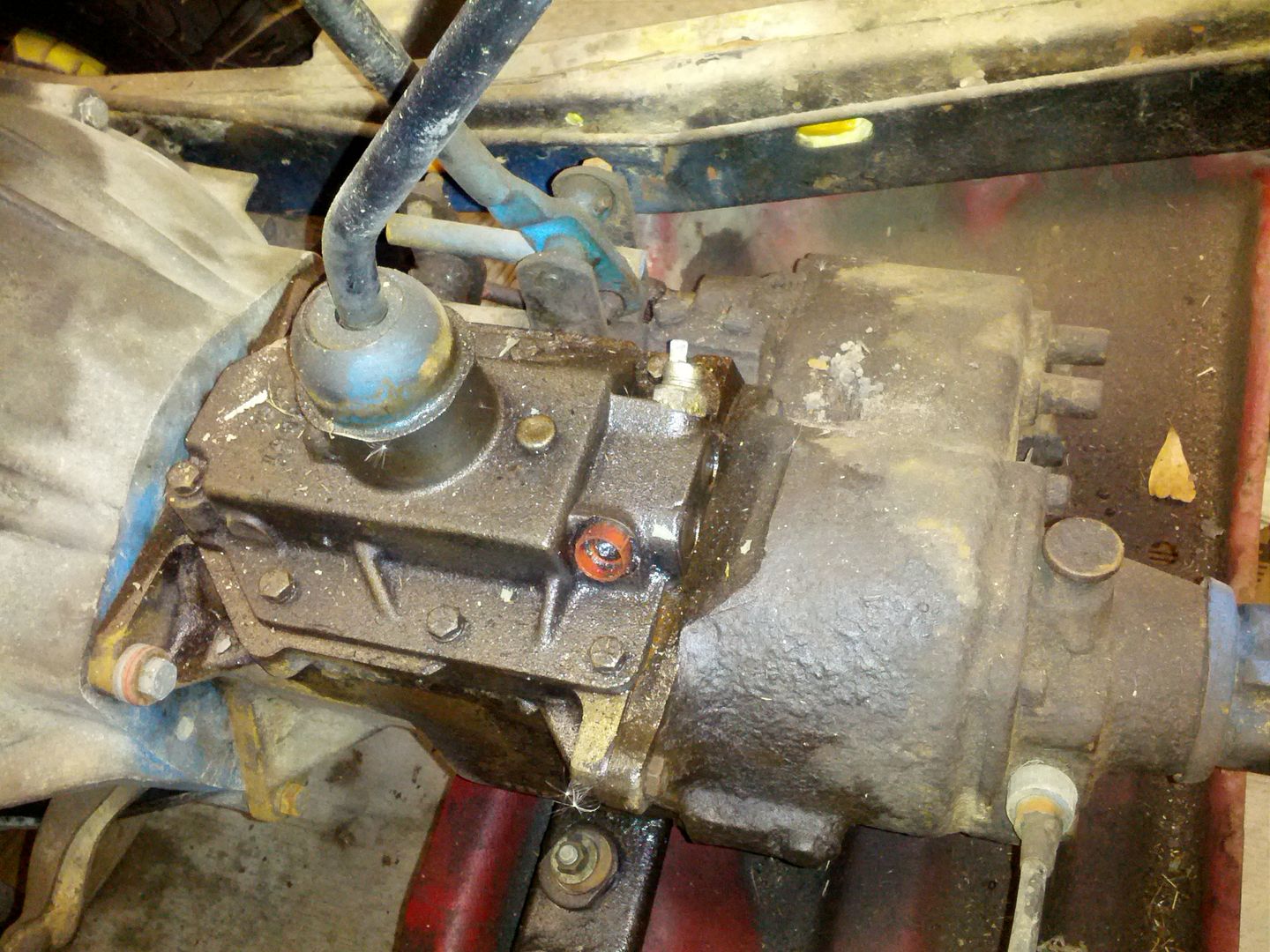

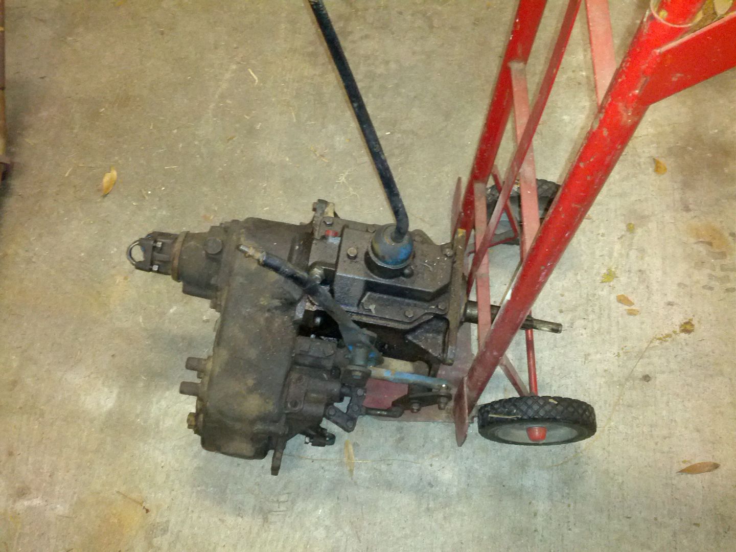

Here are the pictures as promised.
Engine on the lift, I used two chains just to be on the safe side.
Got the T150 and the Dana 20 out, boy are these guys grungy. That little dolly was creaking and groaning under the weight of this but it saved the back some strain.
and whoala... a new cleaned off frame... still have a few days of work ahead of me but shouldn't be to bad.... right?
And here the 258 will rest untill the fame comes back from a good blasting and paint job.

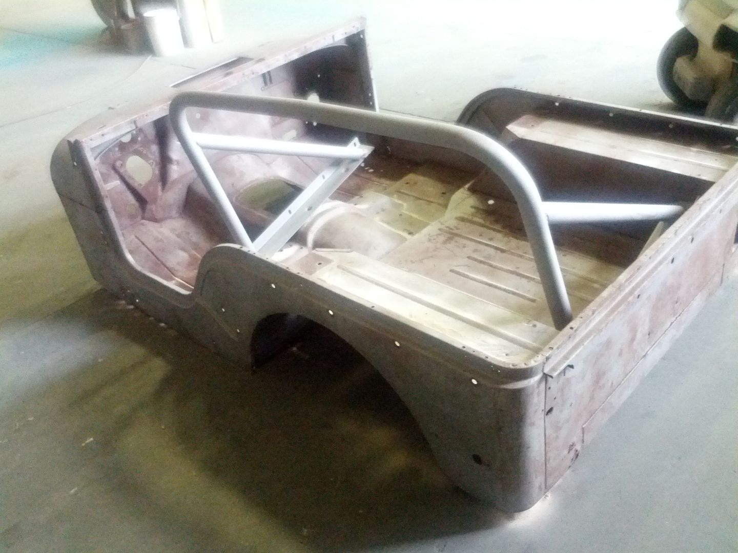

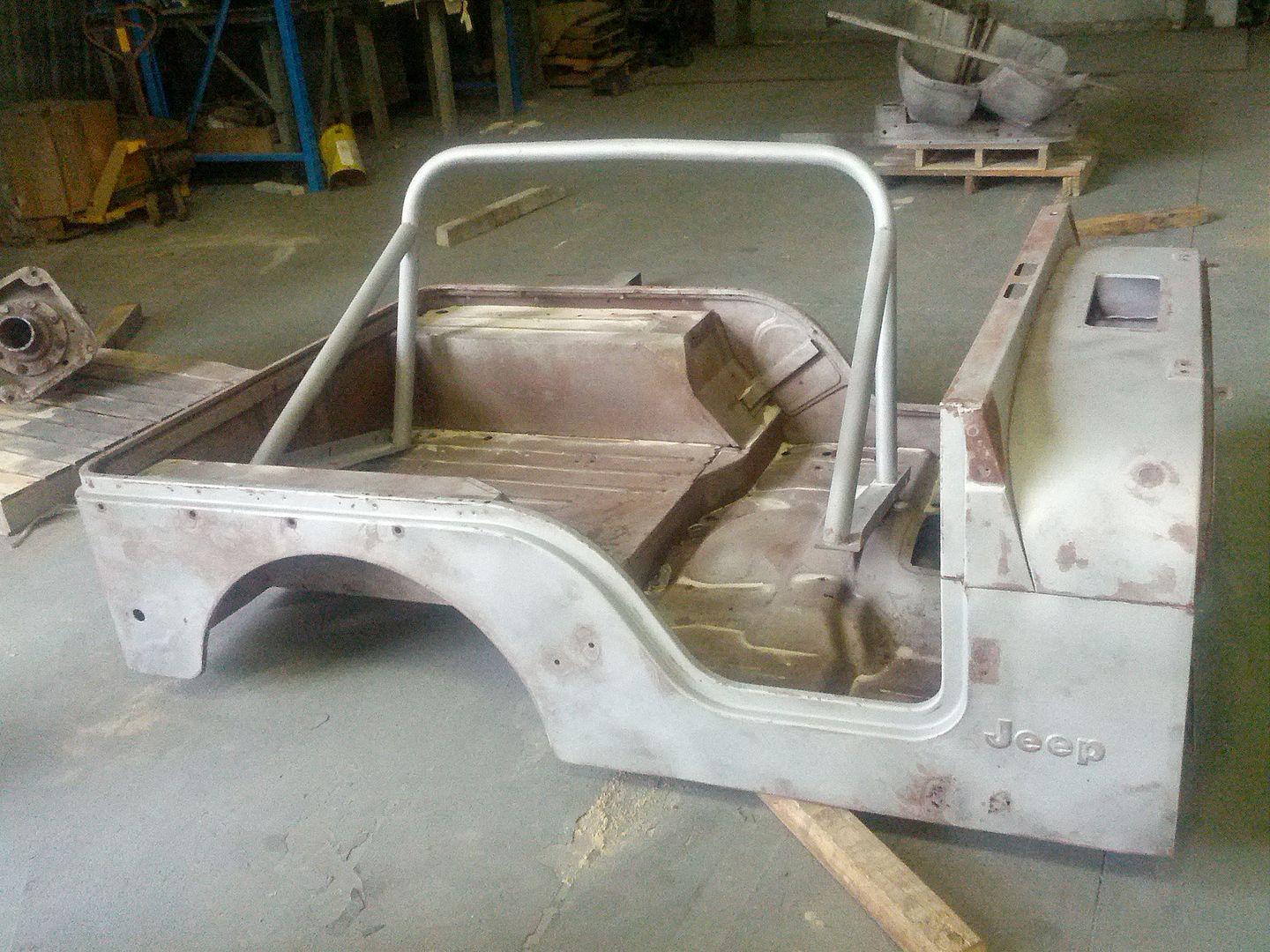

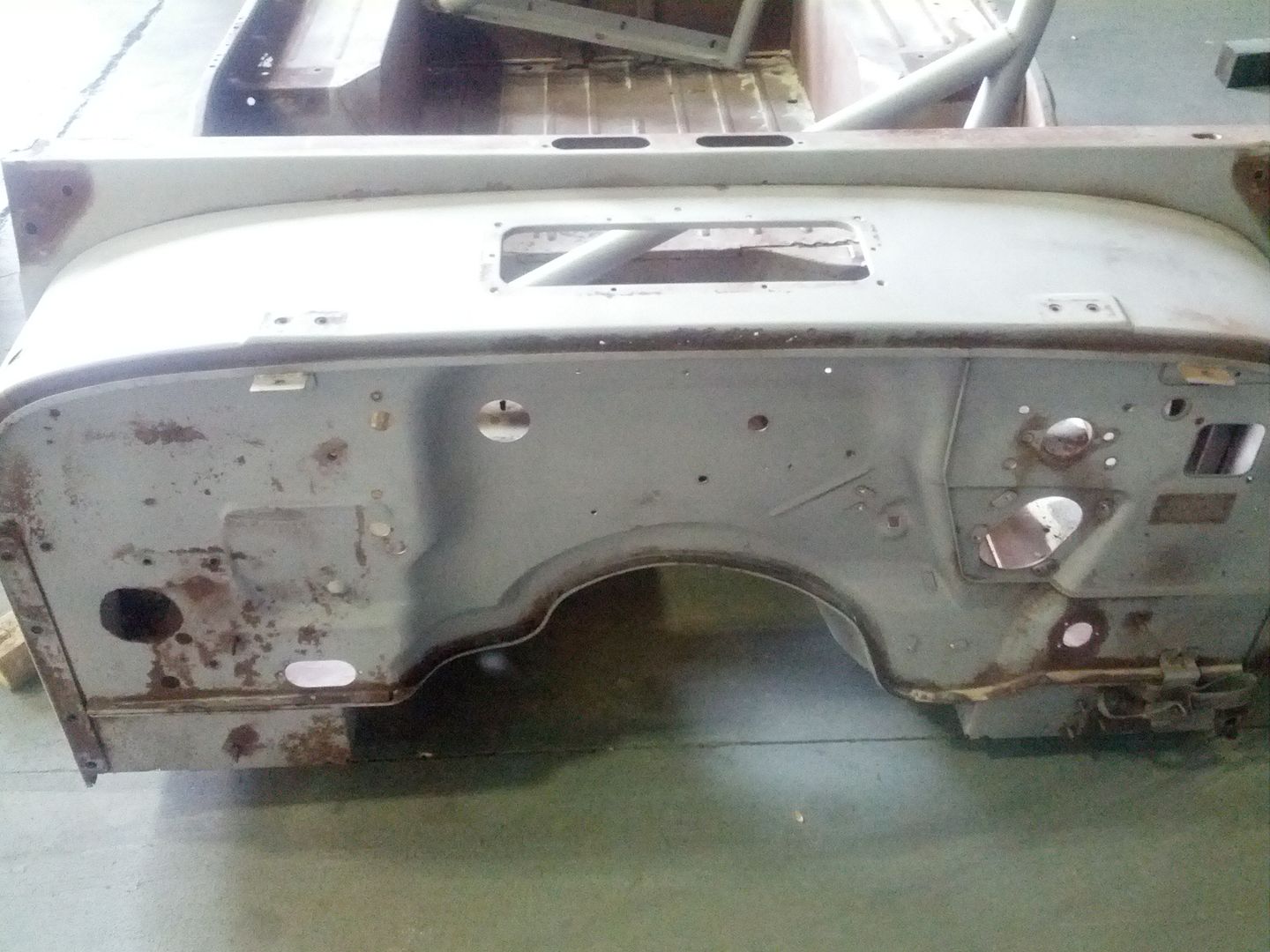

Also when by my cousins paint shop and checked out what my tub looks like neckad (baked and dusted) I an very pleased. looks like i will be able to get by with must less metal body work than expected. And My cousin will be handling the body work for me. Though i will try my best to be then when he is working on it so I can learn for any future projects. but take a looksy. It's showing some surface flash on it but will be dusted again and primed for work just needed to take a gander at her in the buff to decide if i was going to use her or replace with fiberglass. definitely going with this tub now. my poor dash panel suffered some collateral damage and was bent, hoping to be able to bend her back out and the hood was no where to be seen. I'm sure it will show up.
