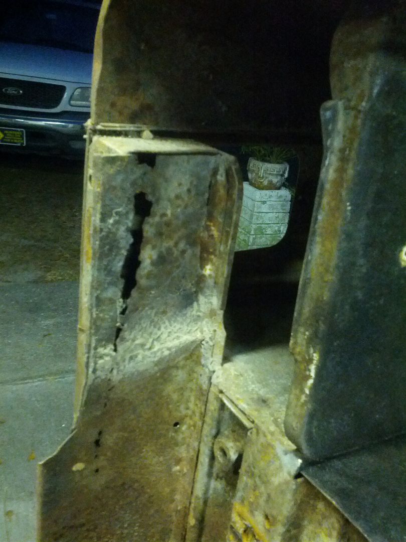

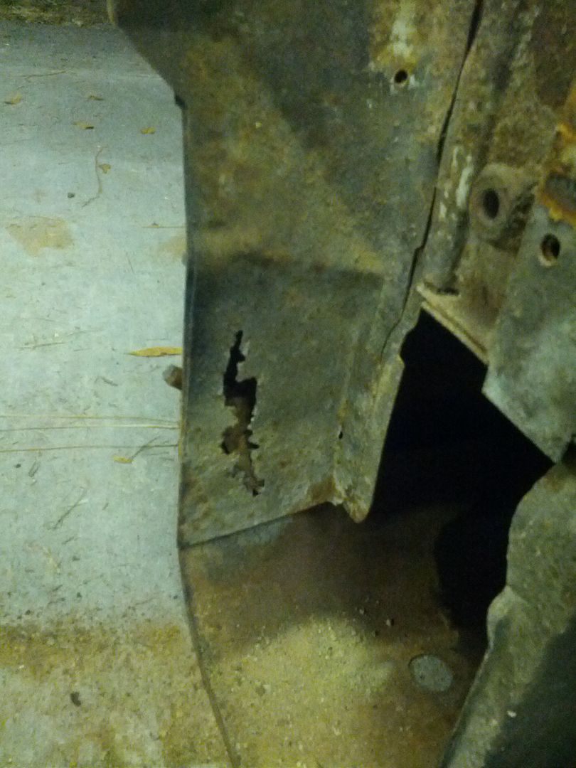

Looks like I will need to rebuild the rear body mounts. Anyone know of any good threads out there on how to fab these. Looking for any ideas.

Post up some pics of what you're looking at. Making them is not hard. It is very straightforward. Or you can buy premade mounts, or you can have a welding shop make them. Depends completely on the budget.

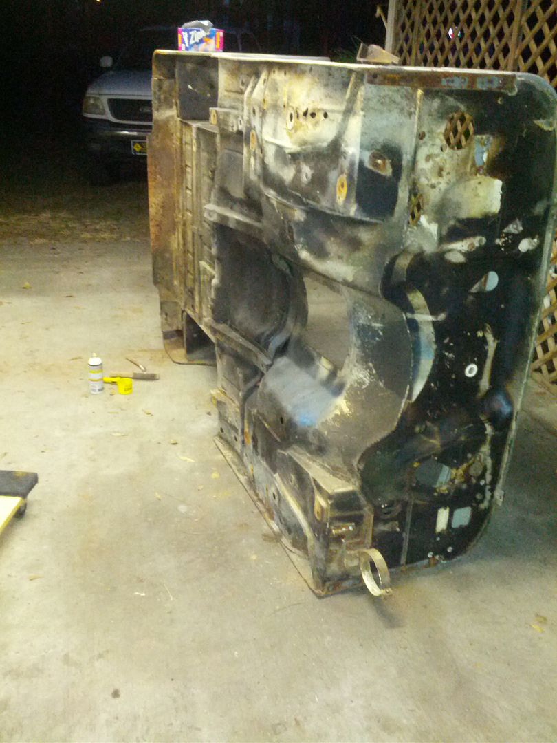

Got some more progress made tonight. Body Of and loaded up with the fenders, hood, and grill for some tlc from the bake and blast.

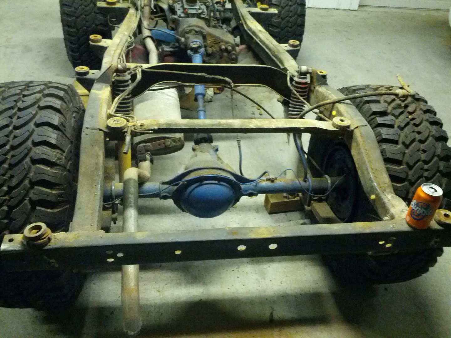

I very happy to confirm the frame in very good condition. only very minor surface rust looks like someone filled the frame with the spray can foam at one time. better than mud in there I guess.
Here are some pics of the rot around the rear body mounts, both nuts are spinning free has anyone fixed this and have a thread I can look over?

I'm no help with this... you're ahead of me! I think I would cut out the rotting metal, giving you access to the nuts, fix any bad metal/weld in new nut, weld in repair patch.

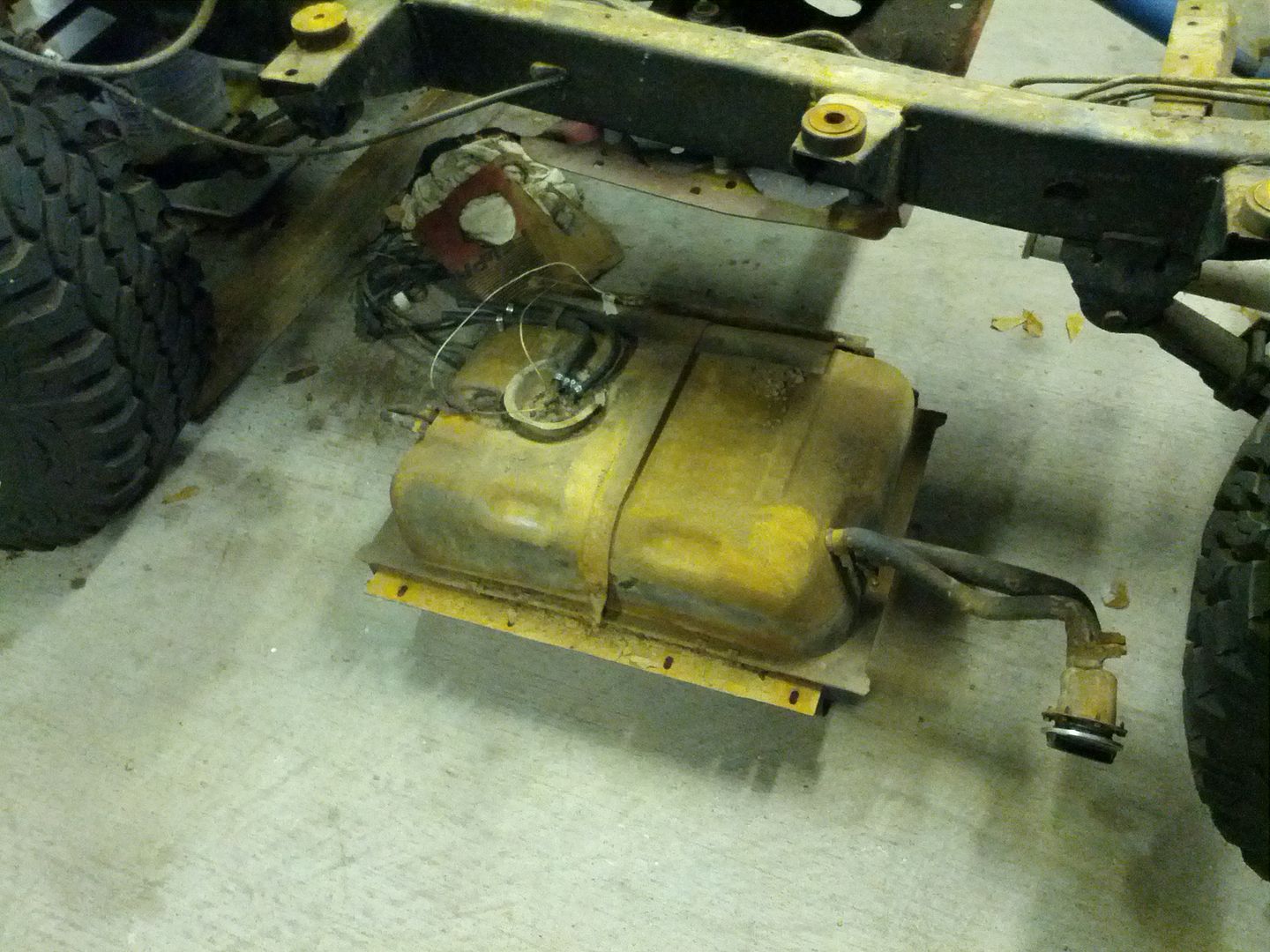

Removed the fuel tank

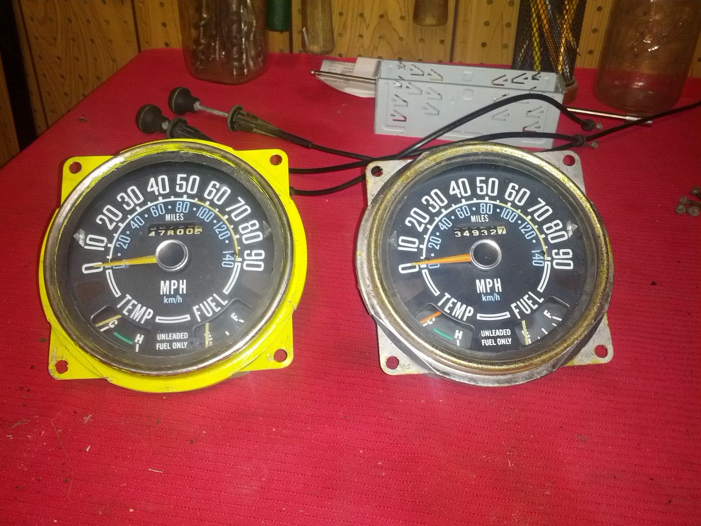

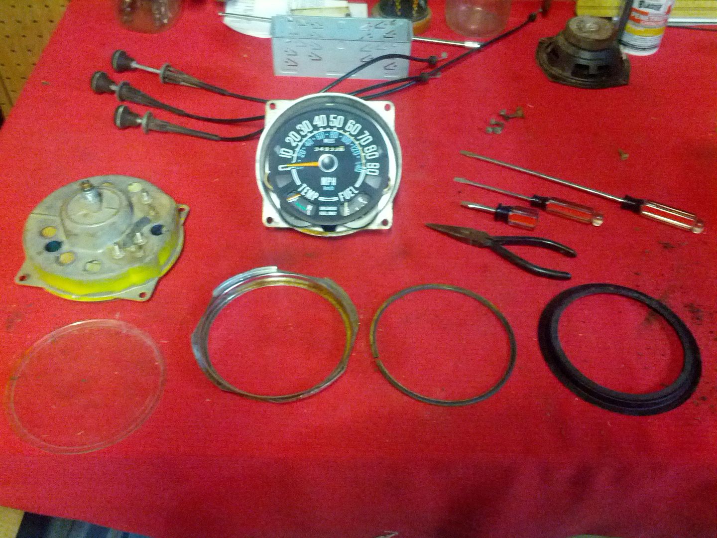

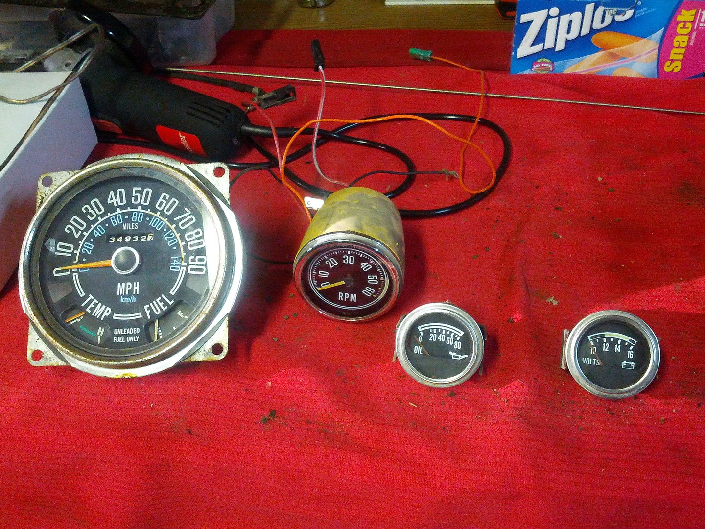

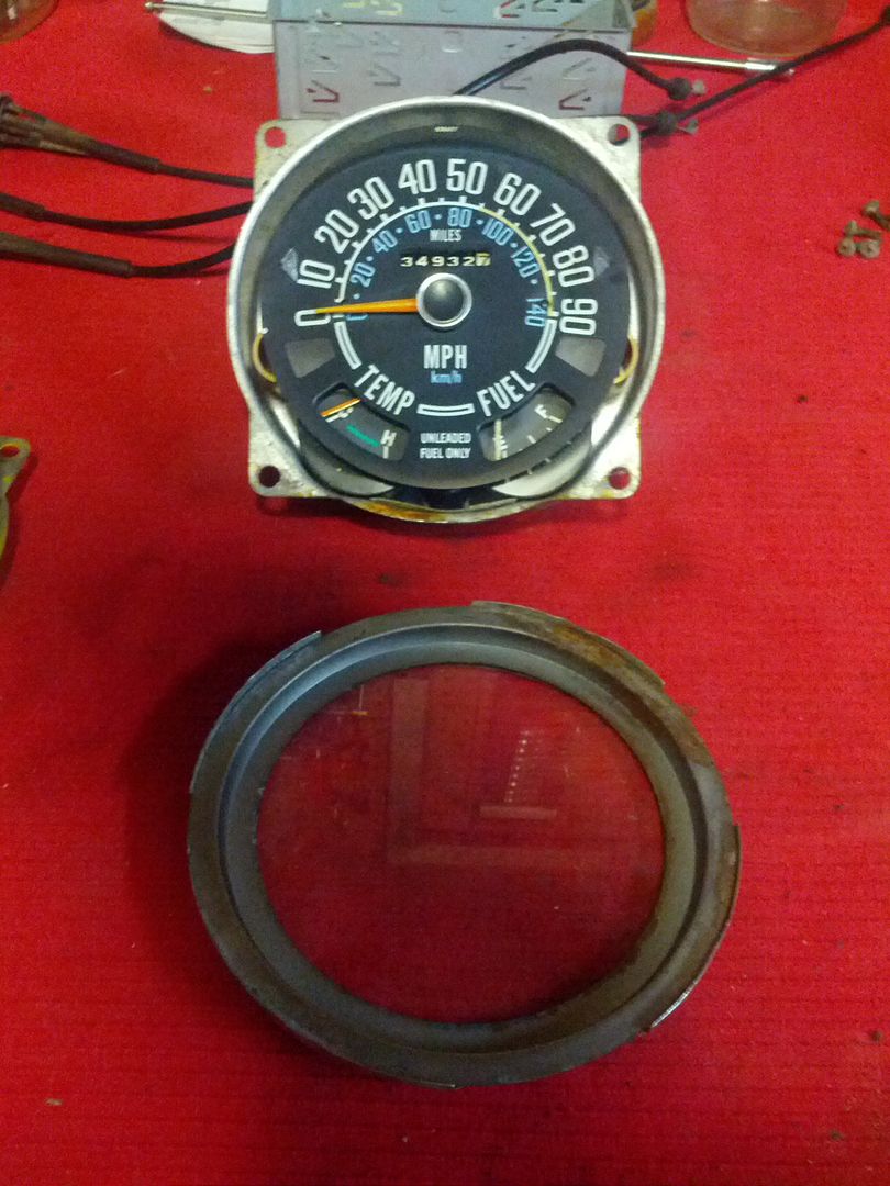

I also started disassembling mi speedo for restoration. I happen to have two of them and some other spare dash components from a justed out parts cj7 i picked up a while back just to practice on.
looks like some whiteish power build up on the speedo face plate and the needles were almost mildewed off color so i will be cleaning them and touching up the needles with fresh color.

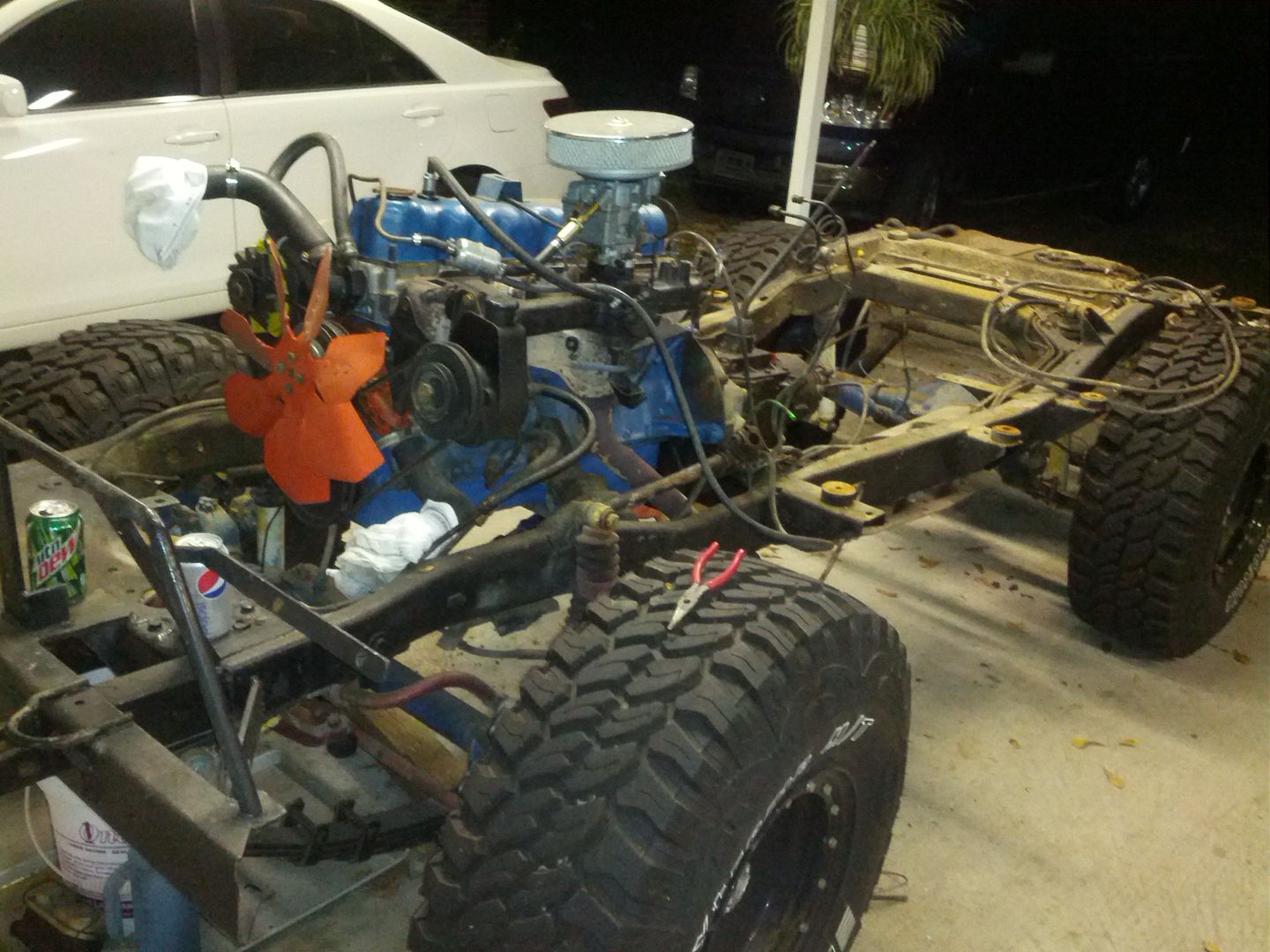

Picked up a cheepo engine stand off of craigslist tonight for $20. so this weekend goal will be to get the 258 ready for removal. Open for any tips on this part. I think i will be replacing the clutch while i have the motor out. (better now than once its all back together). Is there anything else suggested I do to the motor while I have her out in the buff? No mechanical concerns as shes running strong with no leaks, smoke, or abnormal sounds other than a whistling somewhere in the intake. PO states a recent top end job was done on it and i have noticed the head looks newer and the freeze plugs are like brans new and shiny on it. But anything I can do now to save me later, I'd prefer to do it. I will be doing a verry good detail cleaning of the 258 while shes out.
Any suggestions on where to hook up to the 258 for hoisting, should i be removing any of the acc's (carb, alt, PS pump, etc) or will they be fine?
Guess i will also be detaching the drive shafts so the tranny and xfer case can be removed also.

First thing... MAKE SURE your cheapo engine stand will hold up your engine. If the PO stressed it, or treated it wrong, I would be concerned. Maybe it is a moot point, but I know the very first time I bolted an engine to a stand I was a little worried about all that weight hanging on those small plates and bolts.
When I pulled our 258 and T18/D20, all together, I used a bell housing bolt and an exhaust manifold bolt, diagonal from each other. The manifold bolt is a 3/8. Get a longish one. I would remove accessories as much as possible. It's too easy for the chain to shift and swipe a power steering pump off the bracket, then you'll be mad at yourself!
Our engine ran well when we pulled it, so we didn't do any engine work. We just cleaned and painted. Some guys like to go into the oil pump and replace it as a maintenance item.
Yep, drop your DS. Pull them out and paint them too.
