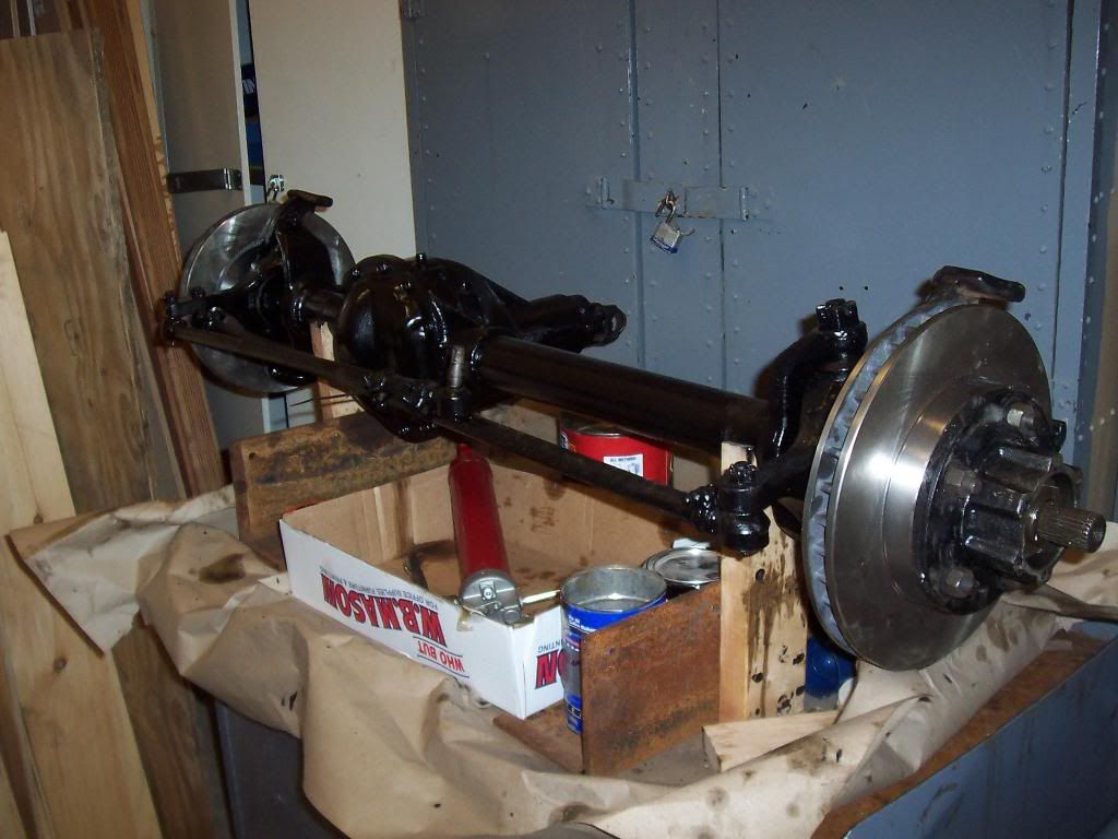

The Dana 27 axle will be fine with disk brakes and mild wheeling, the upgrade is easy. I got the Caliper brackets from a 78 cj7 and used the calipers as cores for rebuilts, ordered new rotors.
same set up works on the D30 as I did it a second time on the current build.
As for the dust sheild - I ditched it on both builds as I feel it just is a dirt / mud collector.
can't find pics of the D27 converted ( I can snap one when i get out in to the parking lot if ya want) - but other than the closed knuckel, they look similar to the D30
MikeMCJ posted this - but it is the process. http://www.earlycj5.com/tech/brakes/...conversion.php
NAPA has Caliper kits that come with pads and hardware and the 1 1/8 in rotors that are necessary. The longer studs for the lugs can be grabbed off the donor, now is a good time to swap out the bolts for studs holding on the caliper bracket. Makes for a stronger install.
D30 converted wating for the calipers
